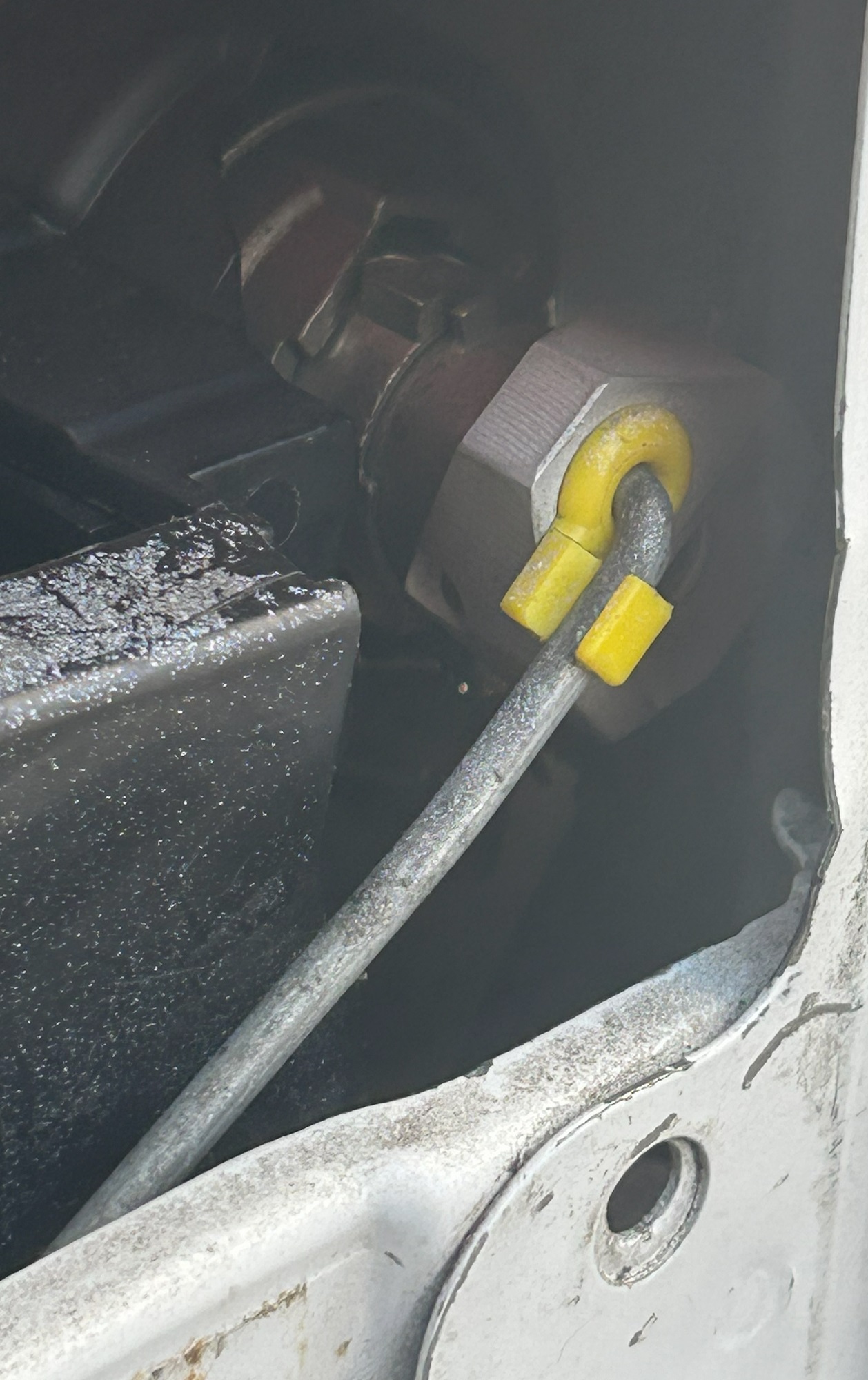

    I recently had my van broken into with the lock being damaged. Not to much of an issue to get a replacement and not that expensive. However there was a plastic push rod connector that was also broken that connects the central locking. When looking to purchase the £5 item (this is the price I had in my head ) I was shocked to find this small piece of plastic costing £60 plus.

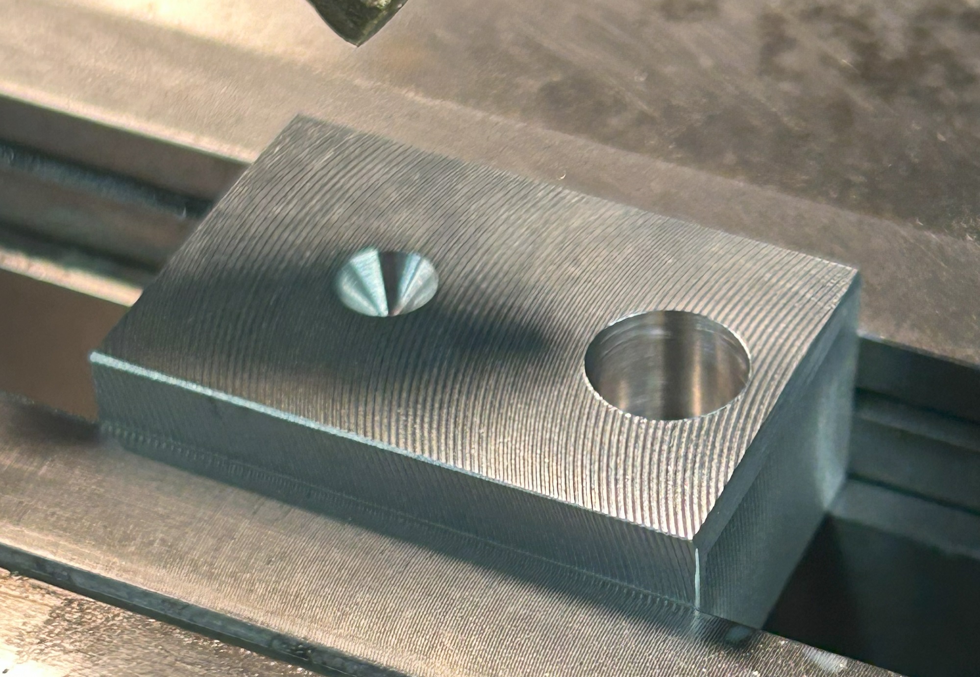

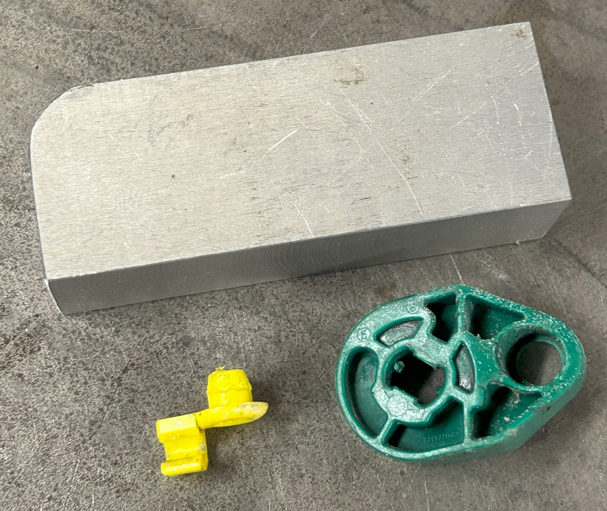

    So decided to make one from a piece of scrap aluminium I had lying about in the workshop.

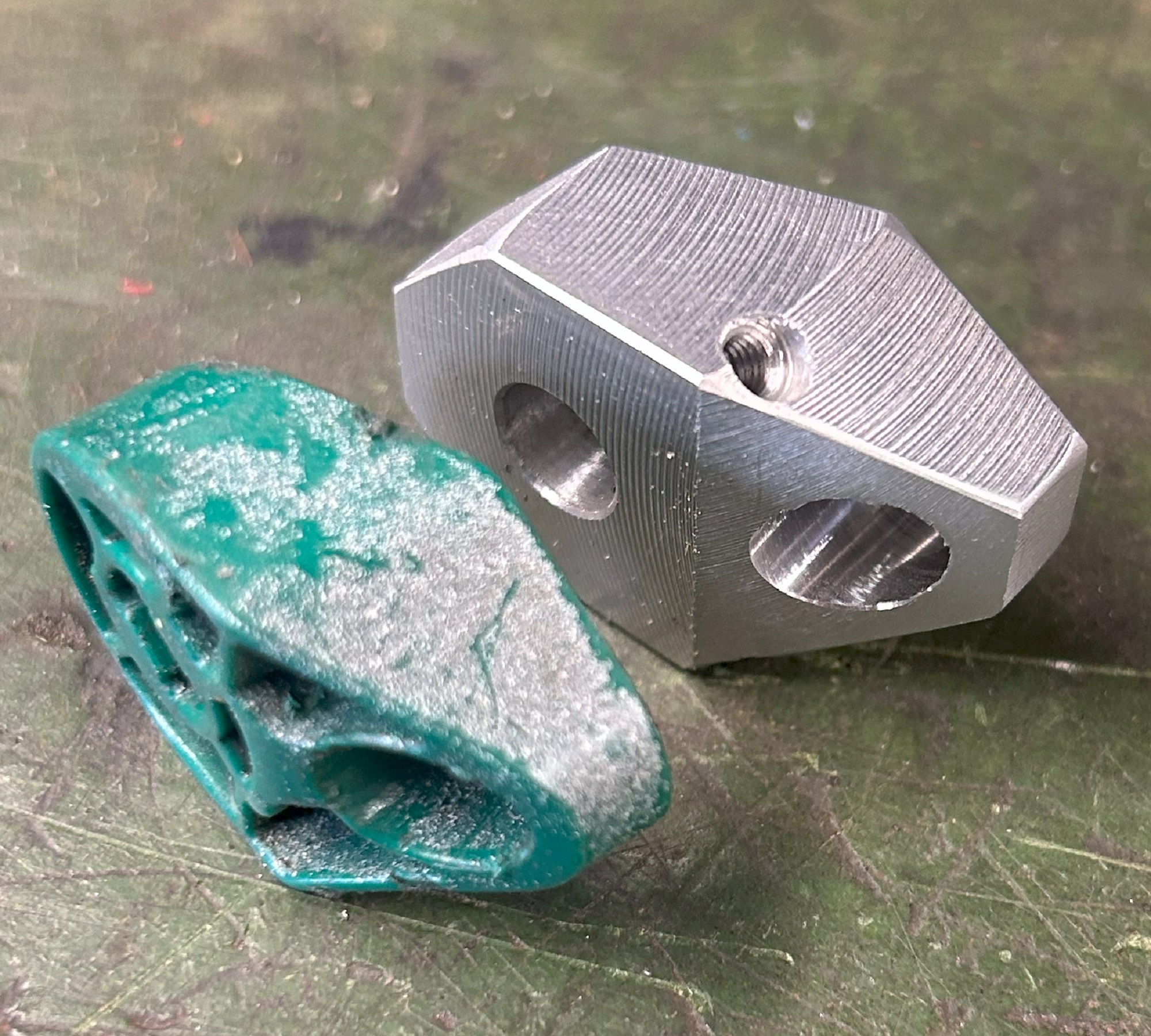

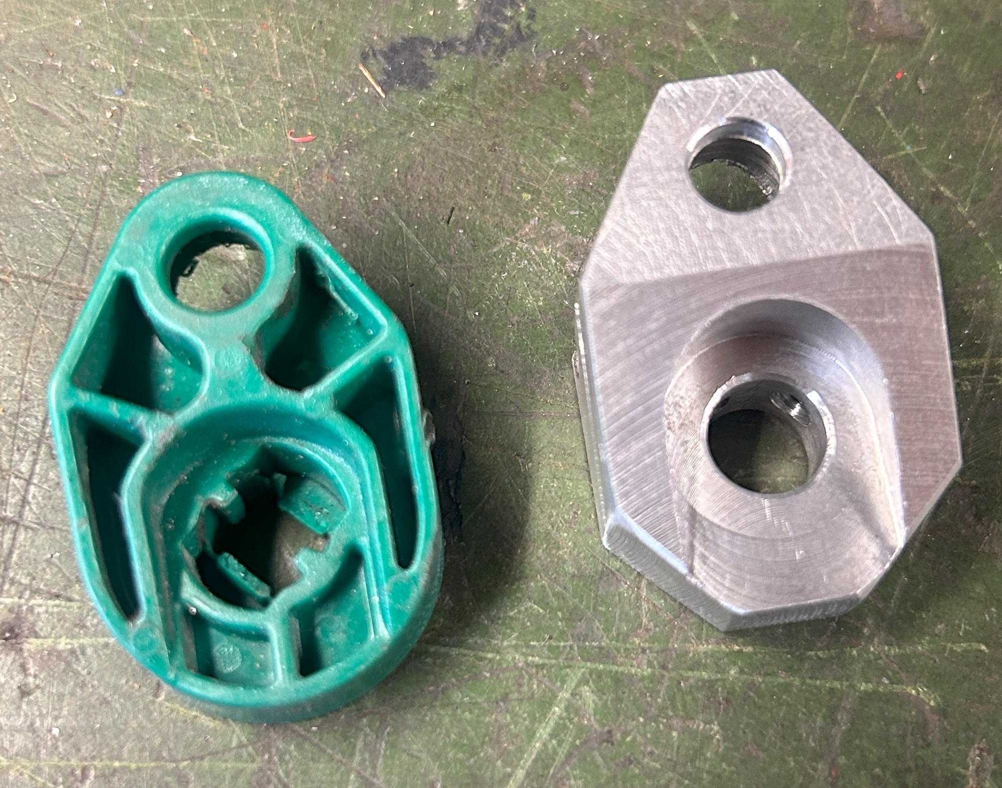

    There is nothing complicated about the push rod link apart from the moulded hole to attach it the the barrel lock. As i was going to secure with a grub screw I just drilled a hole and positioned the grub screw in the correct orientation to lock on the barrel end. An hour and half later push rod link was finished and fitted.
    Even if I do say it myself I think this is a much better repair than the 'not so cheap' plastic lever.
    The photos below show the old push rod link and the new aluminium replacement.
    expensive piece of plastic-block.jpgScrap piece of aluminium with the original lever
    expensive piece of plastic-milling.jpgMilling and drilling.
    expensive piece of plastic-ready.jpg expensive piece of plastic-ready-2.jpg Aluminium lever.
    I didn't bother with the radius on each end as there was plenty of clearance so the lever wouldn't foul on anything.
    expensive piece of plastic-finised.jpgFitted to van and works as it should on the new barrel lock
