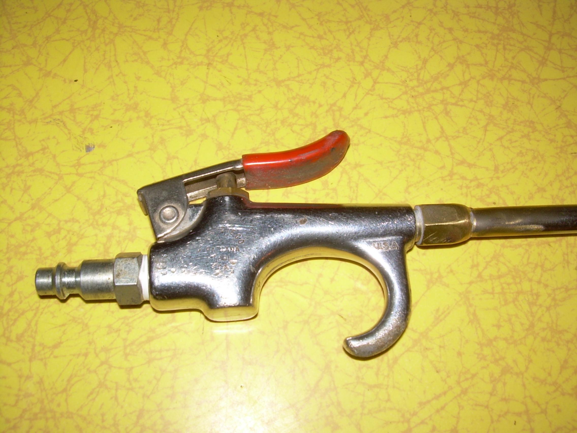

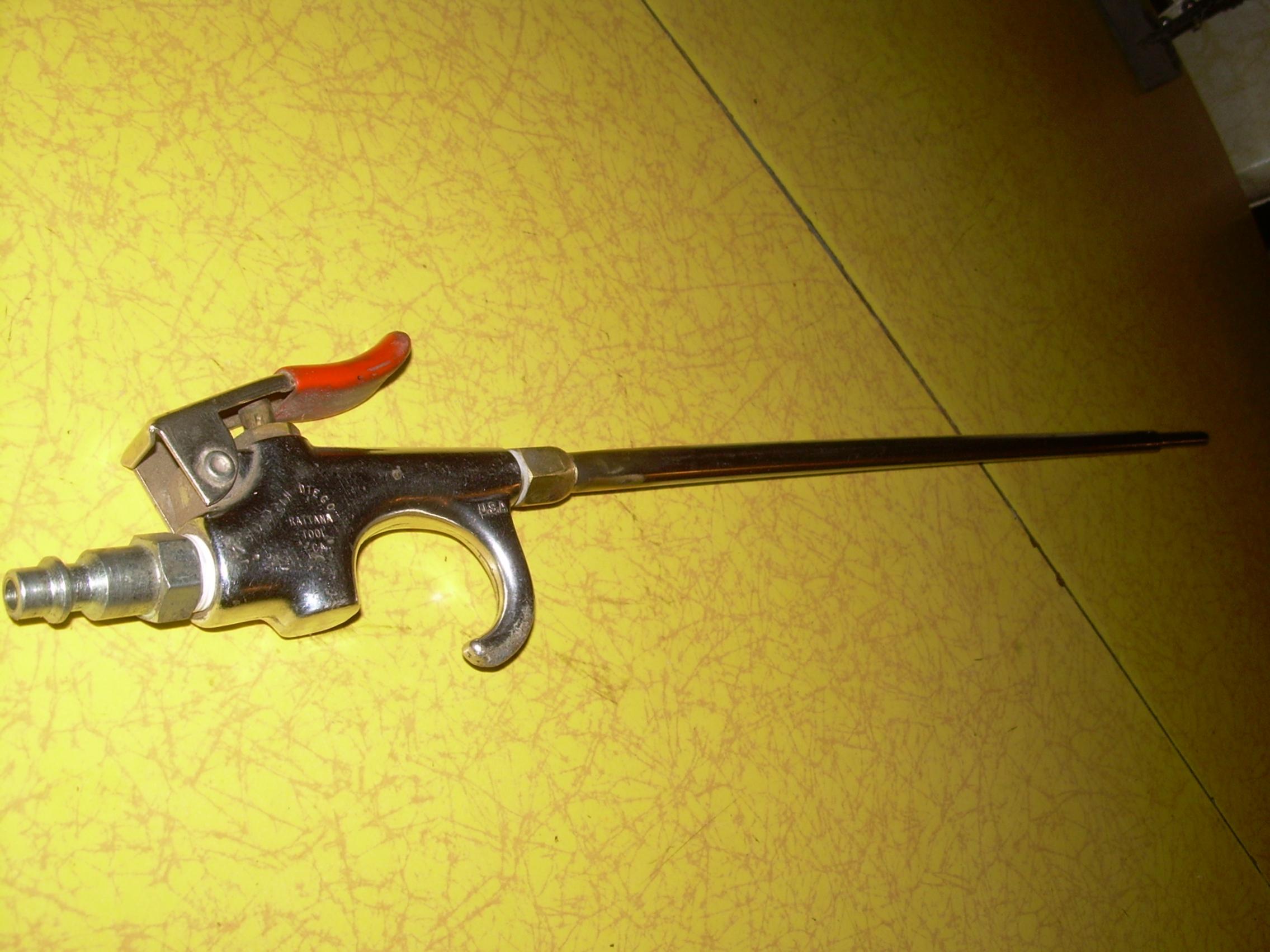

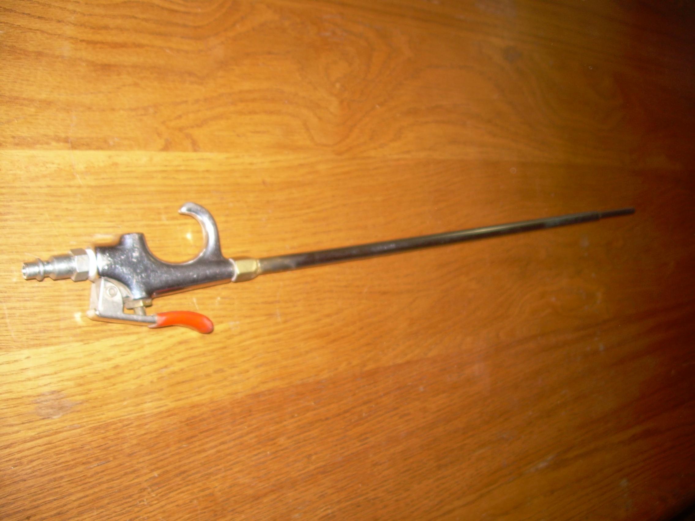

extendable air nozzle
I found this old automobile radio antenna in some of my treasure trove of goodies laying around the shop and decided to turn this into an adjustable air nozzle that will slide in and out for more reach. Brazed a fitting on the end and installed a connector for the air hose and viola a handy air nozzle that will reach into those hard to reach places.Attachment 15711Attachment 15711Attachment 15712Attachment 15713
