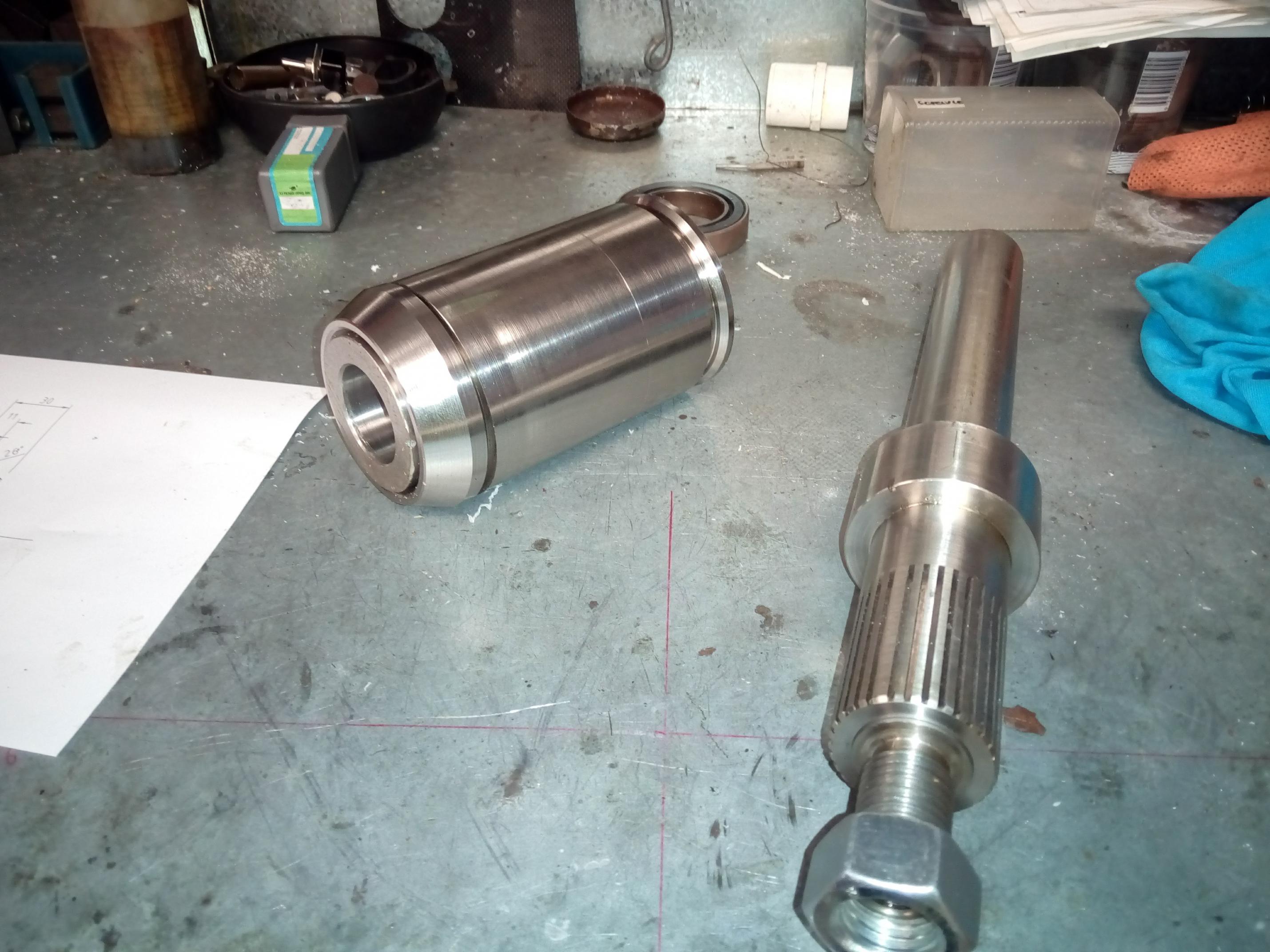

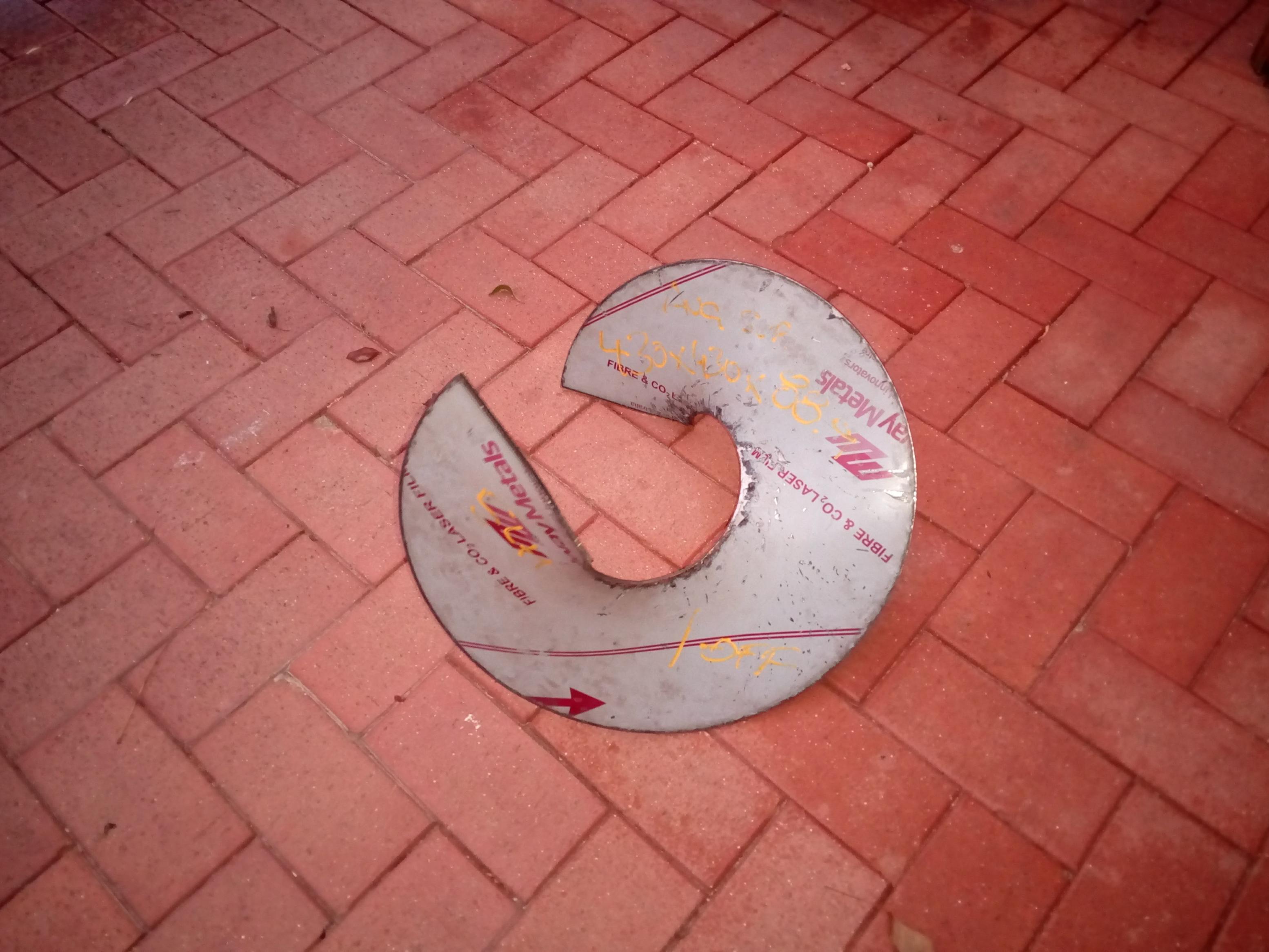

I have made the hub and have an auger scroll that i intend to cut into 4 blades.
The blades require further shaping and forging - for this I need female forge die and then a welding jig.
Attachment 18846Attachment 18847

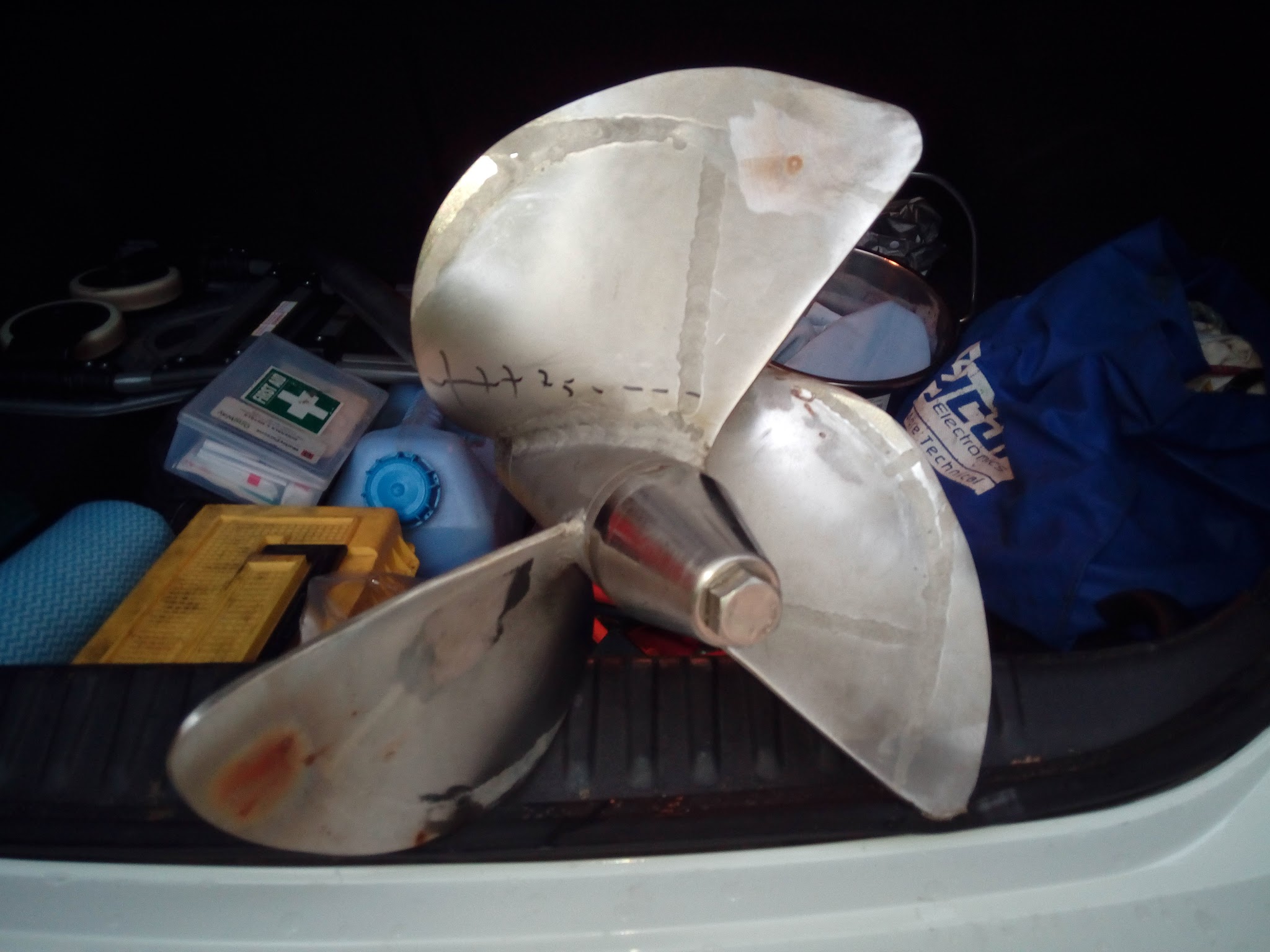

My previous effort failed when one blade bent after I annealed a section to equalize the pitch.
Attachment 18848
