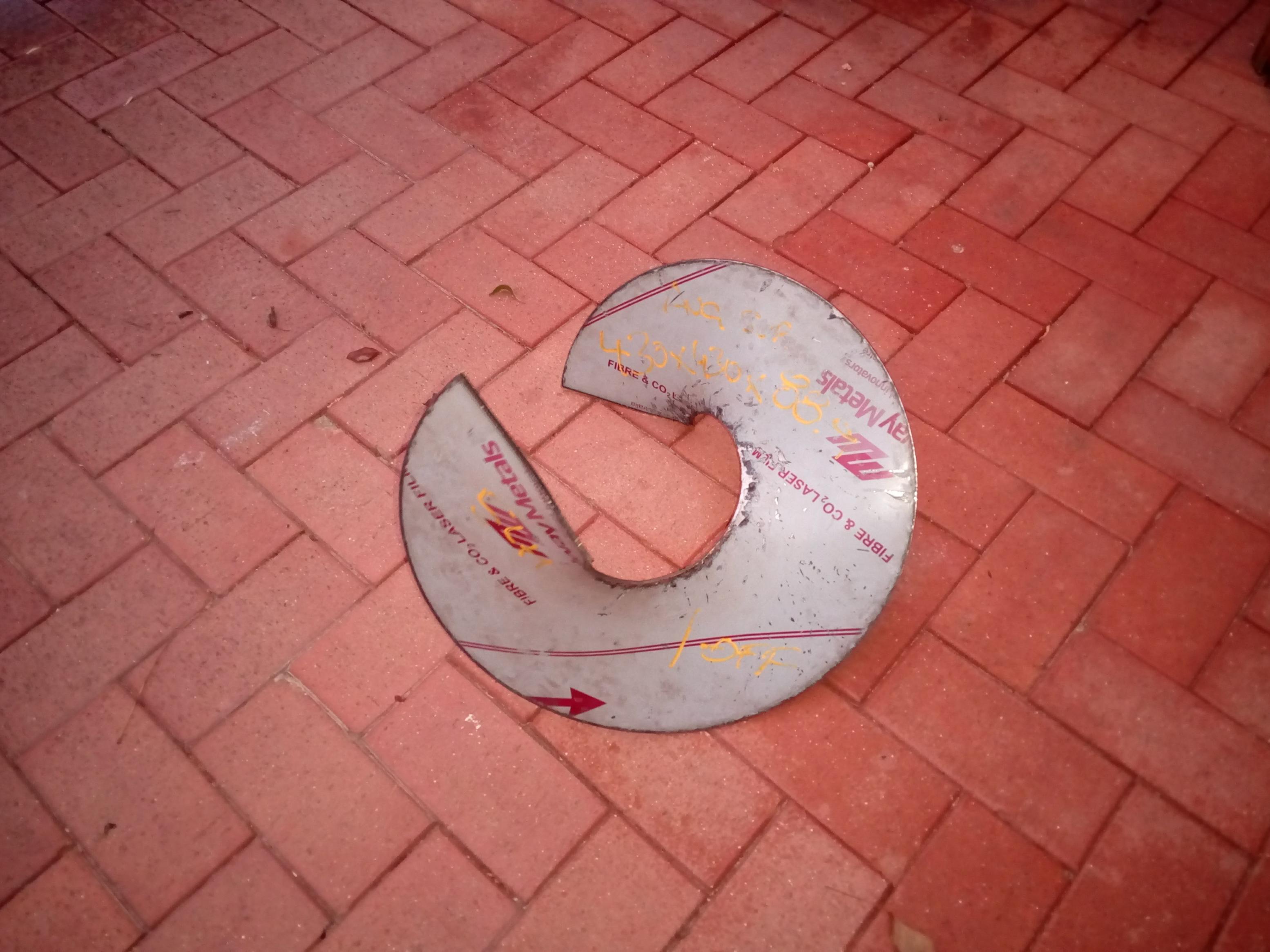

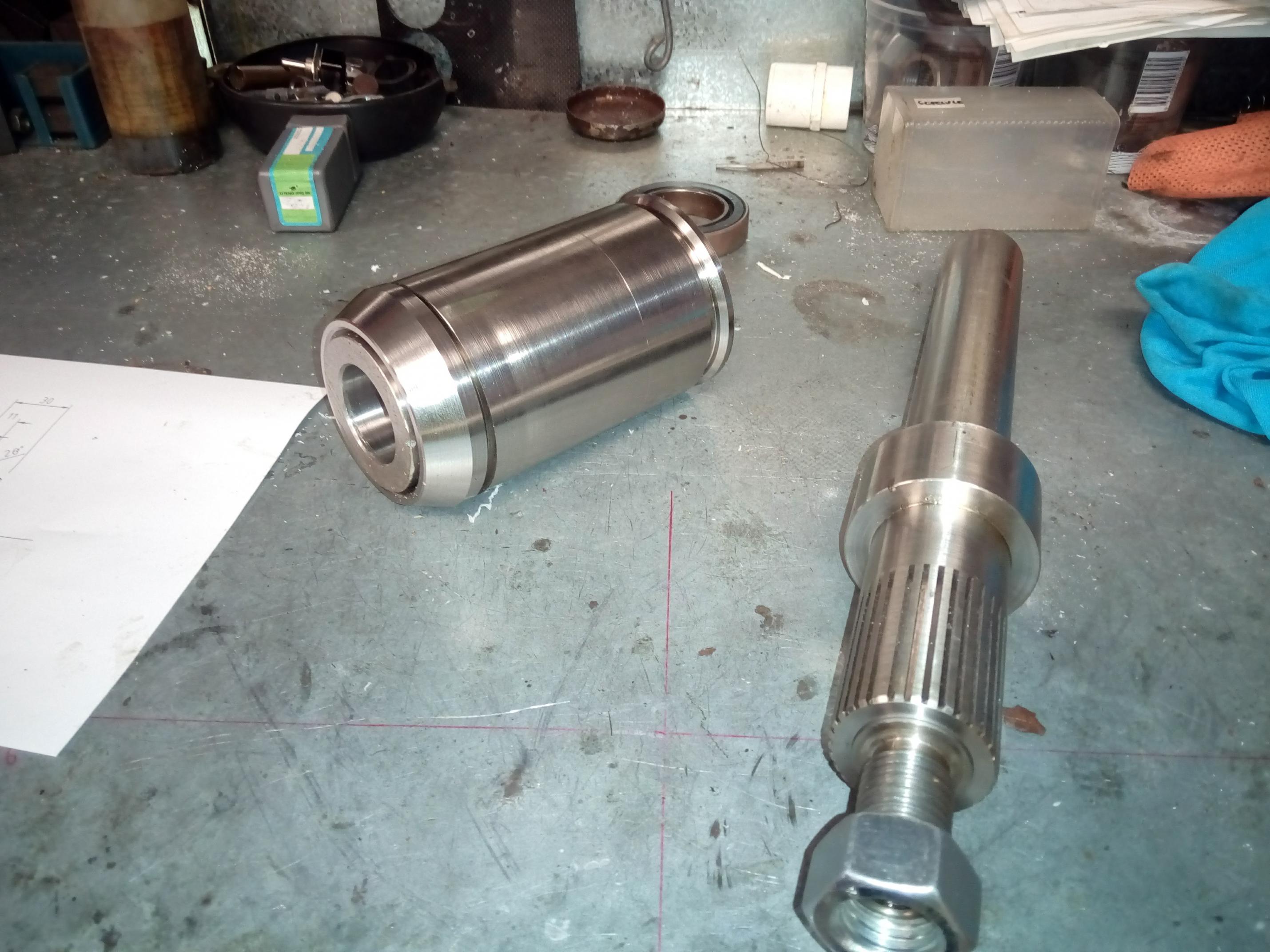

    I have made the hub and have an auger scroll that i intend to cut into 4 blades.
    The blades require further shaping and forging - for this I need female forge die and then a welding jig.
    Fabrication of a 17" boat propeller.-augerscroll17x17x3id.jpgFabrication of a 17" boat propeller.-prophub.jpg

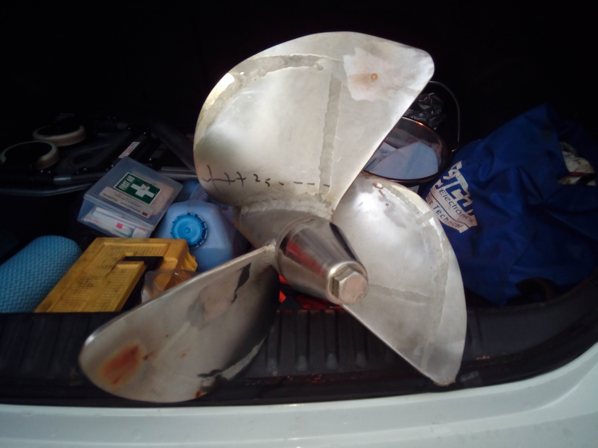

    My previous effort failed when one blade bent after I annealed a section to equalize the pitch.
