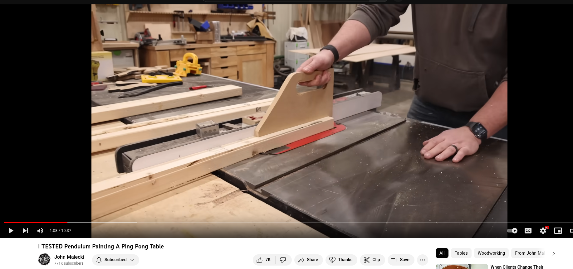

Does anyone use or trust this...
https://www.youtube.com/watch?v=7-FZWOYAyUM
y'all check this bad boy from John Malecki xD... solved the close to the blade problem!:
Attachment 45057
Plan for that flange on the end to break, or for it to slip off the end of the workpiece.
https://diqn32j8nouaz.cloudfront.net...ange_break.jpg
fair point. will improve it.
