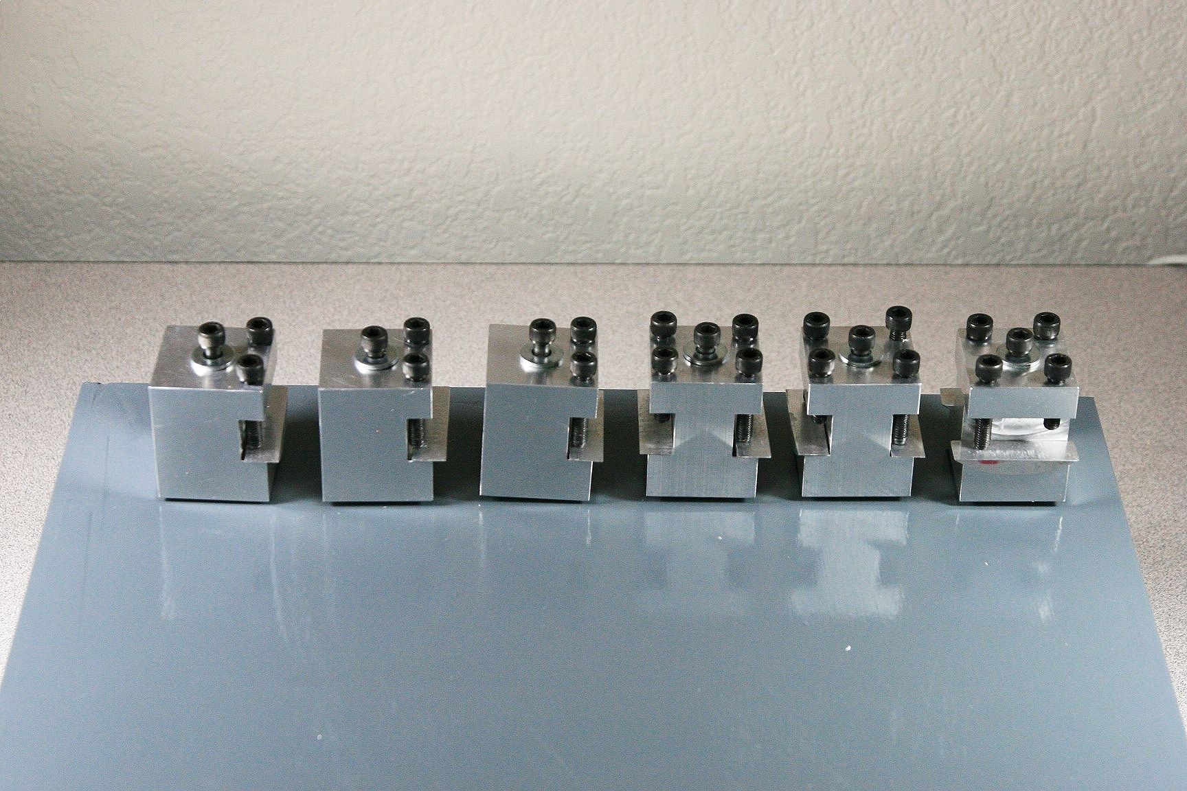

    I may make or buy a QCTP for my Sherline in the future but for now I had this idea to use the rocker type tool post on the lathe.
    The rocker tool post as implemented on the Sherline will allow easy change out without changing any tool bit height settings.
    The rocker can be made with two rockers on one tool holder which improves speed even more. Anyhow that is how I see it so I thought it was worth a try.

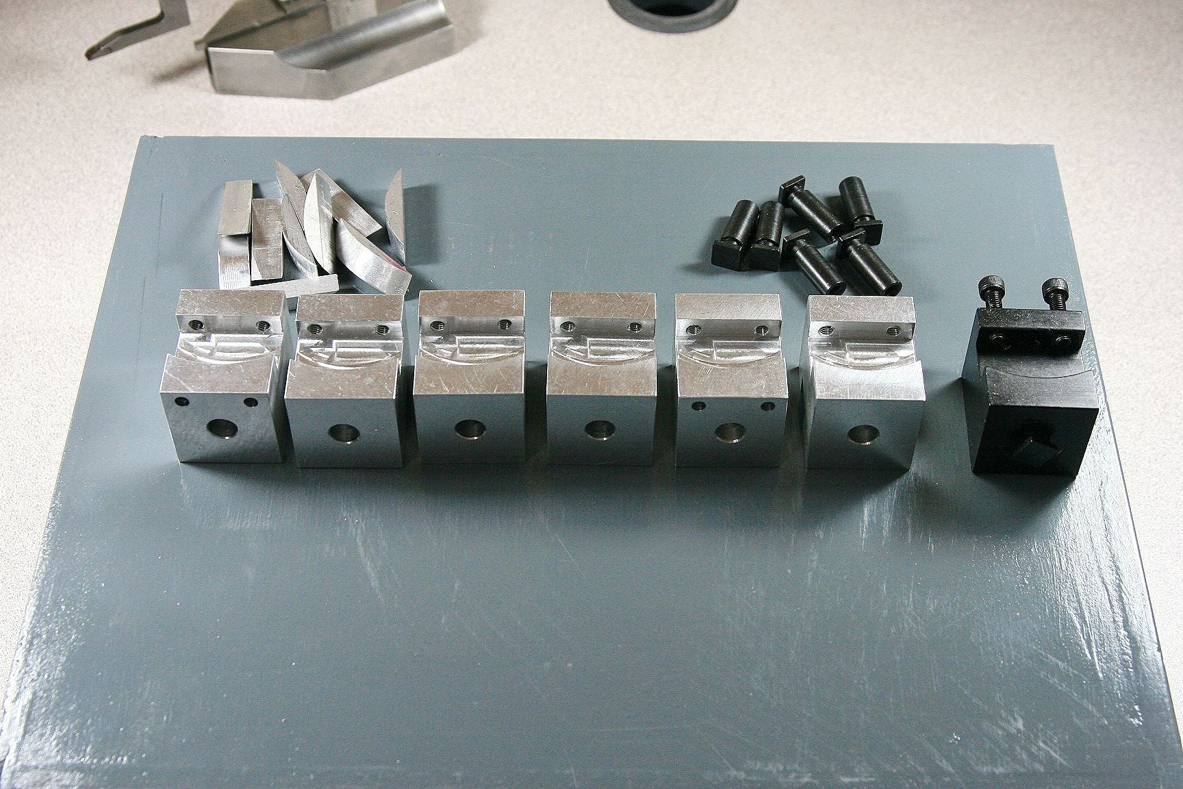

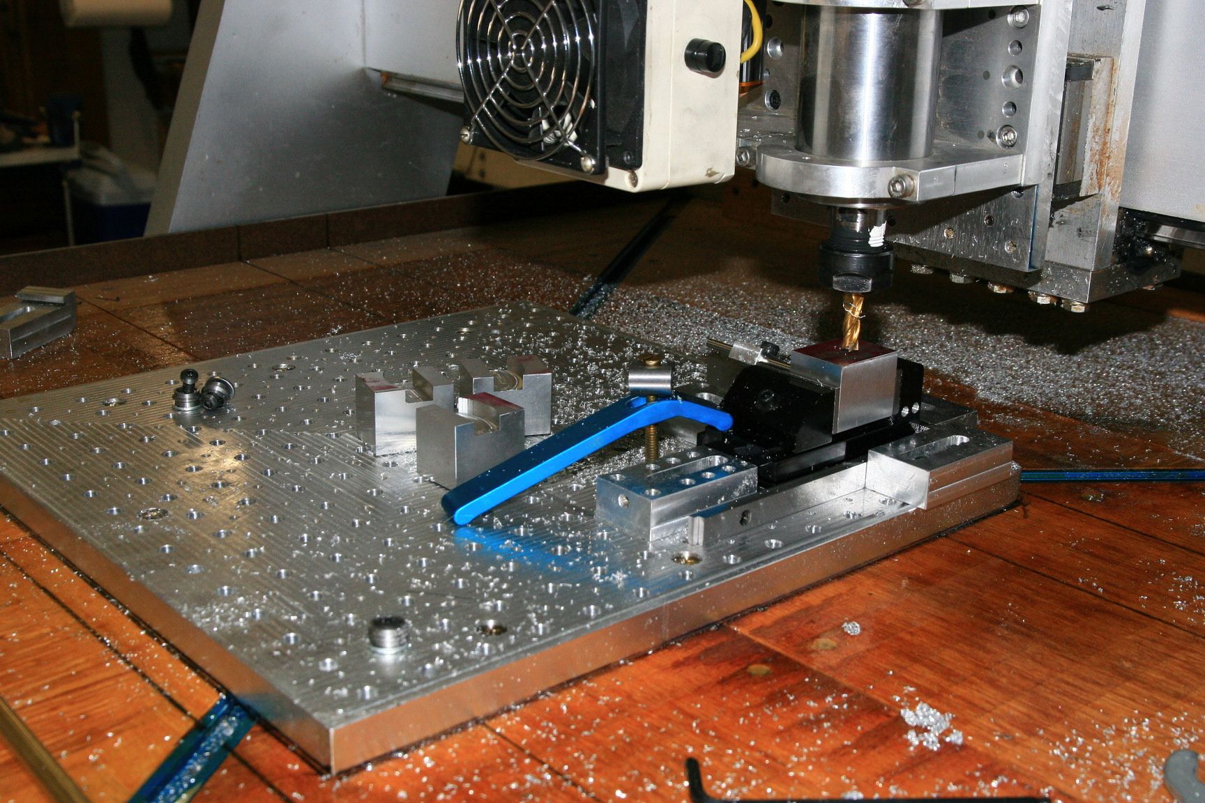

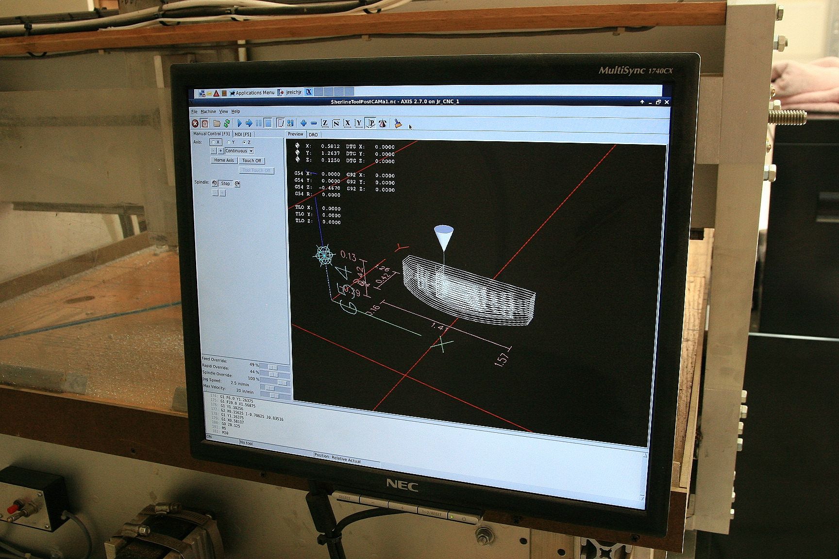

    Rockers were made on the CNC machine and trimmed by hand with a file.
    The main blocks were profiled with the radius for the rocker on the CNC machine.
    The holes were drilled on the CNC machine. Center hole was only spotted on the CNC and
    then finished on the drill press. This required a .200" hole thru the part to the bottom.
    Then the bottom was re-drilled .325" diameter to clear the shaft of the Sherline extended T-nut.
    This re-drill stopped .300" from the top of the tool holder.
    The holes for the clamping screws were tapped on the bench.
    I bought 6 extended T-nuts from Sherline to save a bit of time. Only $3.00 each so my total investment in my QCTP is $18.00.
    Should work fine, I made 3 single tool and 3 double tool holders for a total of 9 tool bits.
    The black one is the one supplied by Sherline.
    Cheers, JR

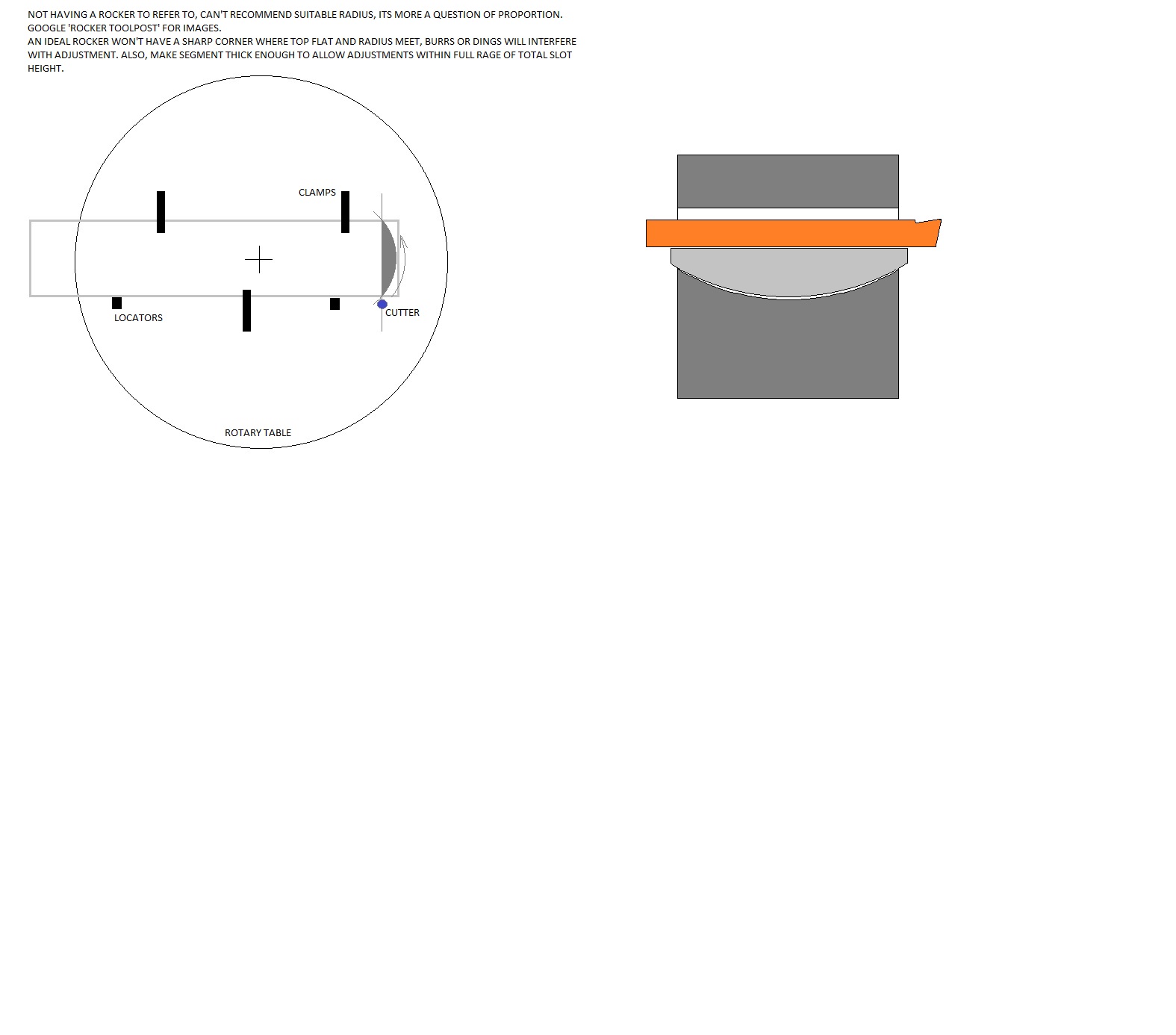

    As a suggestion to those without CNC. Rockers and Posts could be produced via rotary table quite easily.
    I start with a bar of flat stock [for either part] and fixture the table to radius one at a time, then 'part off' on a bandsaw. That sacrifices a minimal amount to chips.
    Mechanically, I'd tend to cut rockers with a slightly larger [.003-.006] radius than tool post to broaden the contact points. Ro-tab or CNC, cut and finish mating faces with same direction.
    It also seems logical to use dissimilar materials to avoid galling, if they aren't to be heat-treated.
    It strikes me, more practical than seen earlier. Quick Change usually denotes repeatable tool positioning...but unless production is involved that's not a particular advantage.
    jjr2001's Quick Change Posts add the modular advantage, a bit more rigidity, flexible setup, and less overhang than any QCTP I can recall. All those are positive features.
    I rate better usability for these over import copies of the Aloris without hesitation. Work lathe has a set of those, and don't impress me at all.
