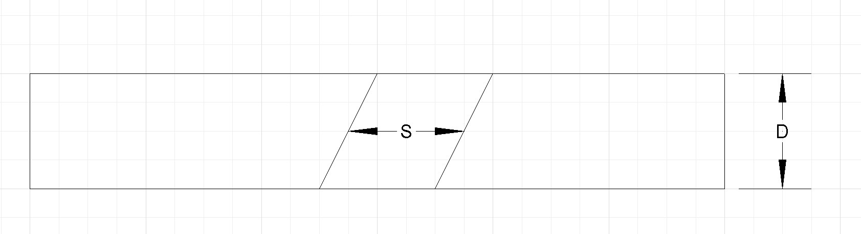

    The tube is about 0.6" to 0.7" depending on the brand. When I looked at the commercial tubing products, I found that the spiral cut spacings (S) were about the same as the diameter (D) of the tubing, ranging from 1*D to 1.5*D
    The spiral slice looks simply like this:

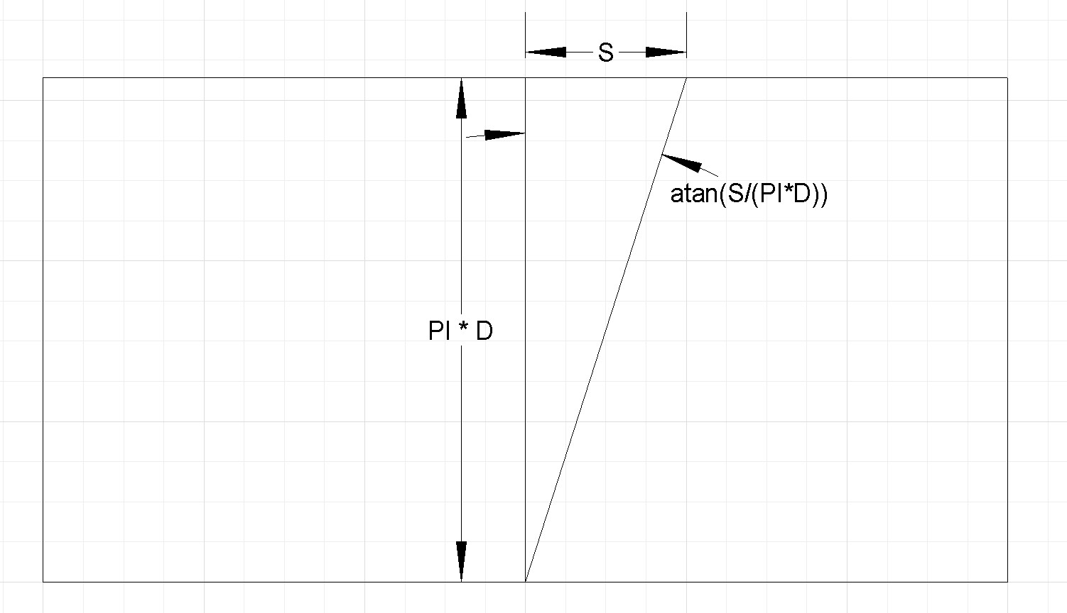

    To figure the angle is pretty simple, we know the hose diameter and the slice spacing. If we unroll the hose drawing, it looks like this:
    And - the angle is equal to atan( S / ( PI * D )) and knowing S ranges from D to 1.5*D we have a range of angles to be:
    A1 = atan(S/(PI*D)) = atan(1.00*D/PI*D)) = atan(1.00/3.1415) = 17.7 degrees
    A2 = atan(S/(PI*D)) = atan(1.25*D/PI*D)) = atan(1.25/3.1415) = 21.7 degrees
    A3 = atan(S/(PI*D)) = atan(1.50*D/PI*D)) = atan(1.50/3.1415) = 25.5 degrees
