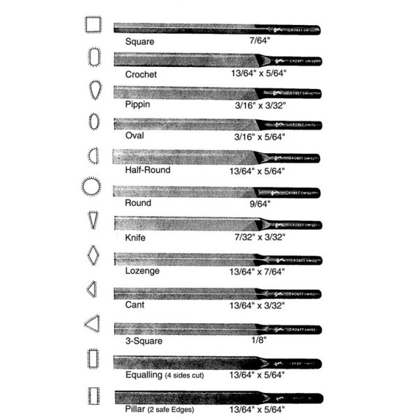

Hi Folks. I have been looking for Die Filer Files. I have found a few. They are labeled as #0, #00 , #2 . I assume this is the "Cut" rating.
Could someone please set me straight? Thanks Ken

You don't state what die filer you've got, nor the needed lengths, profiles* or dimensions for its mount,
but at least This Old Tony devised how he reground the tangs (to fit his particular filer) for more common and thus affordable files:
His die filer rants starts at app 14 minutes in:
https://www.youtube.com/watch?v=6lxJ3E_UjtY
Other tips for making "Type A" files: Making Die Files
The file profiles of Yesteryear:
Attachment 40081
Hope this helps!
