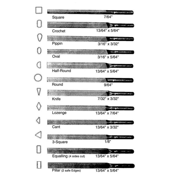

    You don't state what die filer you've got, nor the needed lengths, profiles* or dimensions for its mount,
    but at least This Old Tony devised how he reground the tangs (to fit his particular filer) for more common and thus affordable files:
    His die filer rants starts at app 14 minutes in:
    Other tips for making "Type A" files: Making Die Files
    The file profiles of Yesteryear:
    Hope this helps!
