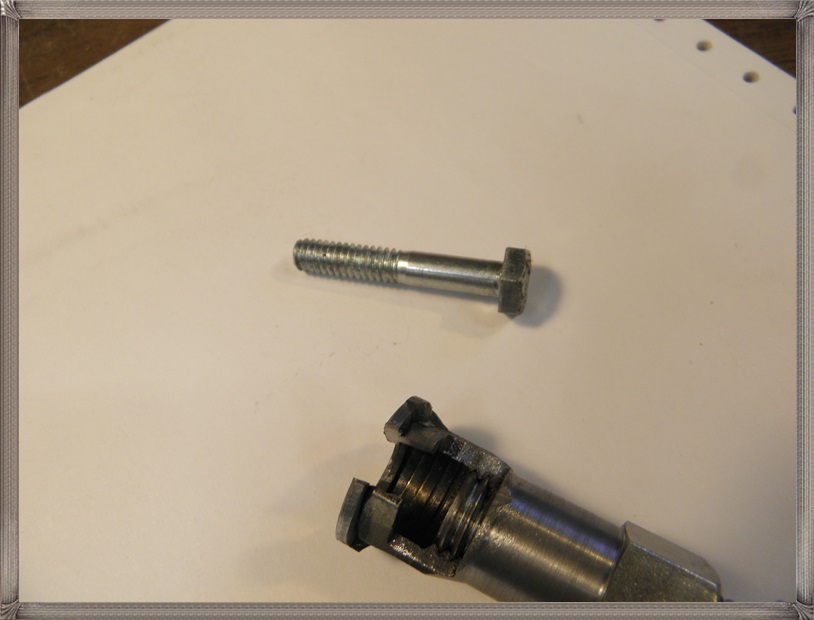

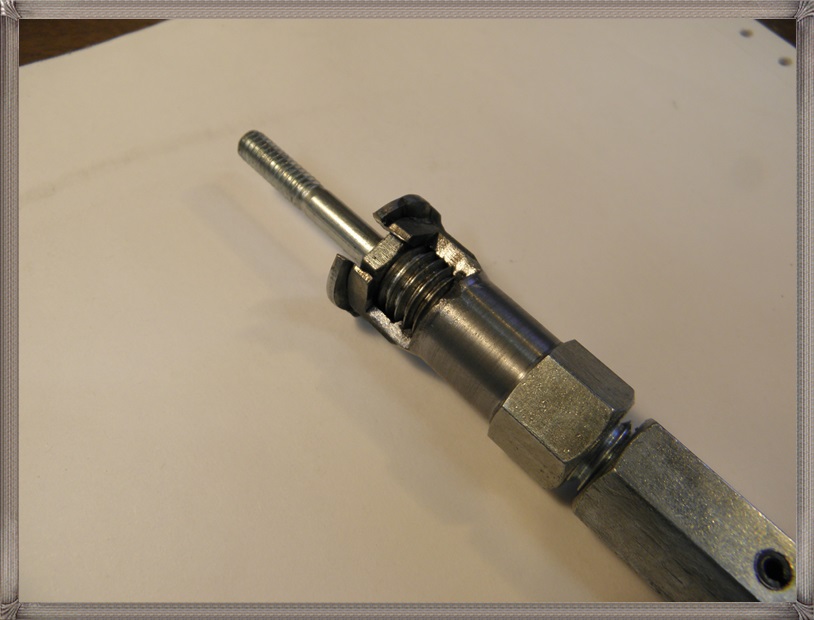

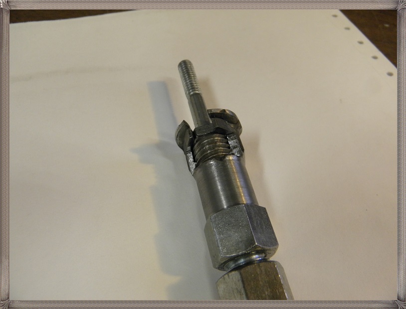

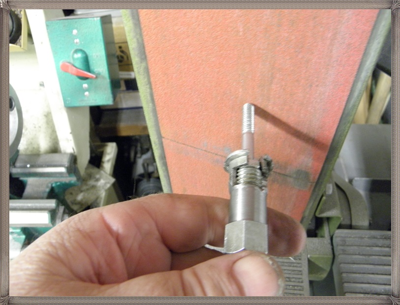

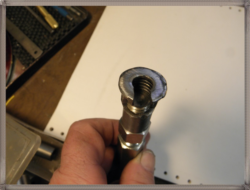

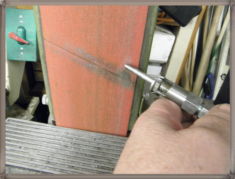

Finger Saver-Screw Holder By inserting the screw in the slot and turning the handle screw to tighten the screw head that you are trying to deburr you have a steady holder for sanding-rounding the threads on a screw you have cut to length.
Attachment 22291Attachment 22292Attachment 22293Attachment 22294Attachment 22295Attachment 22296
