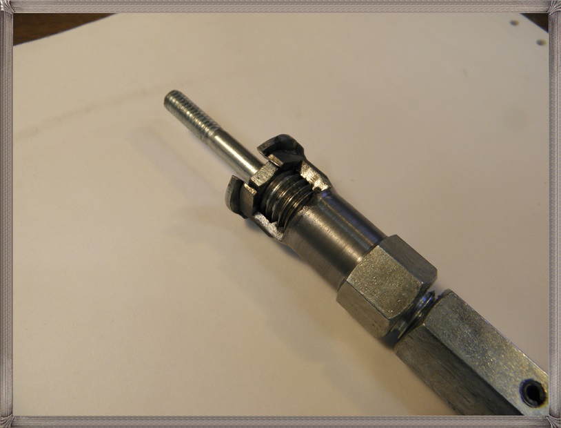

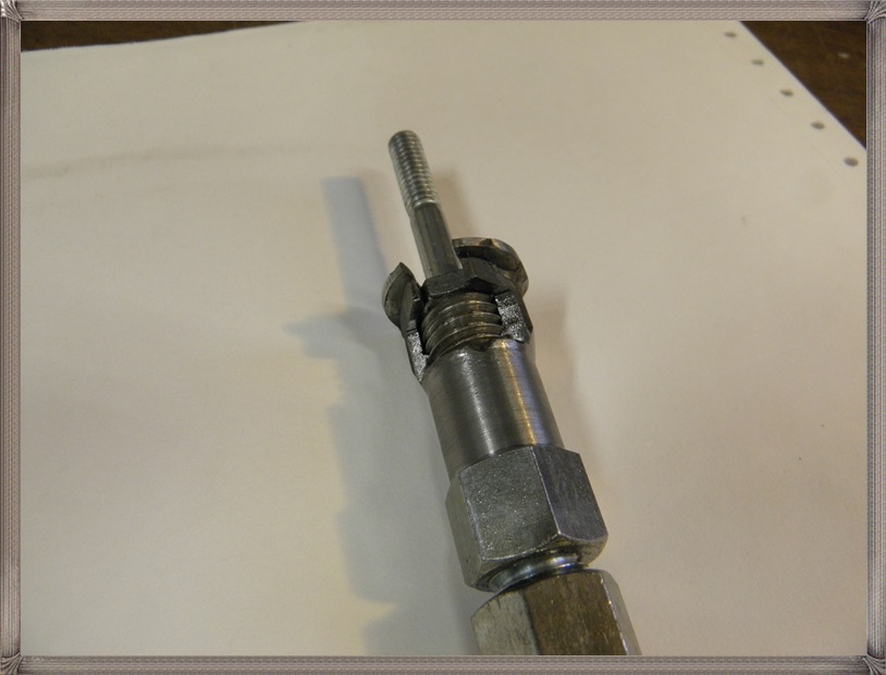

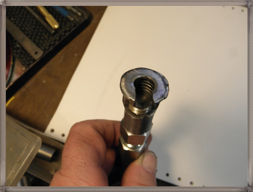

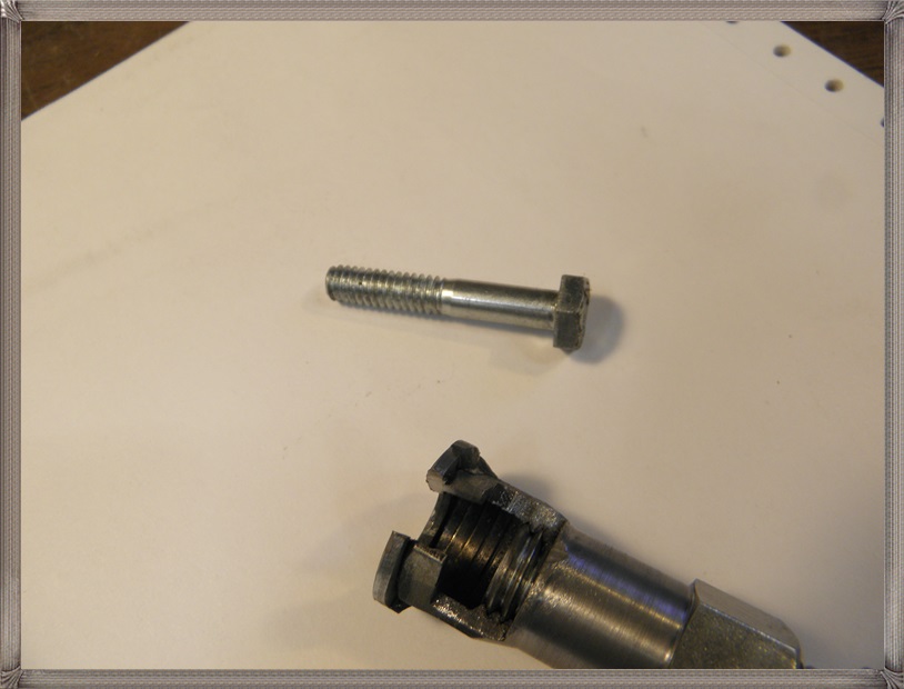

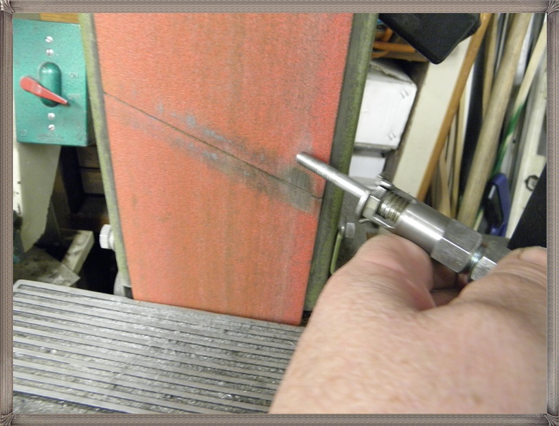

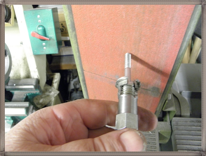

    Finger Saver-Screw Holder By inserting the screw in the slot and turning the handle screw to tighten the screw head that you are trying to deburr you have a steady holder for sanding-rounding the threads on a screw you have cut to length.

    Wow - there's probably a marketing niche for a tool like that. It sure beats the hell out of trying to hold onto something, with anything else. ☺

    Lantern vises don't get limelight they deserve, Captainleeward's use of such a device is a perfect example.
    With a little planning, they can have a handle to grip, a shank for chucking in a lathe, flats for mill or bench vise etc. Facilitate indexing with flats in square or hex form. Even if the [your] frame is a little large, a smaller ID washer will bush the hole.......That's what Toolmaking is all about; evolving solutions.

    Toolmaker51 , Hello you are so right I forgot to list to use a the washer for smaller screws thanks for reminding me.
