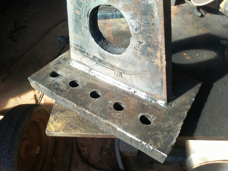

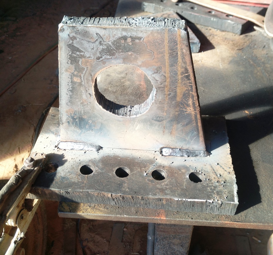

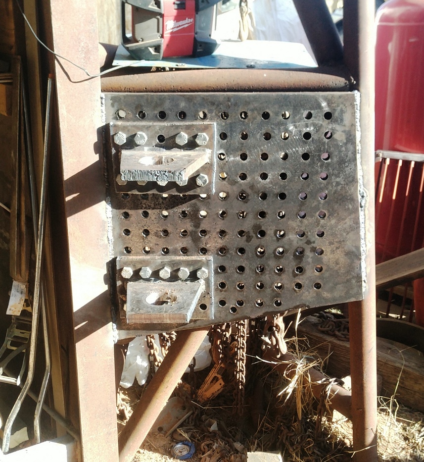

To tiwst the Excavator H link I needed to hold it in place this was the reason why the pattern plate. these ears I call the bolt on pad eyes an old oil field term

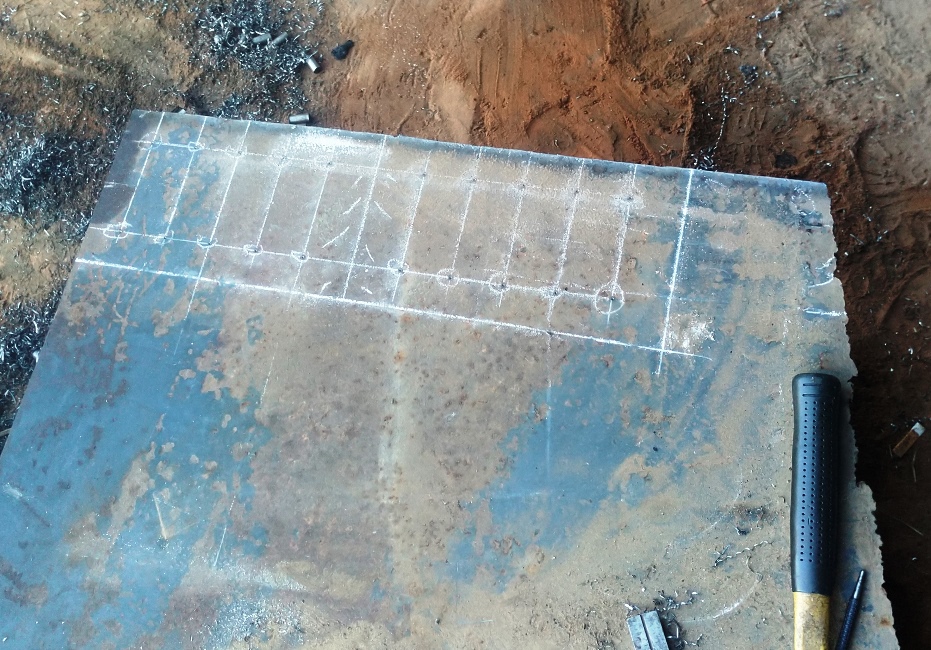

cut from I" plate and drilled to the 2-inch pattern
