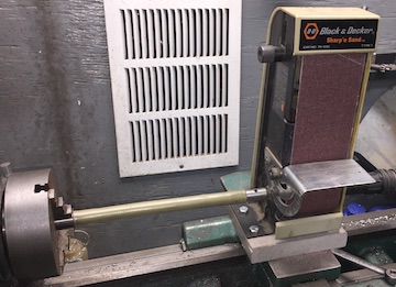

I have an old Black and Decker belt sander that was my dads.
It is designed to put an electric drill into for a power source.
But then it slides around on the bench or goes too fast and heats parts too much.
Mounting it on the lathe gives a solid mount. speed control, quick and easy switch
from tool post to disk sander.
A flexible shaft drives the sander and avoids the necessity
of making a precession mount to line up the centers

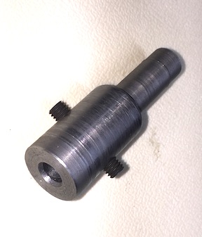

I made a flex shaft using a piece of broken pressure washer hose.
An adapter for each end that is a snug press fit into the braided steel reinforced
hose worked well. There is not much torque involved
The adapters are the same on each end, except the sander end has set screws.
No sizes are provided as everyone's situation will be different. By trial and error, 0.020" press fit
is adequate for my situation. Notice the small section on the end of the adapter
to aid in getting it started straight
Attachment 49846

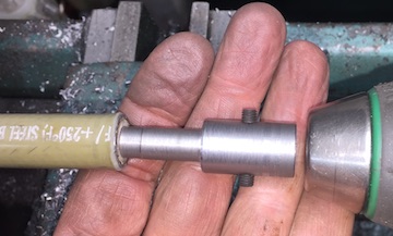

The ends were pressed in while holding the hose TIGHTLY in my collet chuck.
Attachment 49847Attachment 49848
Use the set screws to attach to the sander. Then hold the other end in the chuck
Attachment 49849Attachment 49850
The set up is quick and easy, when necessary
Attachment 49851
