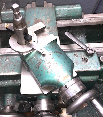

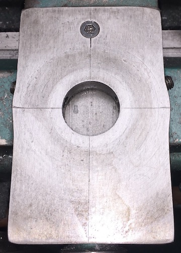

    This is how I attached a simple belt sander to my lathe .
    My compound slide attaches with two set screws. It comes off quickly.
Name:	01 compound slide.jpg
ID:	49859 Click image for larger version.
Name:	02 removes quick.jpg

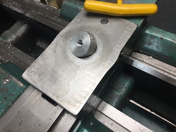

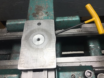

    A simple aluminum cylinder with a threaded hole in the center provides
    a secure point for attaching various accessories.

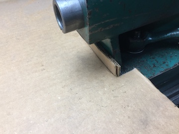

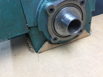

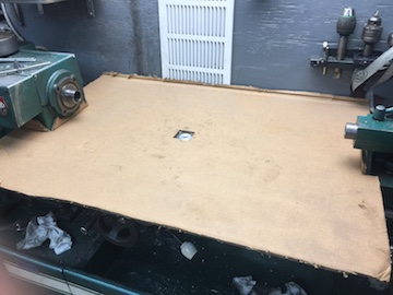

    To keep sanding girt from getting all over the machine, thick cardboard
    fits between the head and tail stock.

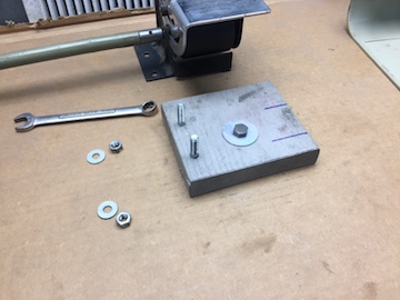

    A base made from composite deck material bolts to the cross slide. Washers take up
    space between the slide and top of the cardboard.
    In retrospect, should have made the cylinder a bit taller.

    The flex coupler (Flexable Drive Shaft)
    is then fit into the chuck, the sander down over the studs and snugged up.
Name:	09 base installed.jpg

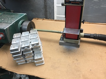

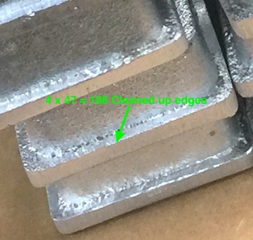

    The sander has a port for attaching a vacuum which is very effective. The chips
    you see is all the escaped after removing the parting line flash from 4 sides of
    those 47 aluminum castings. (That green text on the casting points to the sanded edges)
