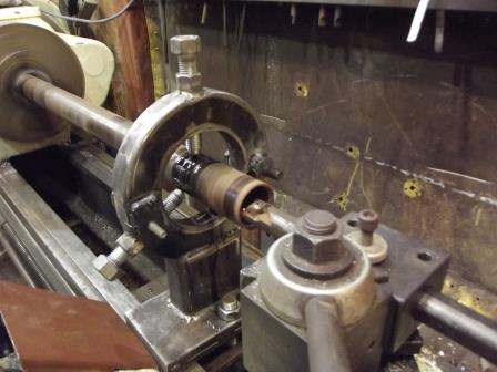

Here is my folding roller I made today for my band saw

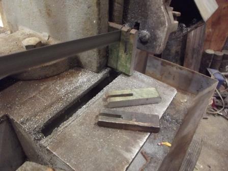

First I had to use the steady rest I made a couple days ago so I could bore the ends to accept the bearings
Attachment 9413

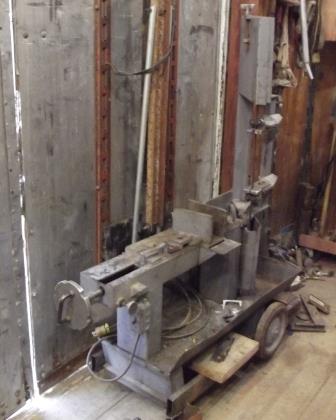

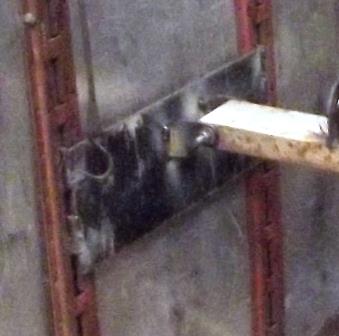

Next was to cut the mounting tabs that would fit in the "E" track slots on the door
Attachment 9414
Next was to weld the mount and attach the roller assembly
Attachment 9415

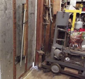

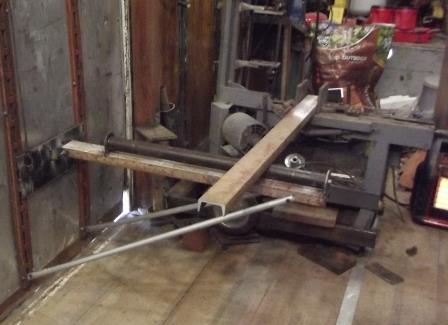

Next was to check the alignment in all positions
Attachment 9416Attachment 9421
Attachment 9418

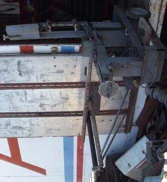

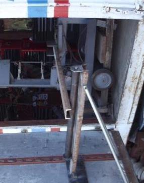

Next to see how well it tucked away I will have to eventually get a better holding strap or a shorter bungi cord when it is folded up out of the way
Attachment 9419Attachment 9420
