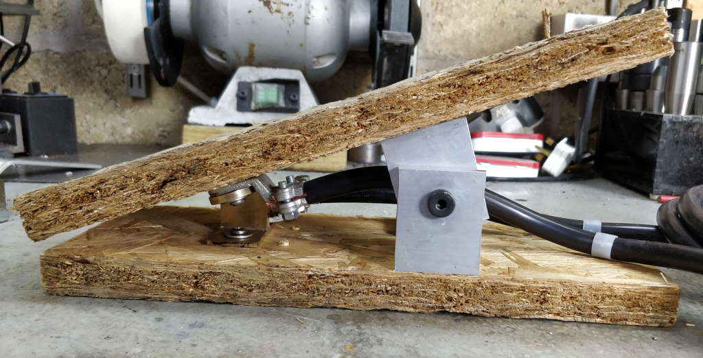

    I've just written up some details of a foot switch I made to break the circuit at the end of a TIG weld with my fairly basic welder.
    Here's a (not very good quality) photo:
    There's a full write-up with more details and lots more photos available here: https://www.cgtk.co.uk/metalwork/mis...tigswitchpedal

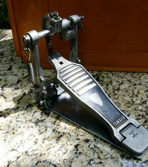

    In a similar endeavor I'm making a current control pedal for my TIG welder starting with the bass drum kick pedal below. I'll mount a 60 tooth timing pulley on the top shaft and a 17 tooth timing pulley on a yet to be made lower shaft that will match the pedal's 90º travel to the pot's 315º travel and couple the two with a 10mm XL timing belt. I got the sturdy Yamaha pedal for $10 and it's saved me a bunch of reinventing the wheel.
    If you're interested, there's a guy on Ebay selling High Frequency arc stabilizer kits for welders and I've found the product and the seller to both be of high quality. The kit consists of a spark gap oscillator and HF coupling transformer which attaches to just about any welder. I even added a trigger switch to my stinger handle to use HF arc starting when I'm stick welding and I love it.
    ETA: I just checked and the seller Hewad has temporarily emptied his Ebay store due to a move from Ten. to Ark. He says that he'll resume in 2 months, but if you just have to have an arc stabilizer now I have his email address and he might be able to help you before then. PM me if you want it.

    Whoa there - delete that DIYer. It's just a bass drum pedal that's been partially disassembled and is technically nothing at this point. As the text that's included with the picture explains, it's only the beginning of a TIG welder current control pedal. When I've finished and tested it then I'll post it in the appropriate forum.
    A welder foot switch and a welder current control pedal are two similar but different things.

    Great use of scrap OSB.
