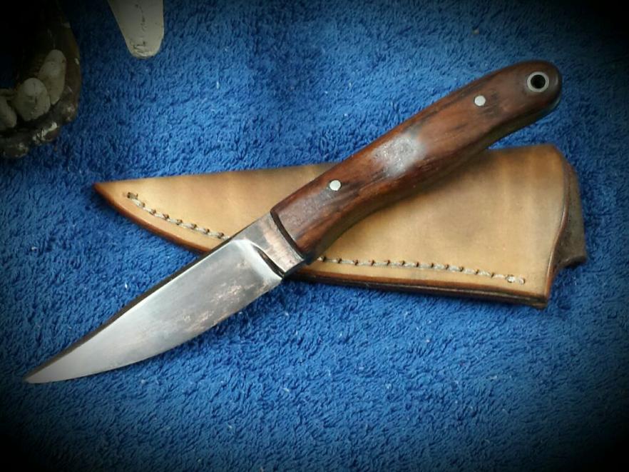

    Knife forged from 1084 high carbon steel. Blade hand rubbed and polished. Forced copper and ferric chloride patina. Black American Walnut handle with 416 stainless steel pins and lanyard tube. The sheath is handcrafted Herman Oak leather treated with Aussie leather conditioner and saddle stitched by hand.

    Love the curves. Nice job George.

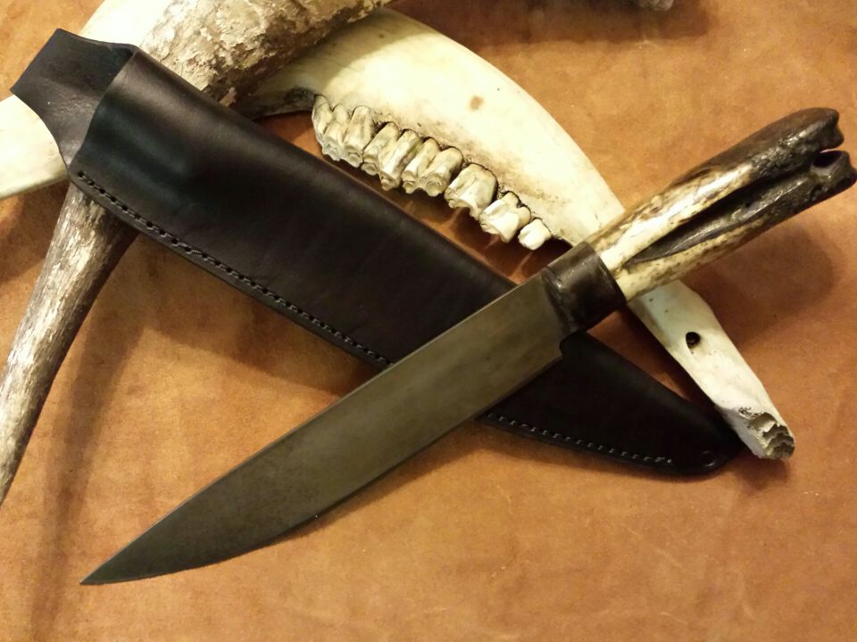

    Thank you! I've made over 300 knives to date. Here's a another one.
    This one was for a reenactment client that needed a basic sheath to carry it in on the way home. He's having a sheath made by the gut who made his trapper outfit.

    Hi George,
    Your knife and it's sheath are simply gorgeous. I love the picture too !
    I like the patina, it's totally my test !
    Can you give more details on your process ?

    Great-looking knives both, GBrackett! I like the first one better though.
