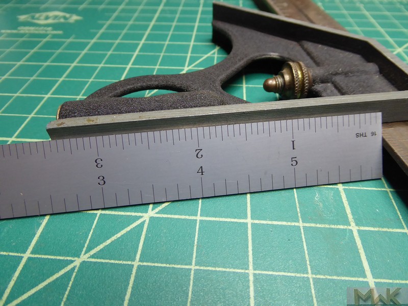

In this photo...
Attachment 48685
I measured H to be 3 & 7/16 in and calculated the beam length needed to form a 30 degree angle...
B = 3.438 / tan (30) = 3.438 / 0.577 = 5.954 in ~= 3 & 15/16 in.

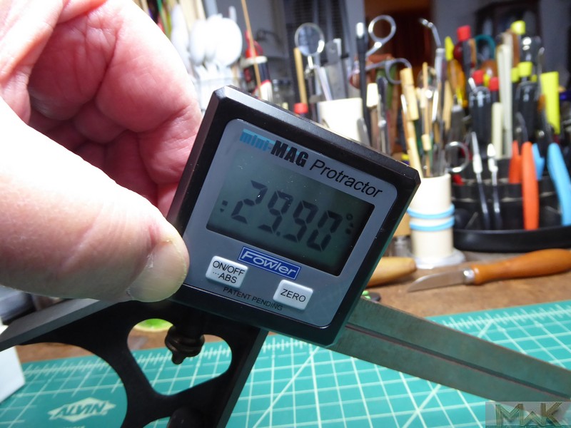

I set the beam to that length and then measured the angle formed with an electronic inclinometer...
Attachment 48686
OK, it's not perfect, but close enough for many applications, especially if the more accurate tools are not to hand.
