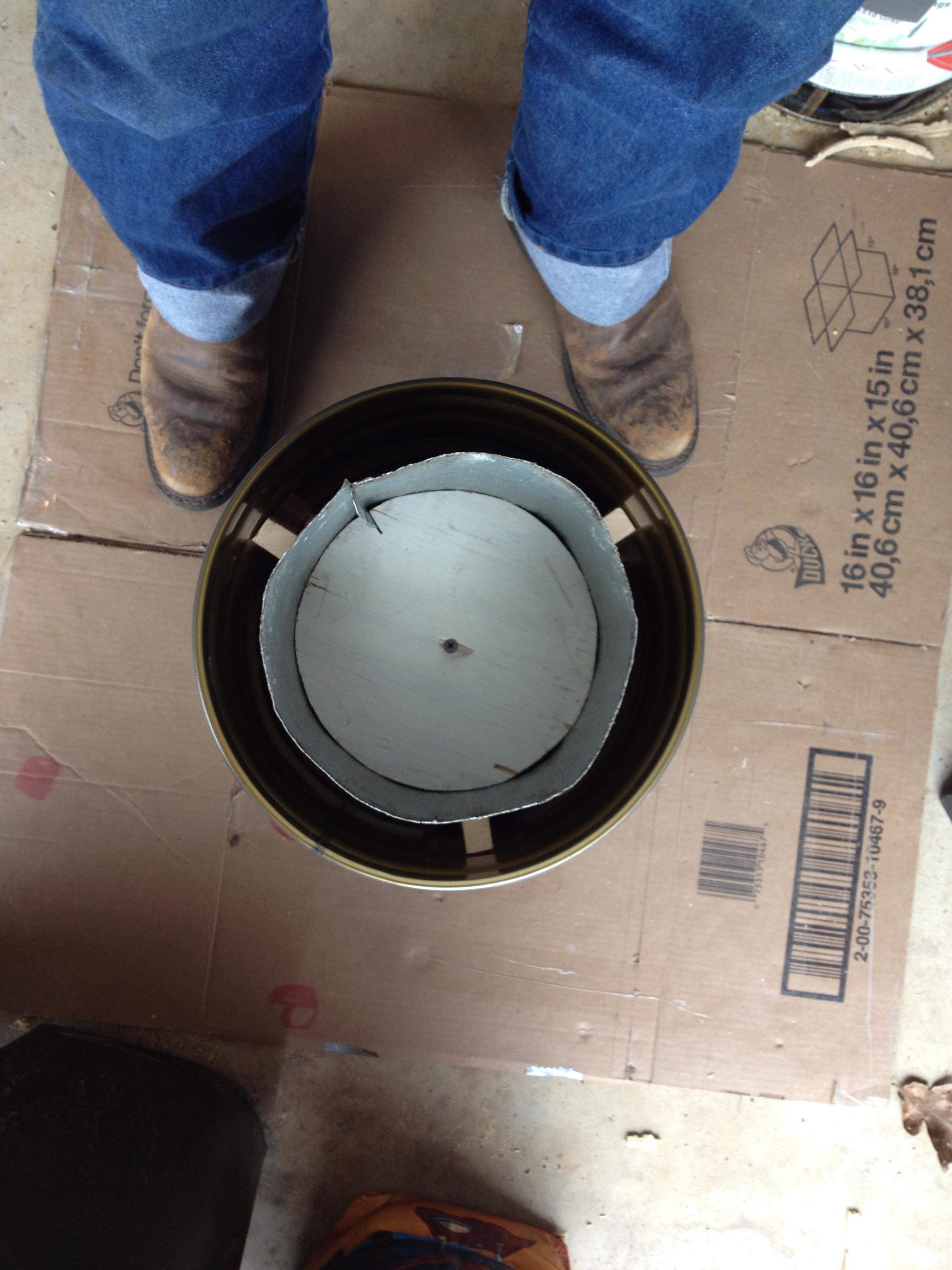

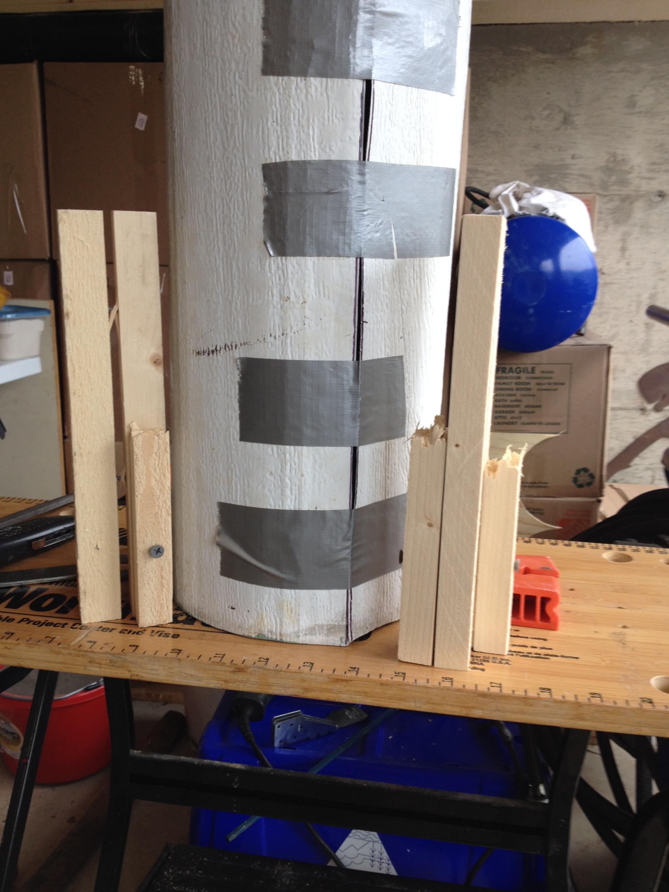

I've built myself a Gingery-like charcoal furnace. Here I present my infinitely adjustable spacers used to center my internal form. It's just 2 sticks of scrap screwed together with drywall screws and then separated with a chisel. Advance or retreat the screw to increase or decrease the space between the sticks. The short sticks attached to the sides of the spacers maintain the spacers' vertical position.

For my refractory I mixed 2:2:1.5:1.5 portland:finely sieved sand:clay:perlite (all by weight). I mixed it tight, barely moist, and rammed it into place after which I set a 60 watt incadescent bulb for a long weekend while we went away.

I can get the borax red, but I don't have a pyrometer. I'm melting cast Al, no cans or extruded. I'm guessing I get about 1300 *F no problem. So far no apparent damage to the furnace or major crack in the refractory.
