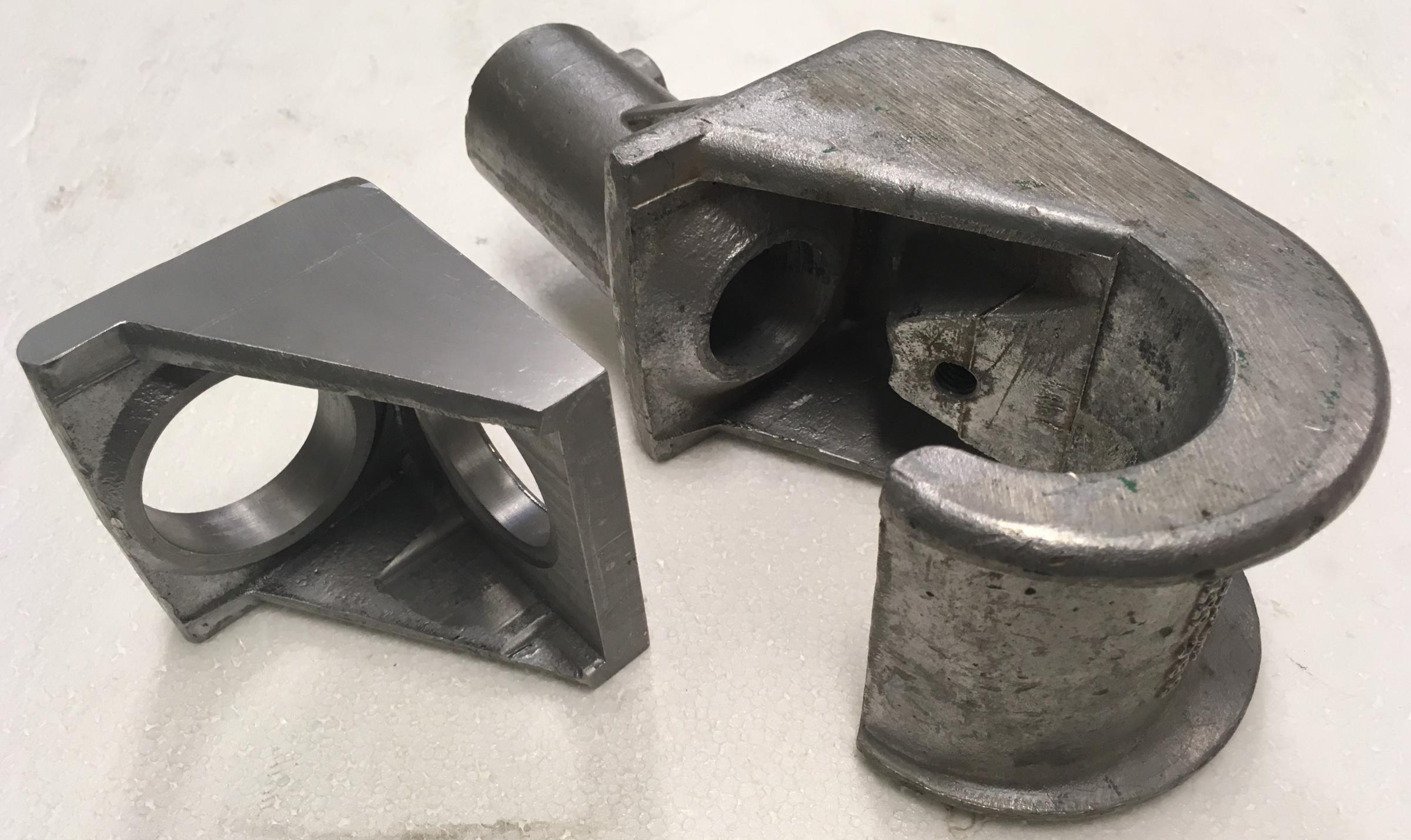

    Found a box of discarded old BBC TV ighting clamps (pic right) heading for the metals dumpster at work,
    and using my X-ray vision I previsualized a free angle plate (left) hidden therein for my home shop mini lathe.
    An hour's butchering session taking all excess material off resulted in the following (apart from a bucket of swarf):

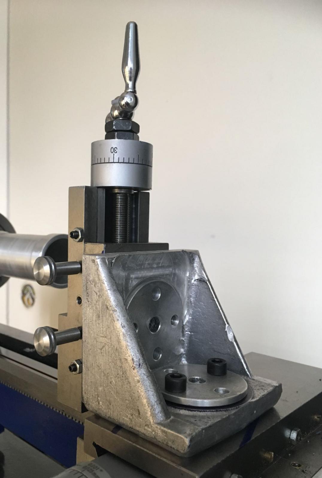

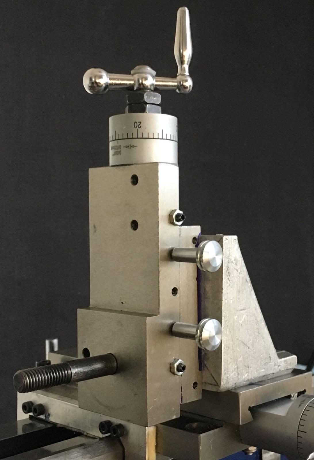

    As Providence would have it: When bolted to the cross slide the hole centre would line up with the chuck axis,
    and there's enuff metal to provide room for the same fastening plate as on the lathe's x-slide.
    Hence the compound can be mounted and tilted front or back, and the entire contraption can also be rotated.

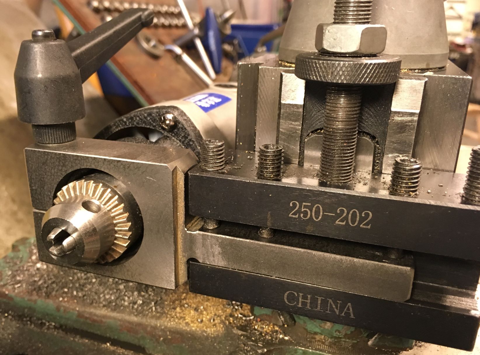

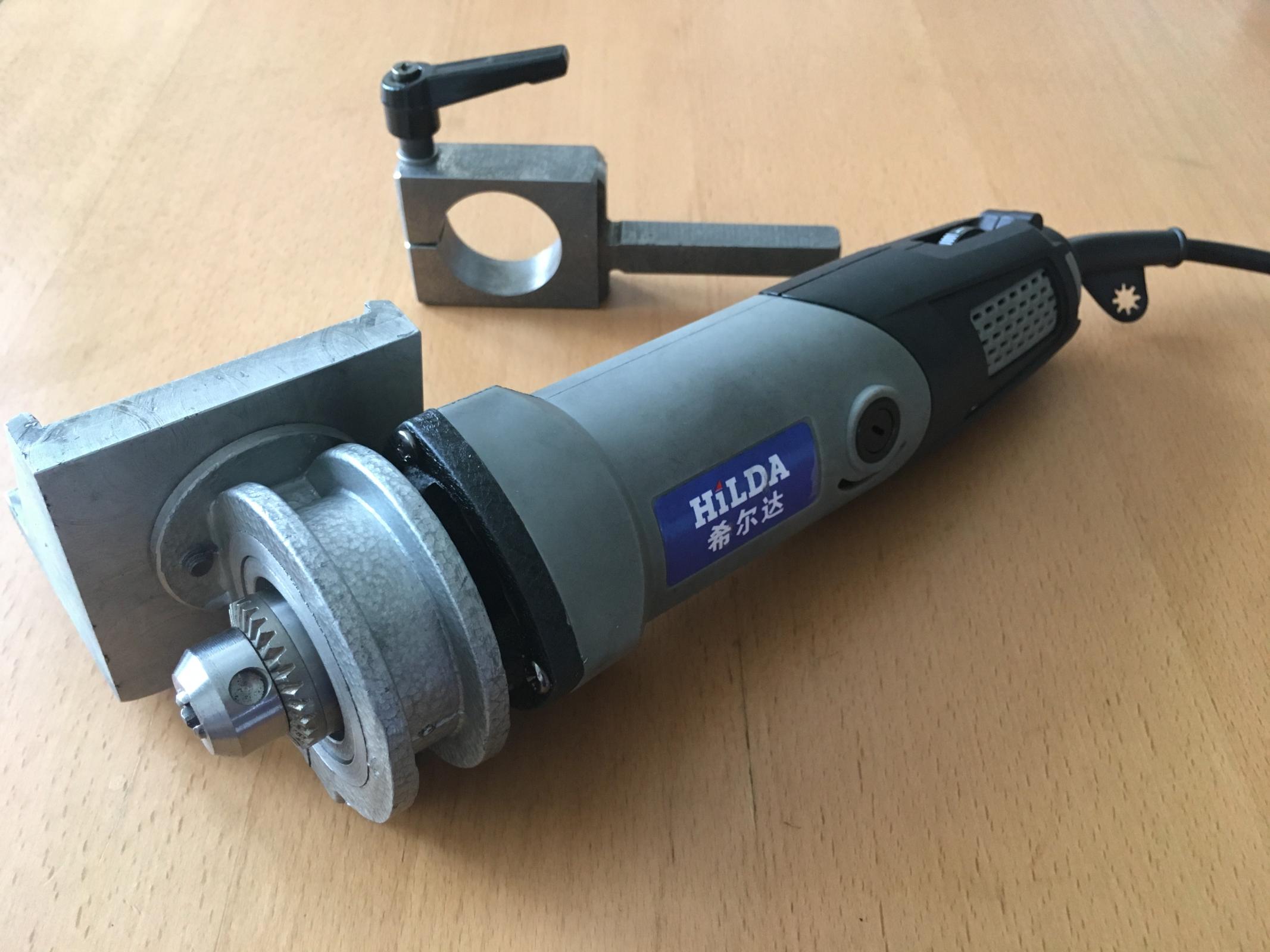

    Being a universally-minded cheapskate, I also found it could serve as a good enuff mount for the Hilda,
    my Cheap Chinese 400W Honcho Dremel, and using some bits from an old mike boom dolly,
    (also destined for the recycling dumpster) I kludged this holder together,
    as well as a decided toolpost mount from a piece of cast iron counterweight:
Name:	Hilda Angle TP grinder.jpg
ID:	30126 Click image for larger version.
Name:	At the work-lathe.JPG
    This gadget won't take deep cuts at fast feeds, but "Good enuff for my Mini Lathe!" And it's free - as most of my tools!
