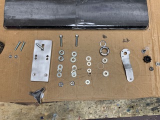

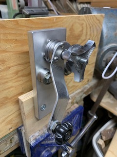

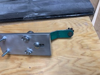

I don't really need one of these, but I wanted one, but didn't want to spend the coin for one. Off to the scrap pile I went.
A chunk of mystery aluminum, a chunk of 1040 barstock, skateboard bearings, a road sign, an air cleaner knob, and a bunch of bolts.

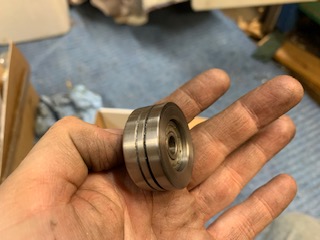

The design is the standard one, but I made the center roller the adjustable one. It works. The two grooves in the roller are to accommodate the common wide and narrow fret wire tangs.
Attachment 41308 Attachment 41309 Attachment 41310
I didn't bother making it pretty, obviously.
