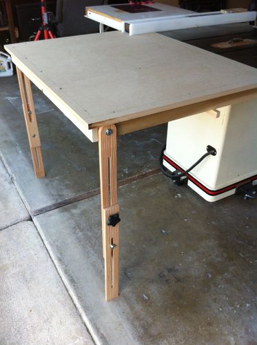

Hello, You can buy telescopic metal feet, there are many in the trade. OR, make simple adjustable wooden feet. Or a little more sophisticated, make a hollow square foot in which an adjustable post slides.
Attachment 18076
I put steel channels made from two pieces of angle iron welded together and bolted to the sides of my table saw. I have a 20" or so extension made of MDF and 2x6 that plugs into the channels I can use as a router table if on the front or a table extension if slid into the motor side. I'll take photos if you want.
