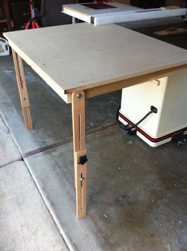

    Sep 2016
    Thanked 0 Times in 0 Posts
    Hello, You can buy telescopic metal feet, there are many in the trade. OR, make simple adjustable wooden feet. Or a little more sophisticated, make a hollow square foot in which an adjustable post slides.
