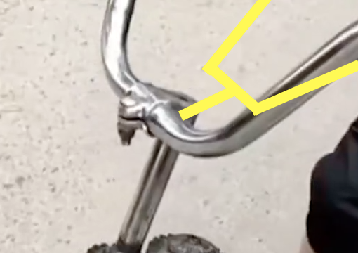

    What is achieved by doing that ? -------------------

    Reverse steering as a result, turn left to turn right.

    Not long ago, I saw a video where this fellow made a reverse steering bicycle to demonstrate human learning or adaptation - or some such experiment.

    You can accomplish a similar effect with a lot less work by installing the handlebar head turned 180 degrees. Try it but make sure your kid has a helmet, knee and elbow pads!!!! It makes the bike very difficult to ride.

    About the only way reversing the stem riser changes anything on the handling of a bicycle is ,by doing so, places the bars some distance either away from or closer to the rider
    Frank,
    You are assuming that only the stem riser was rotated. What if the effect was achieved by simply rotating the whole fork and stem. Then you change the trail drastically and so it would be very different to ride.
