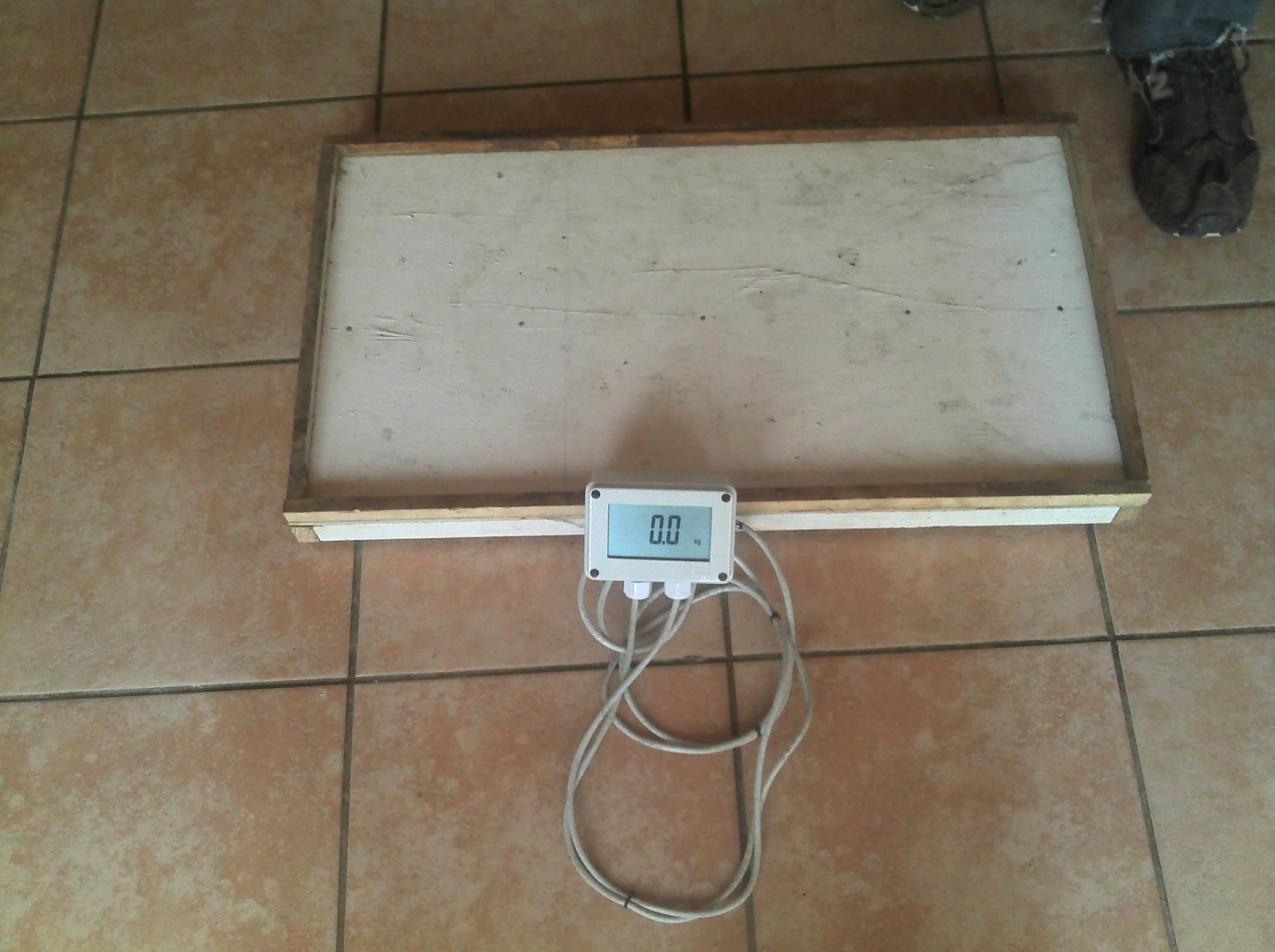

I took it to pieces and re installed the load cells on a wooden platform, big enough to provide for standing space for a goat.

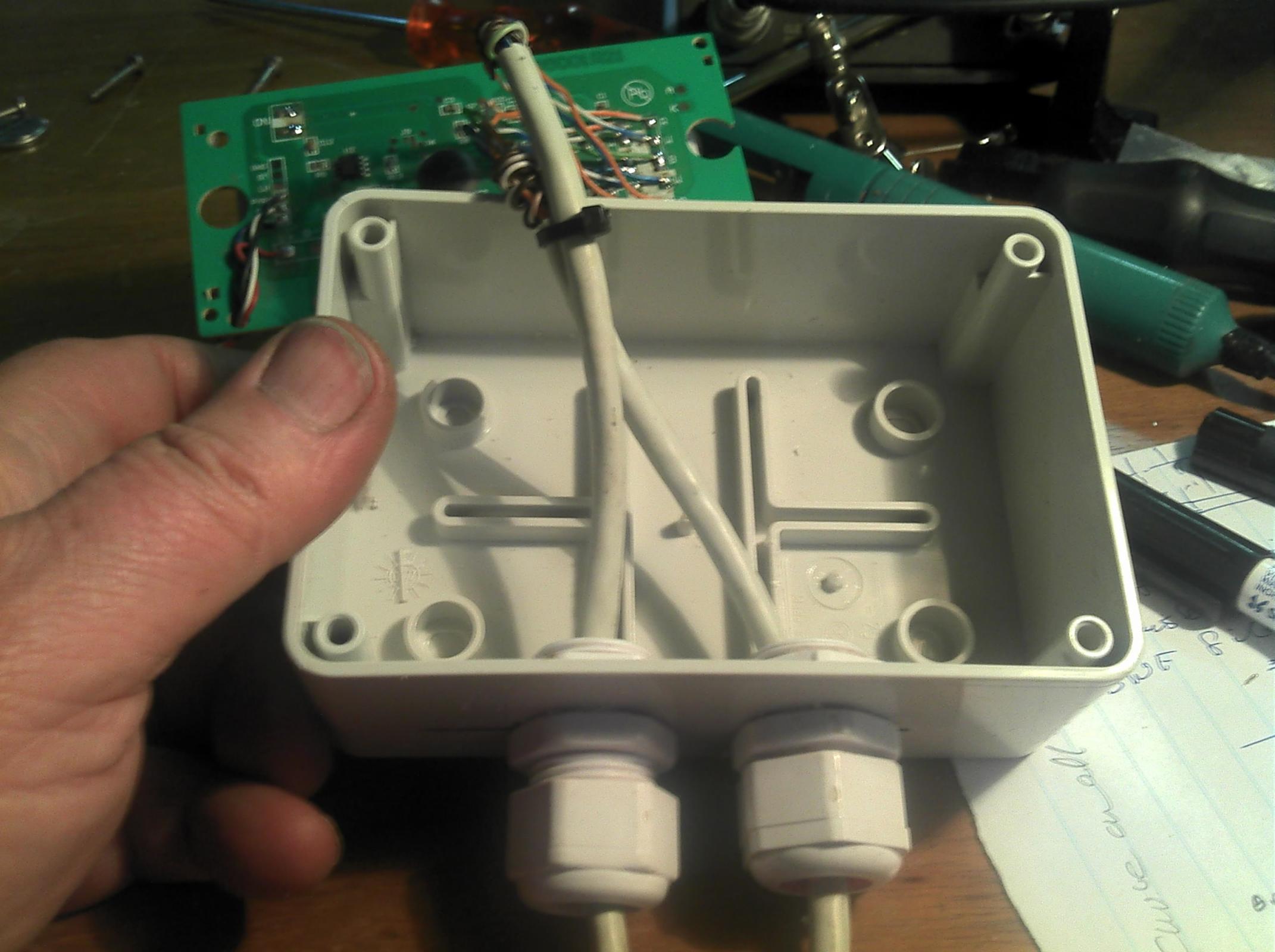

The display was mounted in an enclosure with a cut out lid and connected to the load cells in the platform, with long enough cables for it to be operated remotely. A switch and a battery pack was mounted in this enclosure and two off-cut pieces of CAT5 cables were used for the want of enough wires.
It worked out to be a huge success, accurate enough for what it was intended for and it was used for years thereafter. There was no need for milligrams accuracy as I was only interested in change of mass of the animals for record of their development.

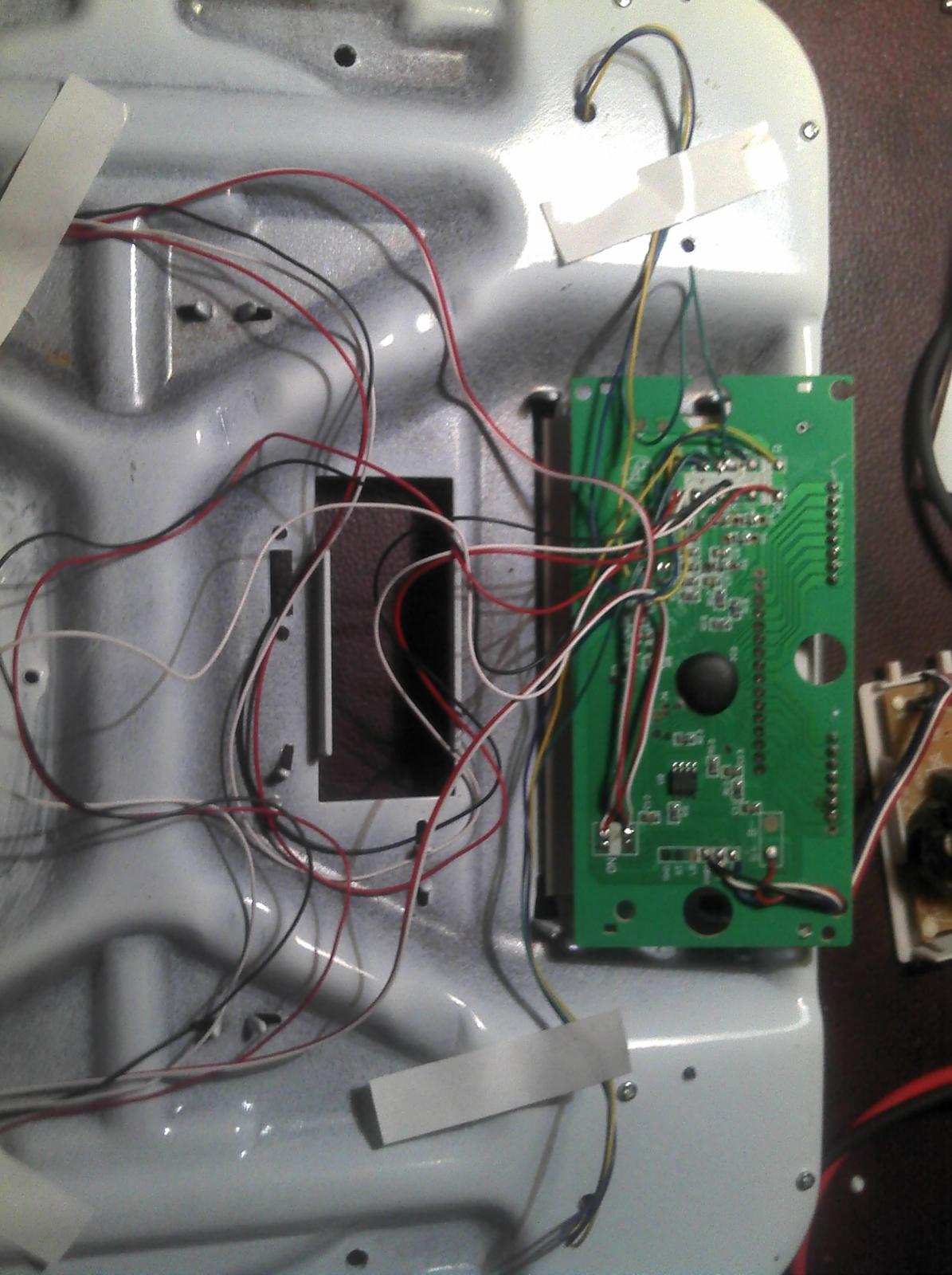

Attachment 29399
The scale opened

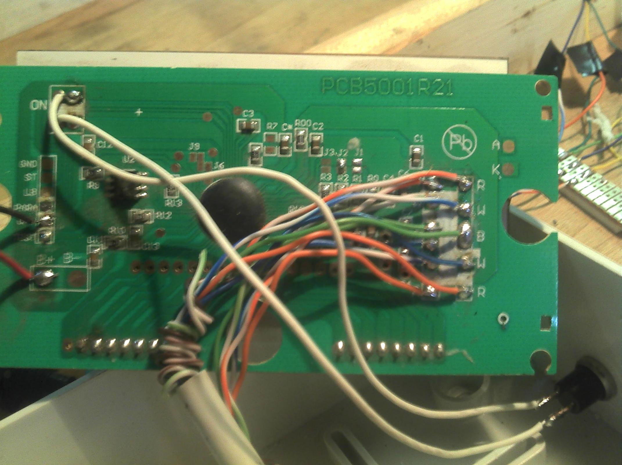

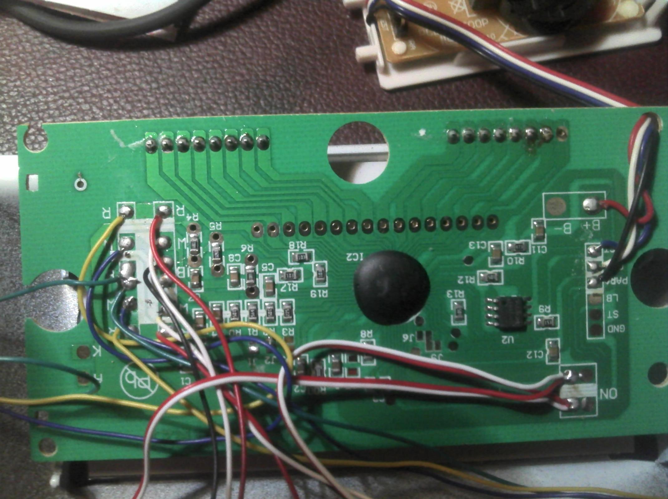

Attachment 29400
The connections well documents before removal. Load cell connections to the left, switch to the lower right and power connection to the top right.

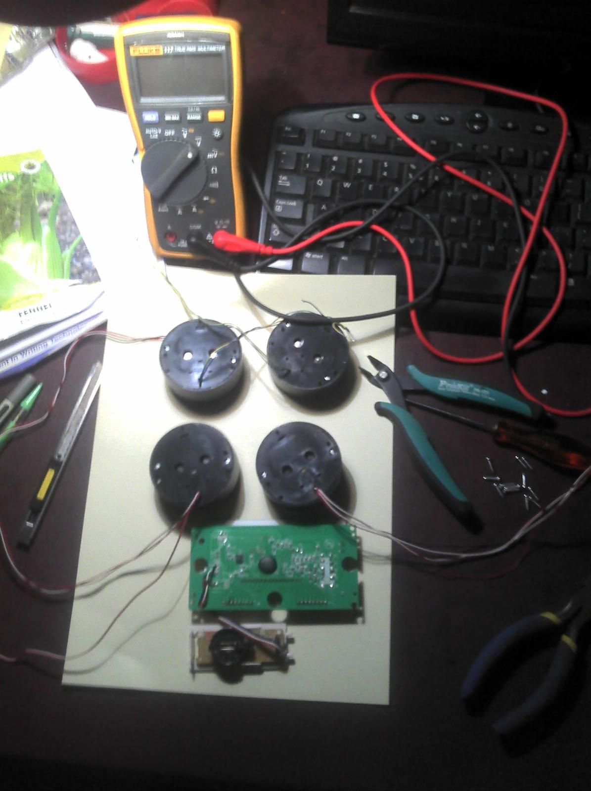

Attachment 29401
All components removed

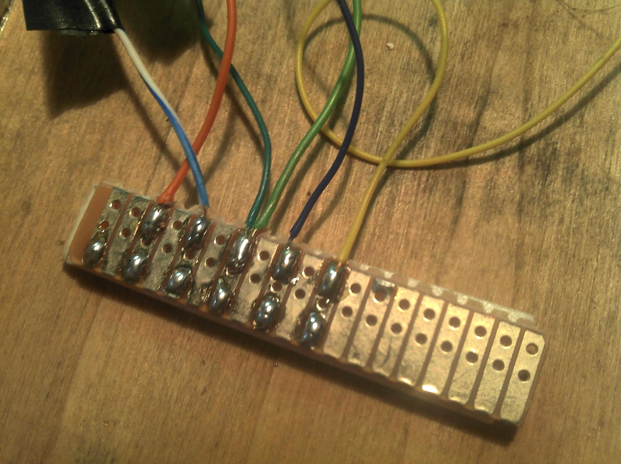

Attachment 29402Attachment 29414
The new longer cables soldered in place. Note the switch, now mounted in the side of the new enclosure is not actually a switching switch but a normally open push button that closes when pushed but opens when released.

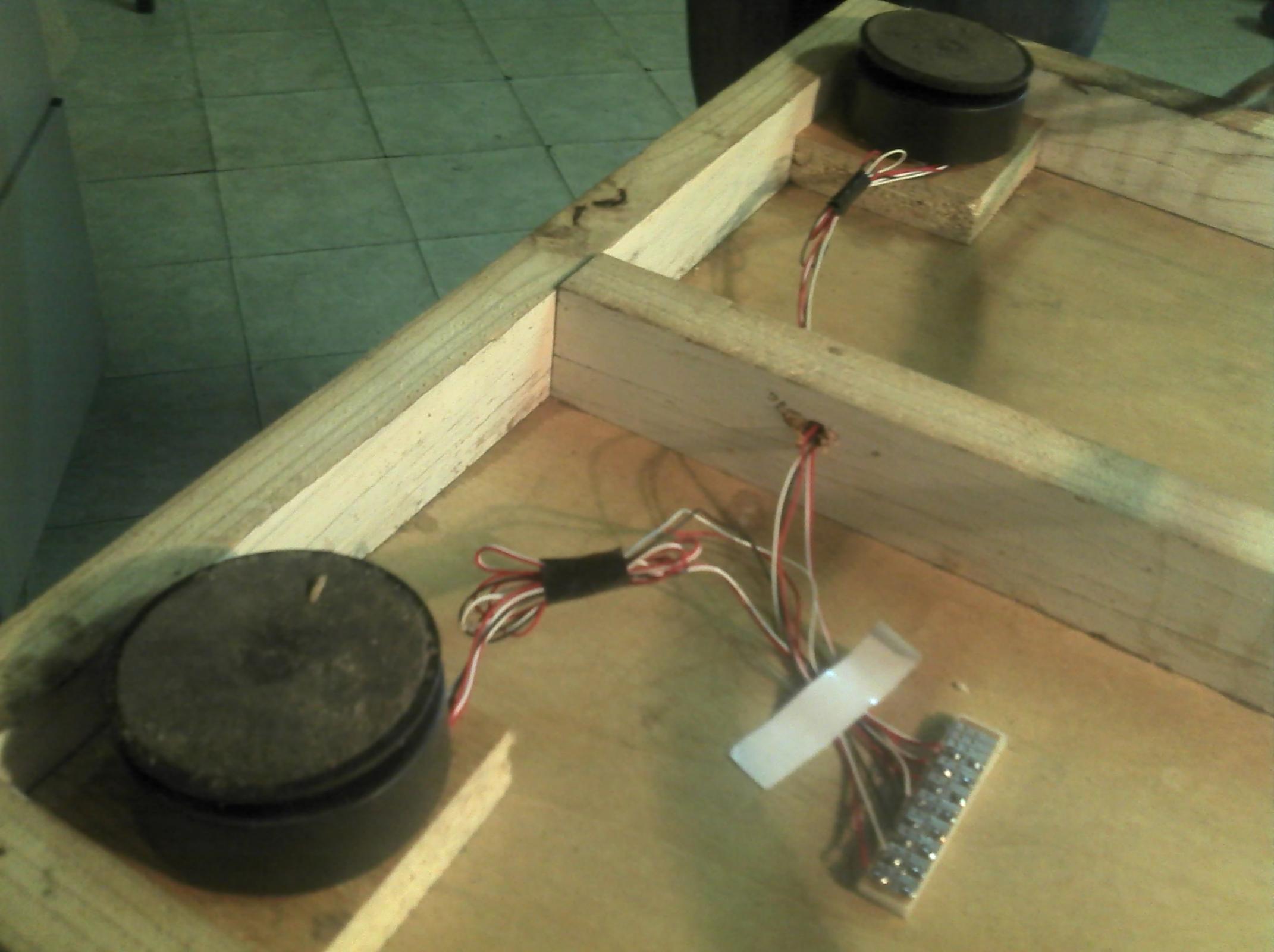

Attachment 29403
A makeshift soldering tab made from a piece of off-cut veroboard and stuck to the inside of the base with a piece mirror tape.
Attachment 29404
The load cells on spacers and in place.

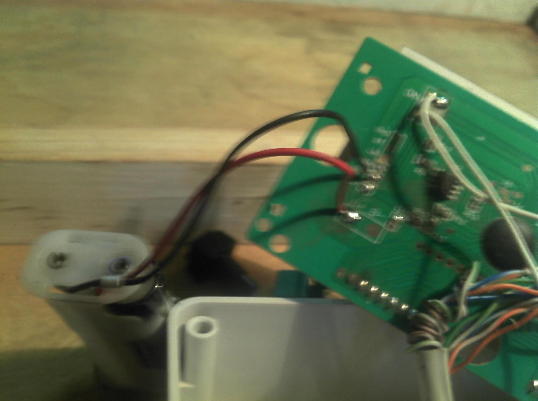

Attachment 29405
The battery pack is the last item to be installed. (sorry for the bad focus as these pictures were never meant to be for an instructable)

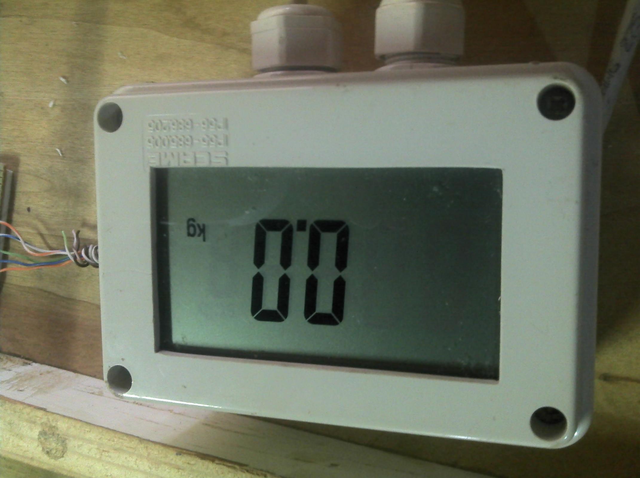

Attachment 29406Attachment 29407
Power on!

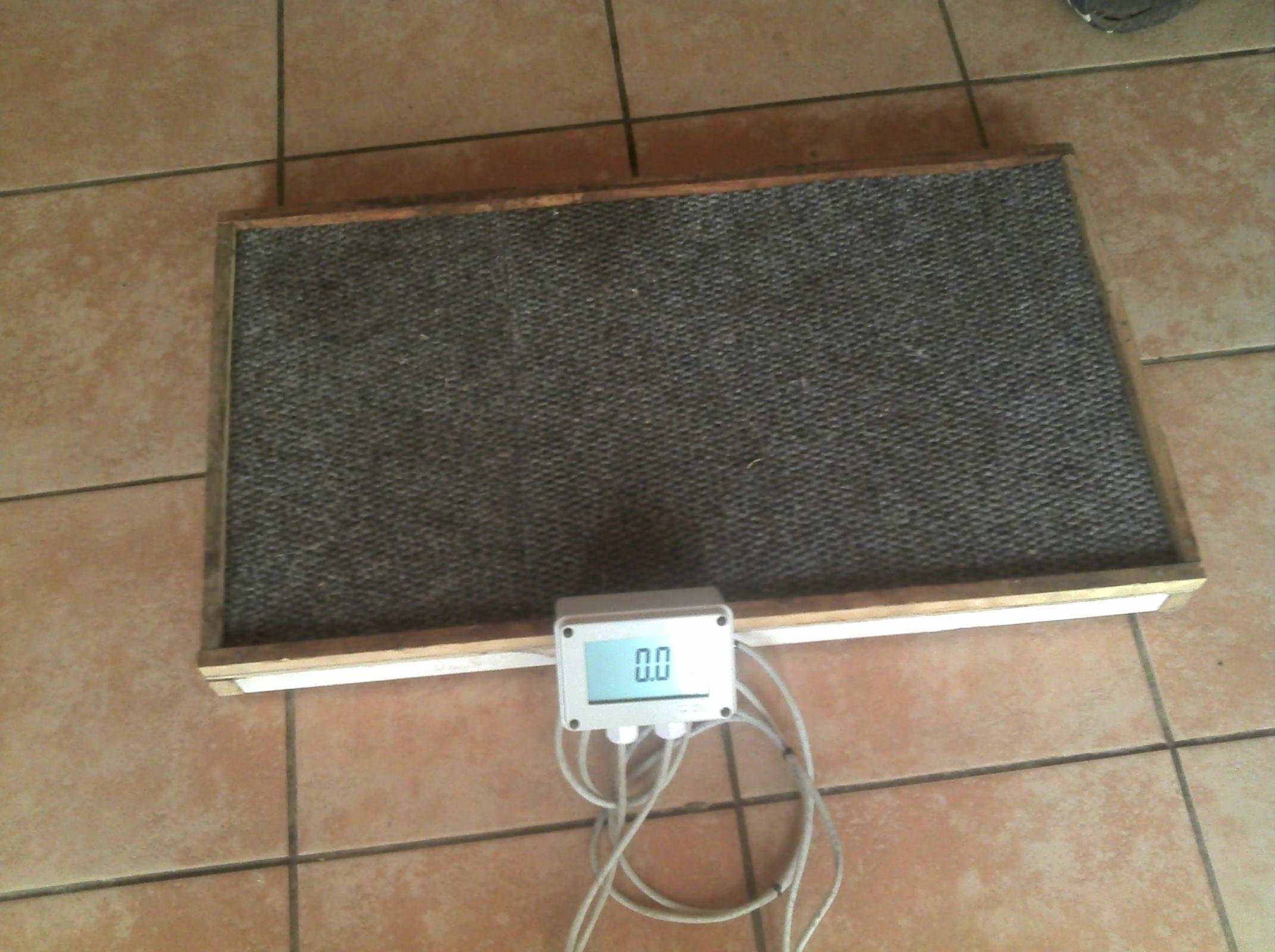

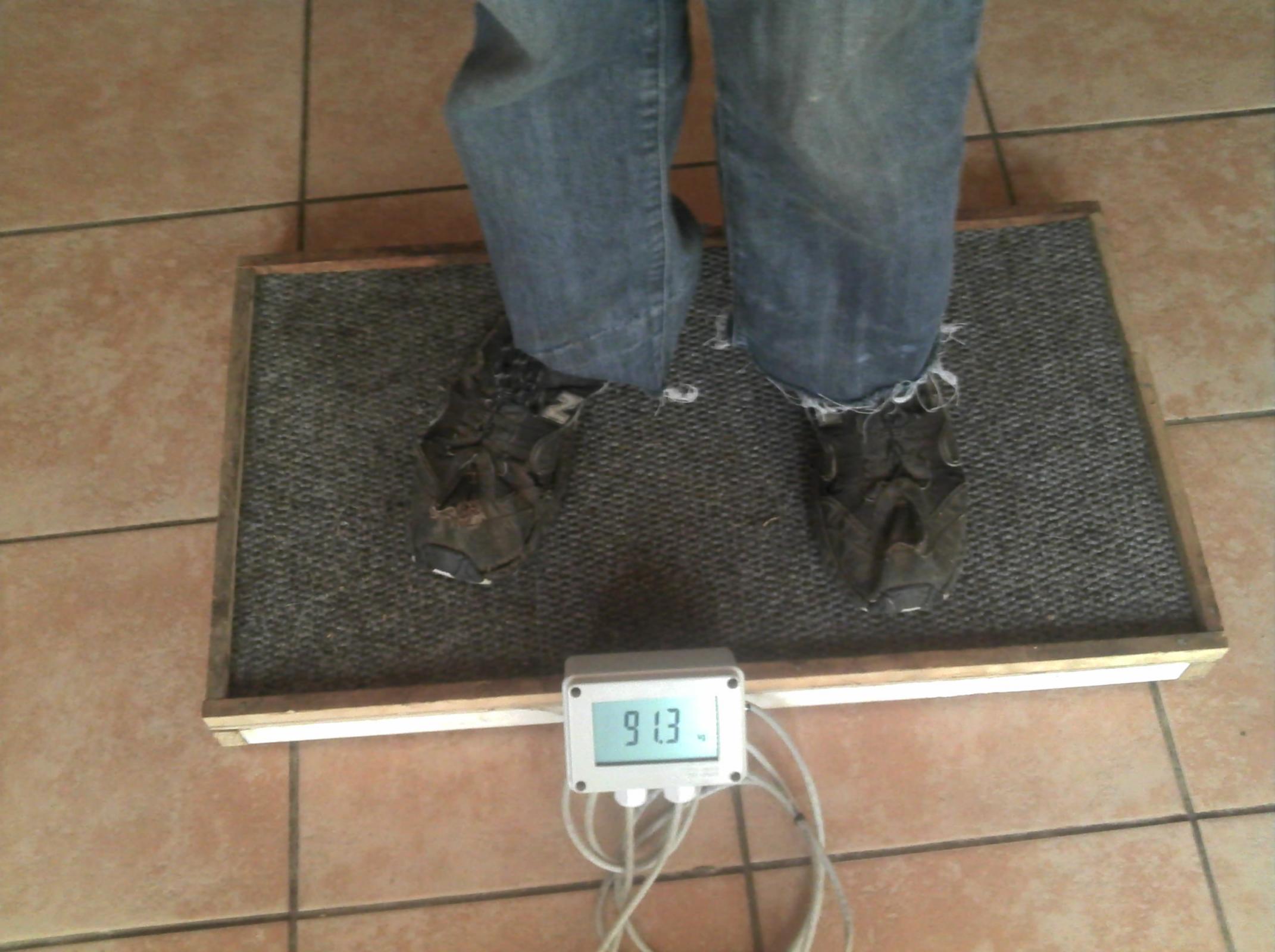

Attachment 29408
Something added to prevent slipping.
Attachment 29409
Exactly right!
