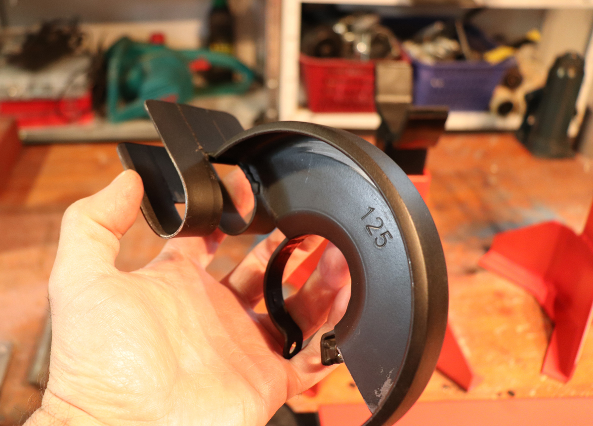

Simple add that makes using angle grinder more accurate. ( and maybe safer )

Thanks.
Best thing is that its very simple to make and use.
That also makes it little "lame", no cool adjustments or stoppers / guides.
Personally i think that this version is much better than my first version about the angle grinder cutting guide, that i posted here some years ago.
This keeps cut off wheel in optimal angle / depth, then cutting is done in most balanced "7-8 o'clock" section of the wheel.
It doesn't need to be removed when grinding / sanding, light weighted...

How many guys bobble parting when using cut-off wheels? This 'shoe' works surprising well, I'd think anybody could improve their cuts with one.
Compared to a circular saw [which cut from below], the shoe is critical, being a climb cut. Tuomas's guide achieves same result, stabilizing down pressure on the material.

This was the first version of it. Made just for pipe, axle and threaded rod cutting.
It has guides on both sides, that makes it more accurate on that task. But then it blocks other uses of the grinder.
