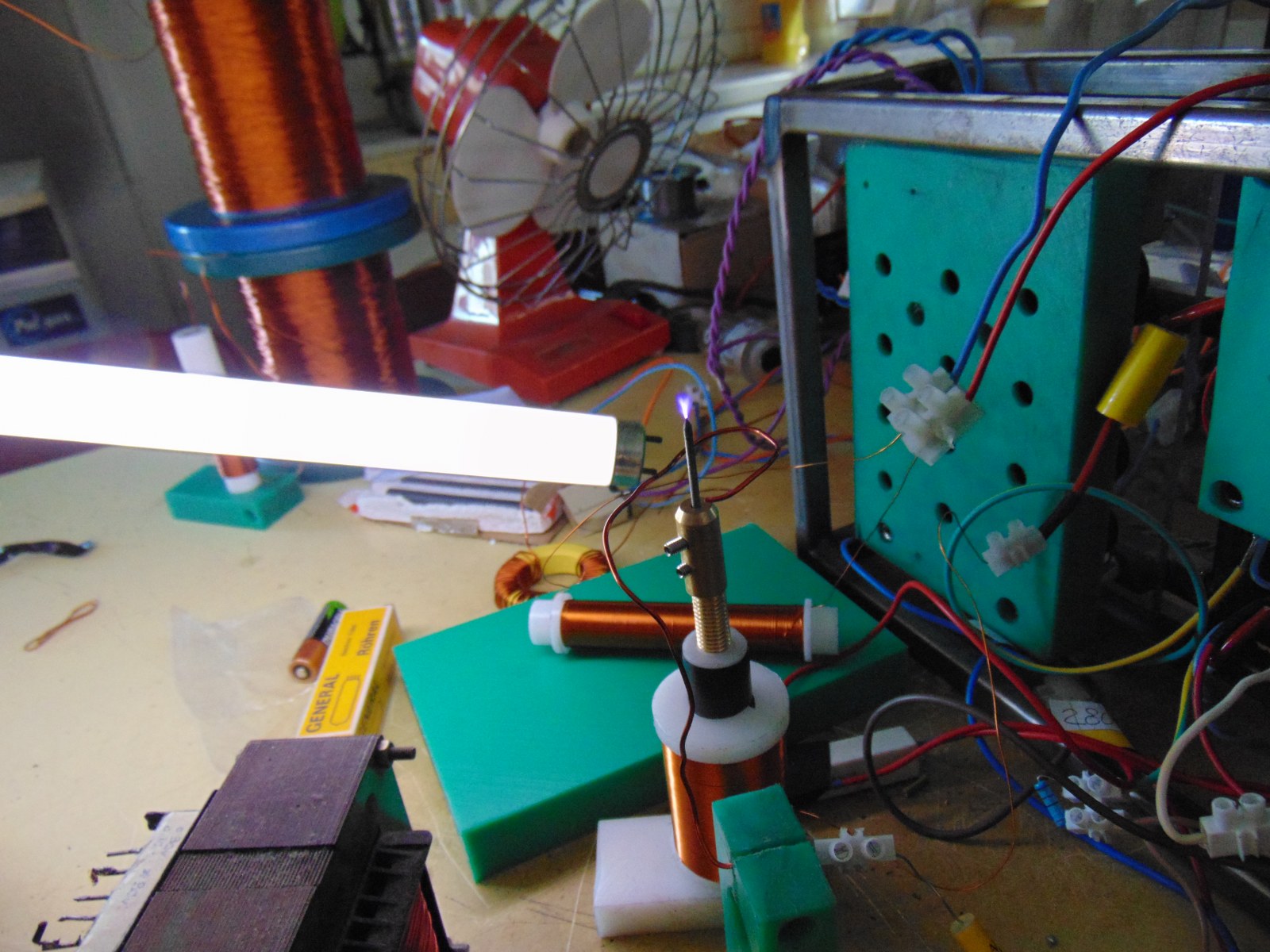

10 Attachment(s)

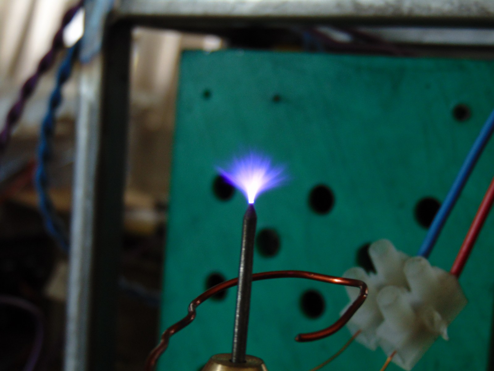

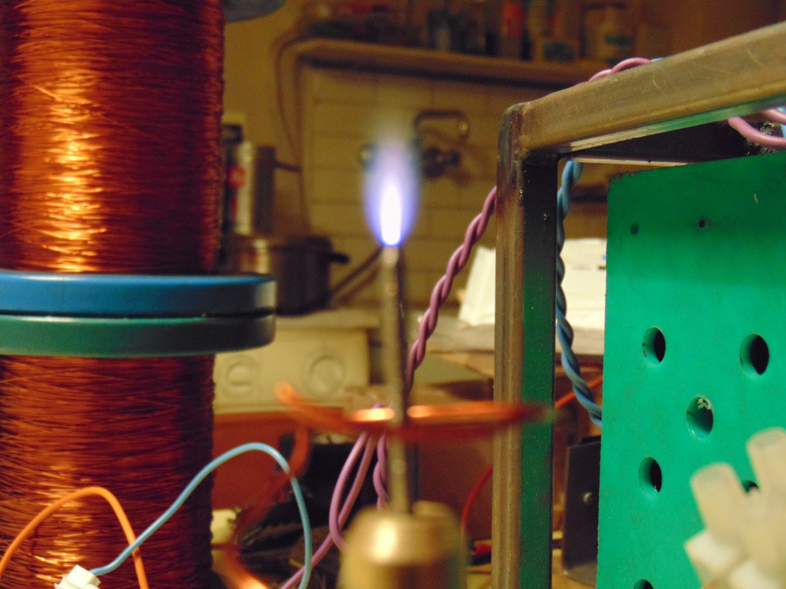

Hi!
Big update tonight

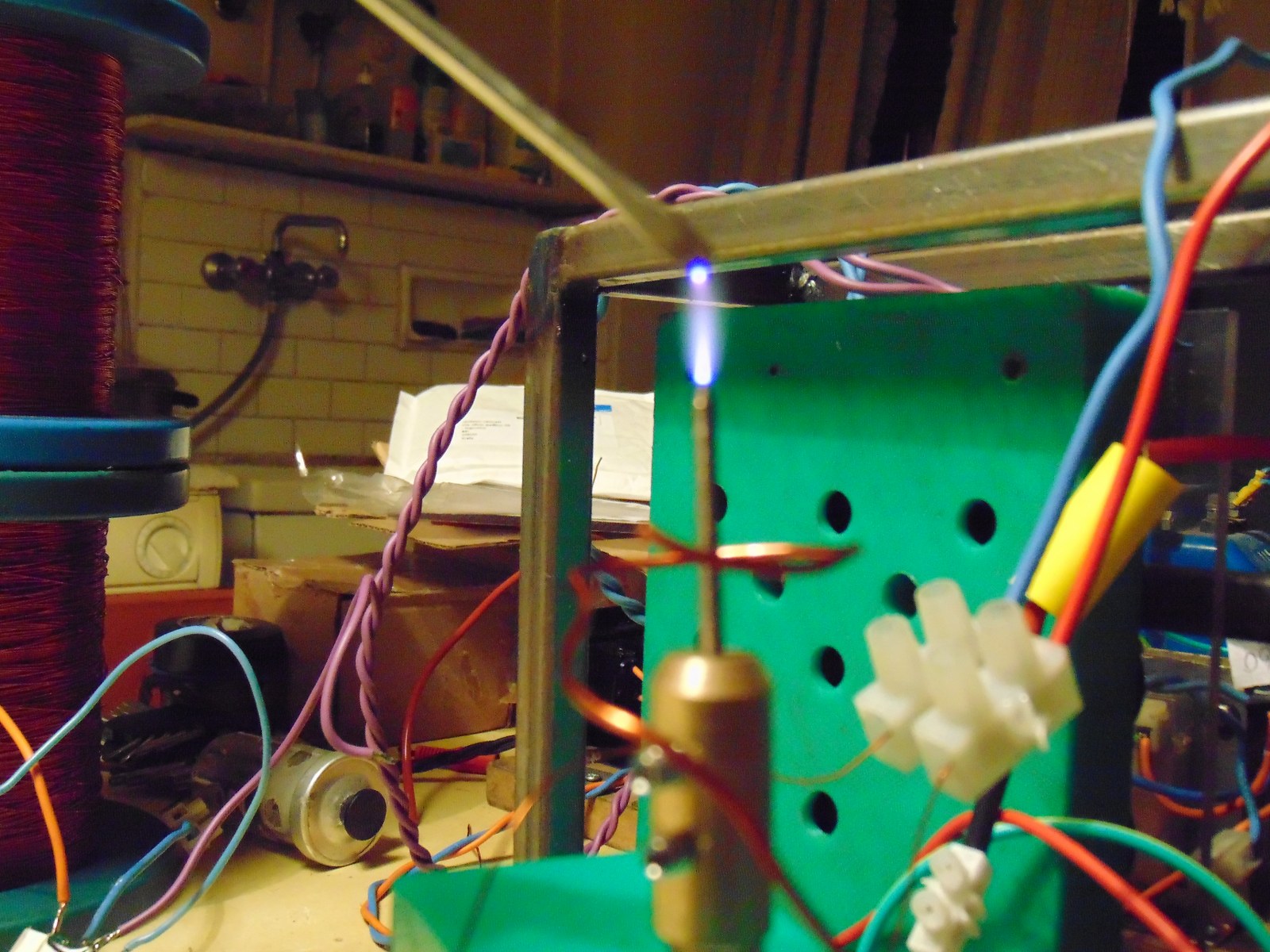

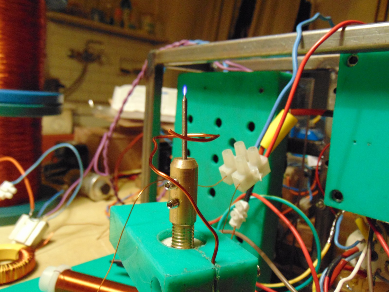

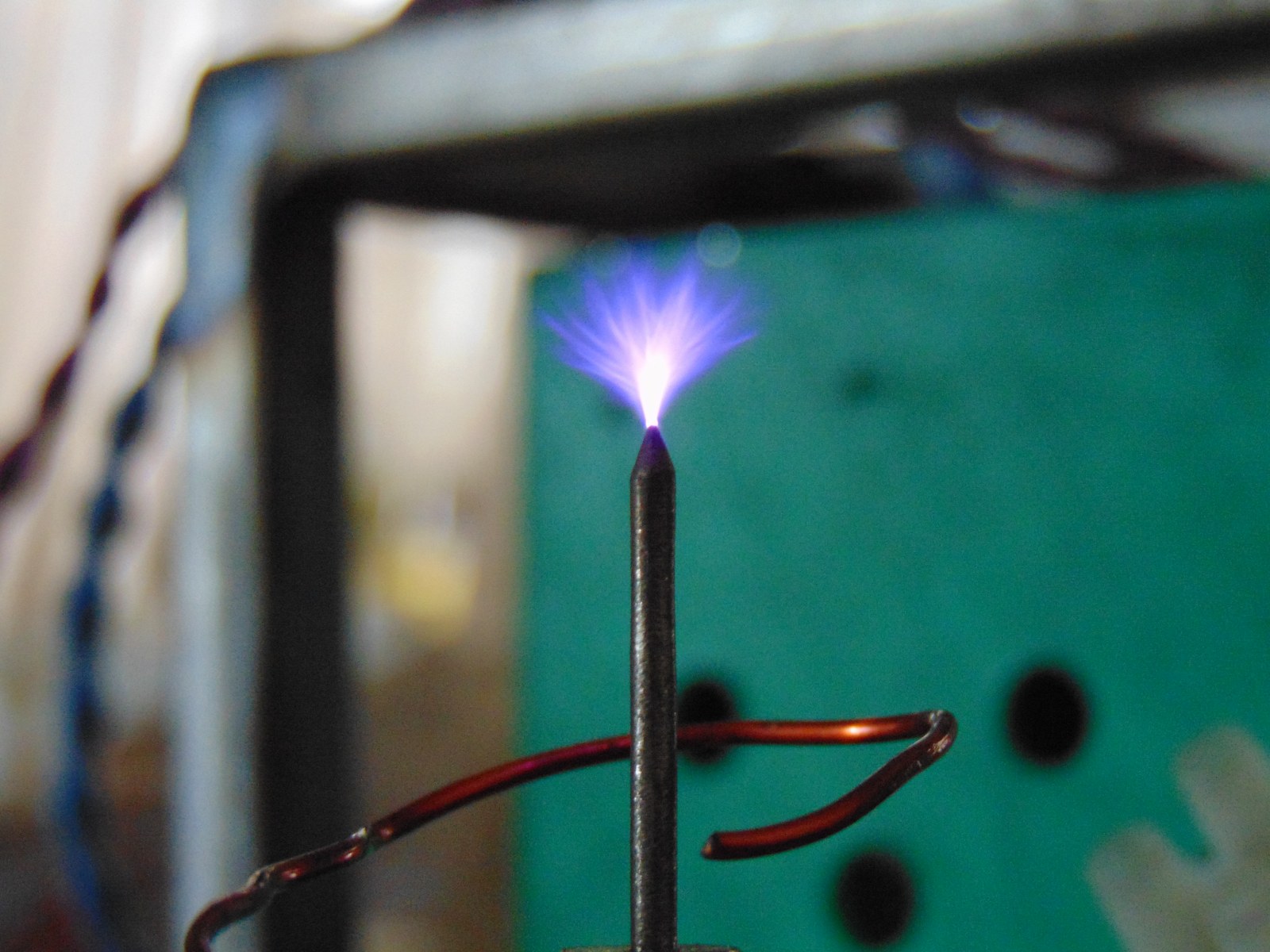

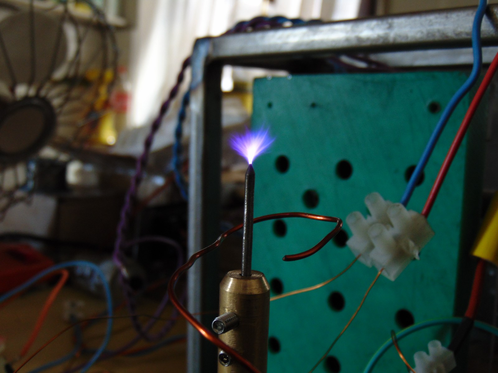

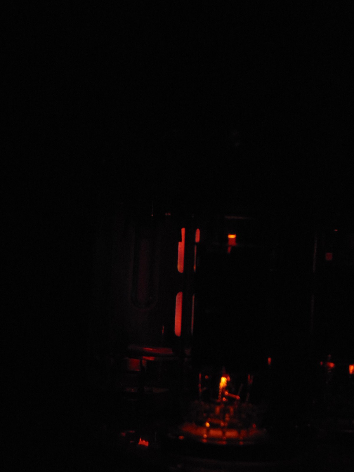

The new coil is running better than others! Full gas flame it's a little bigger now, but the main thing is that now lowest flame possibile (with closed potentiometer) is stable and is +/- 6mm after warmup. Tube oscillates better, less heat till 150ma, after grid become red, but it's good, in this conditions it's 70v over maximum rating. I need the measurement tools to drop a line, but I'm happy to see that I'm on the right side now, even if there's a lot of work to do! An other good thing is that power supply make less noise and coils runs colder.

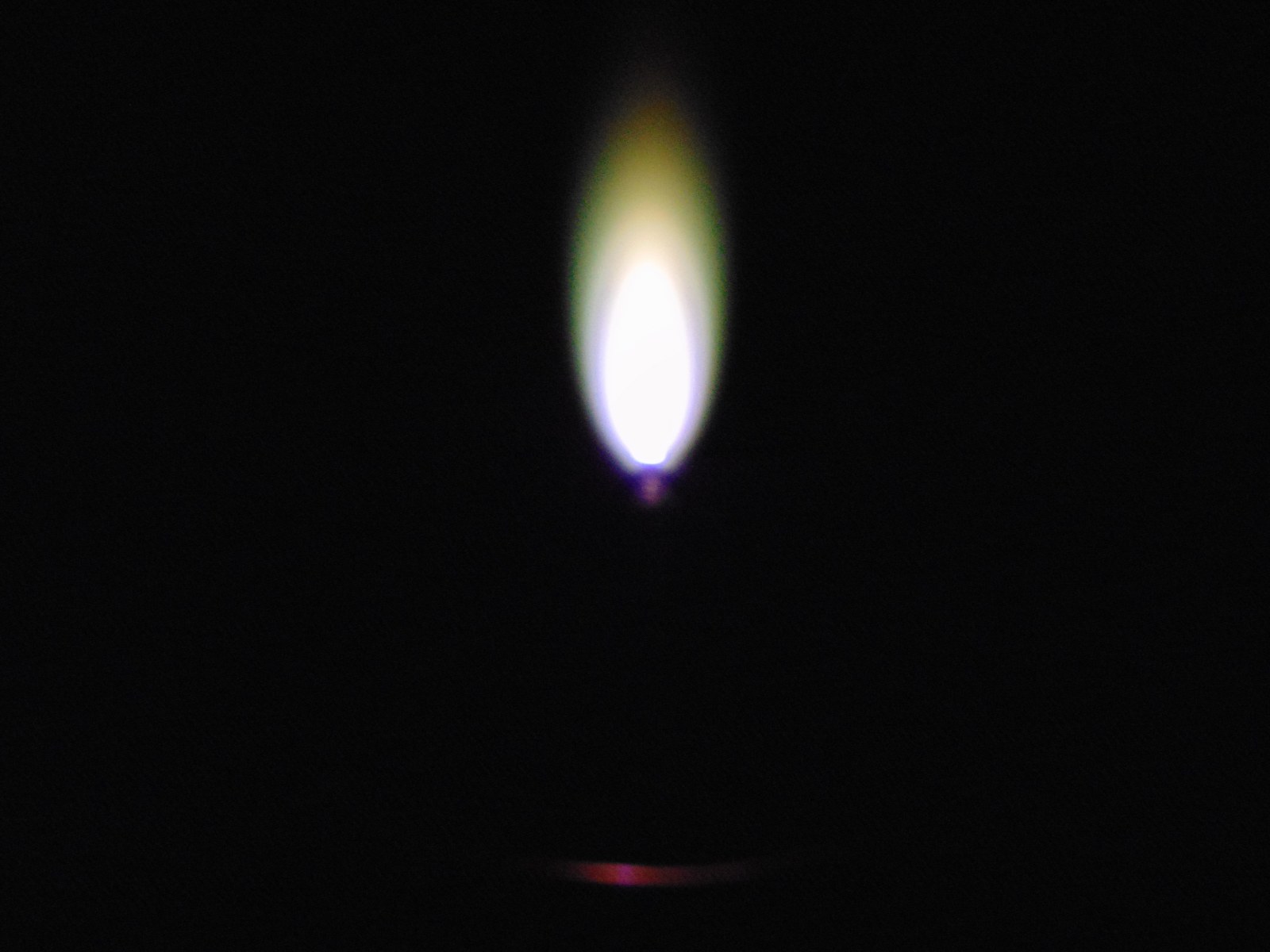

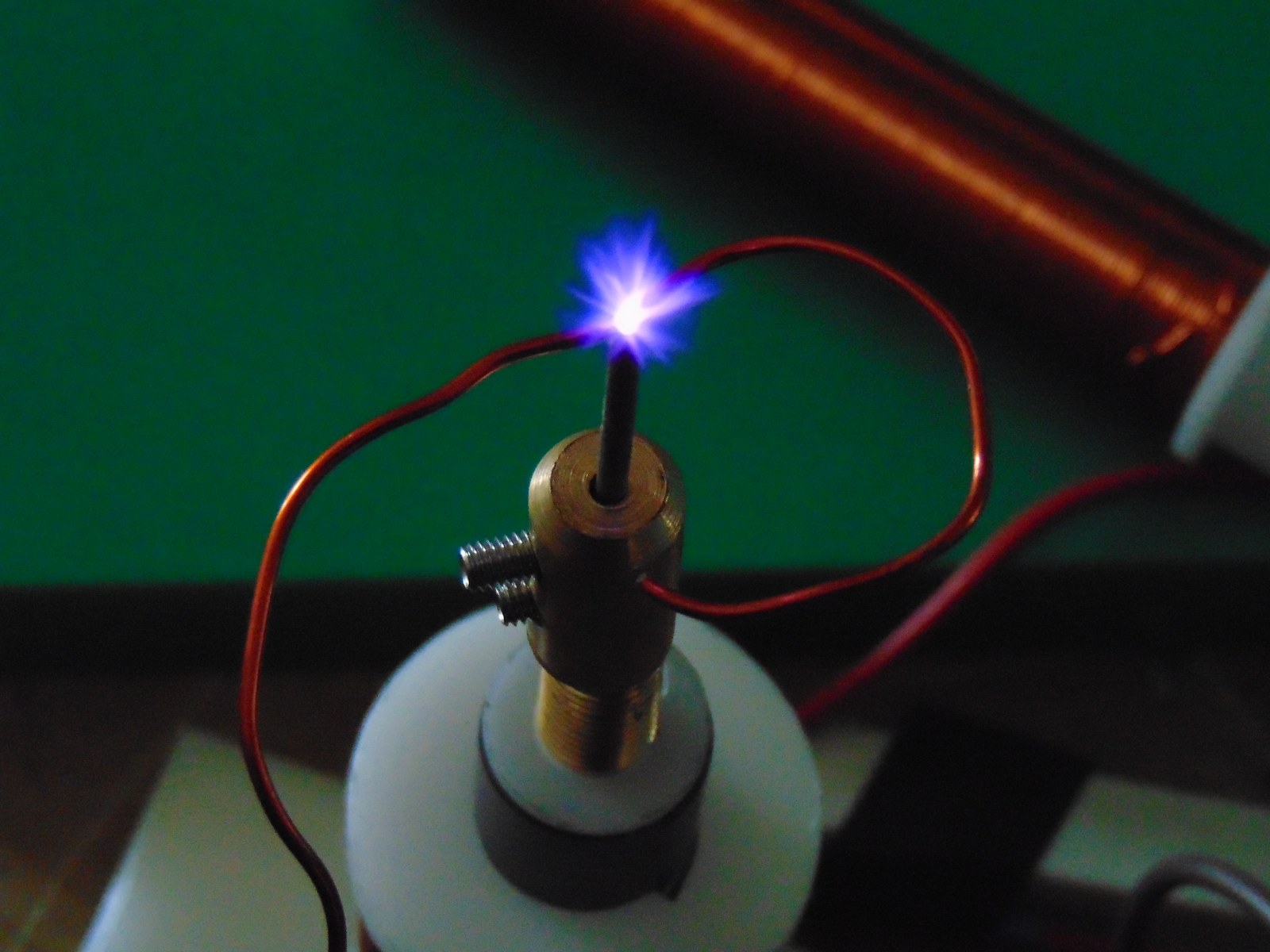

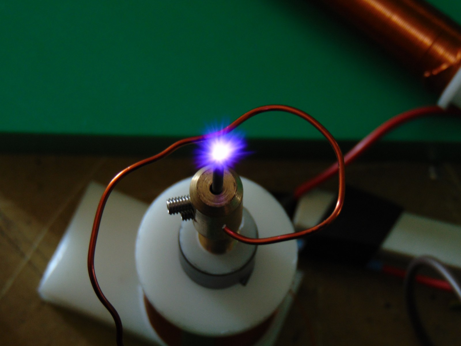

Got a question for you, I noticed a change in flame color, till 1cm +/- it's a bright purple, when I push the limit flame becomes white, not only in the flake (idk the correct name, it's the outside of flame) but even the dart is clearer. Actually I don't know if it's matter of power, or maybe some frequency change. Next days I will try to vary the tuning freq, Hope measurement instruments will arrive soon! I need to know at which frequency the oscillator is running.

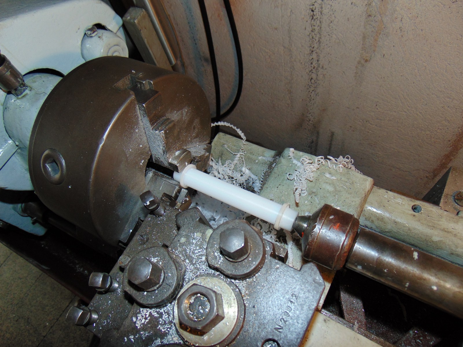

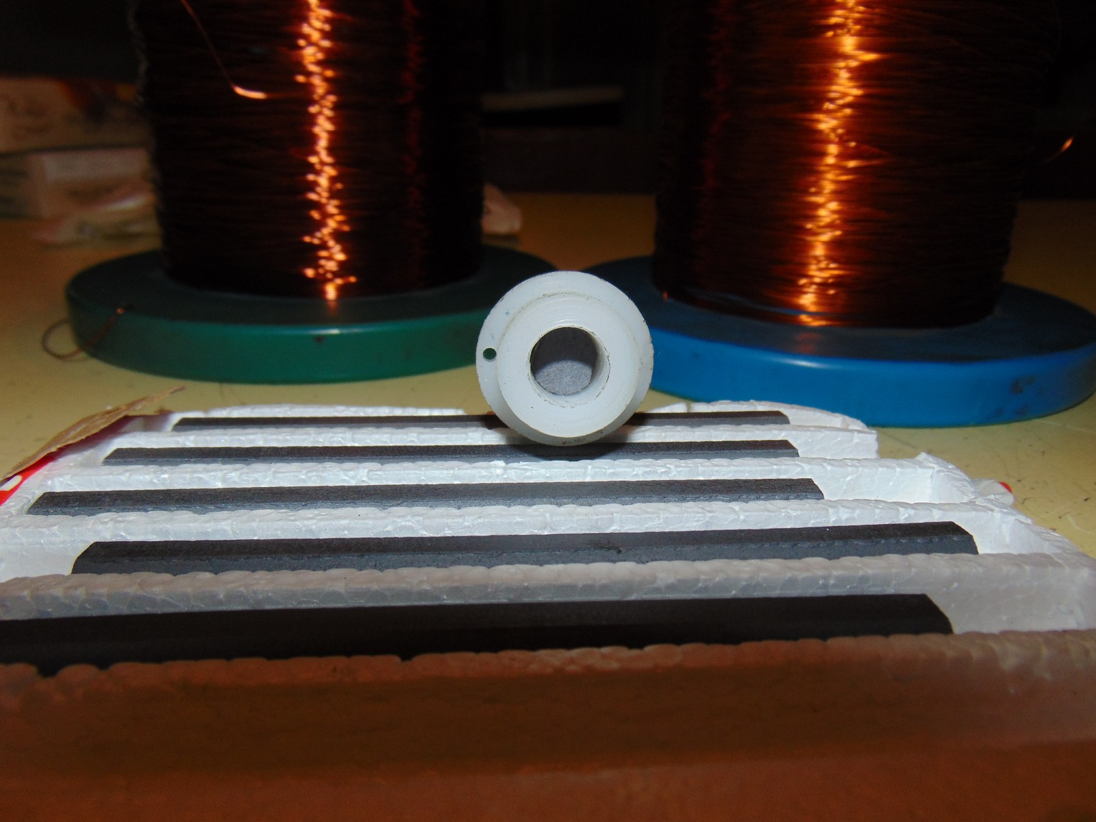

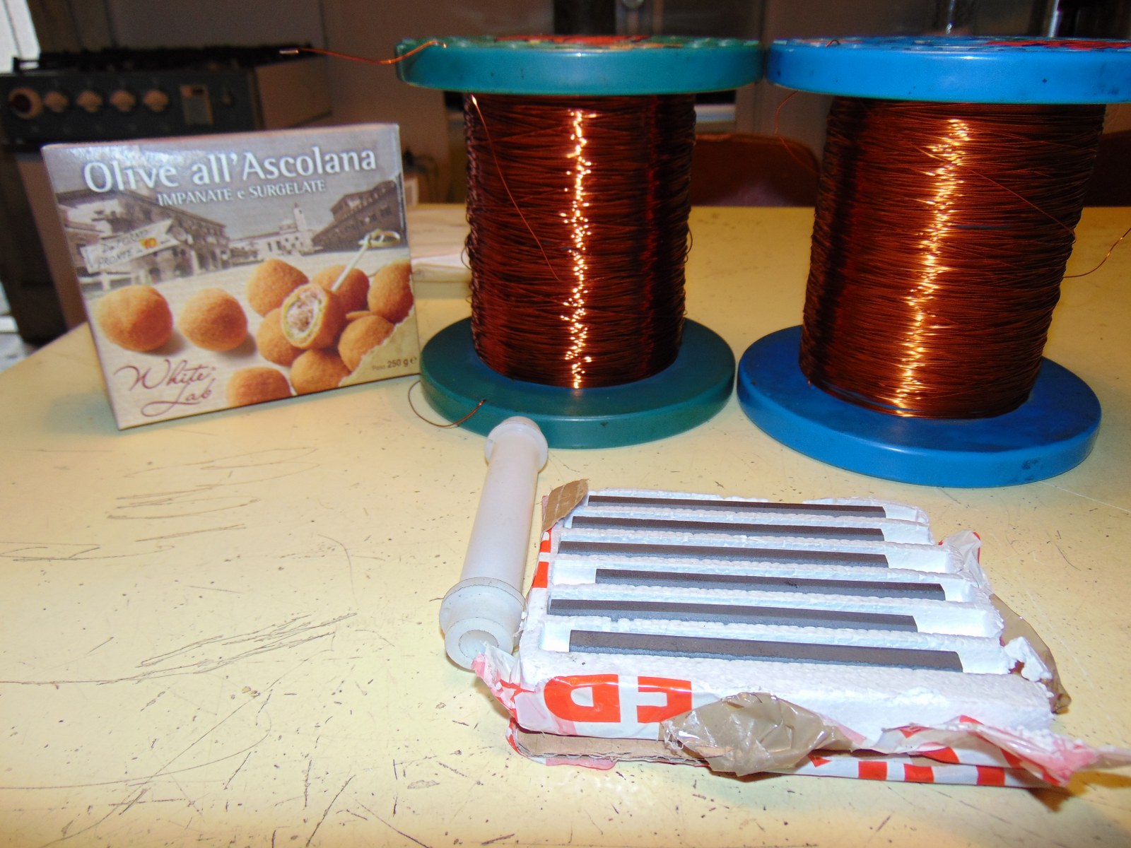

making of the new coil
Attachment 9878 Attachment 9879 Attachment 9880
play with flame, the last picture is the minimum new flame at full closed potentiometer
Attachment 9882 Attachment 9883 Attachment 9884
Attachment 9885 Attachment 9886 Attachment 9887

Looks like you are getting a pretty good corona now, small and tight! Nice Going!! Good your power supply and coils aren't straining (humming) now. Hopefully your new instruments will help answer some questions for you about frequency/power etc.
Not sure about your question but think you are questioning/witnessing the oxidation of the atmosphere with the larger white flame/corona from more power being applied (picture 6)? It may also be some oxidation of your needle as the picture has some yellowing out toward the edge. Forgot what material but seem to remember tungsten alloy for your tip??
Question for you. I can't tell from the pictures but have you moved the 3/4T coil up and down slightly?
Thanks for the update, nice progress. ~PJ

you're right, the tungsten rod shows some oxidation, I can try grinding the tip in order to see if something change, maybe the flame can oxidize the tip continuously during operation? I remember old chemical exp with copper sulfate and flame, it can be something similar in fact
I tried different position and different capacitor + resistor of the 3\4 reaction loop. separate discussion for components, because they change with main coil, i adjust the position of this loop with neon tube. There's a range of half inch about in which the strenght of the field is stronger, using neon tube it's pretty easy to locate the best position :)
I see another good thing with the new tuning, semi faraday gage is still helpful, but the negative interaction with the environment is decreased, as temperature of coils and even temp of power transformer. For sure it drains less current relating flame size. Excepts for overdrive, datasheet of tube said maximum operation value of 250v, at this driving voltage i got 130ma at flame, with great size.
I'm going to make some modifications on circuit, hope to got some news in few hours :D

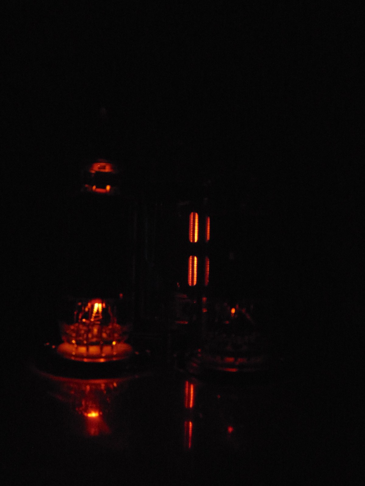

This evening I tried some experiments with audio, for sure strange things happened! Got huge troubles with some audio tube connection, maybe due to oxidation of pcl82 socket, then terrible Gnd hum and buzz from flame. I tried different things, the big problem was m6 inox allen plus nut close to reaction ring, it's a couple of week that I see strange behavior of that component. I remove the part and the flame starts oscillating good with no hum sound. Impressive? This circuit is really bastard inside!
Few things about video, the cam is a china gopro, sound is not good, audio tape is really old and walkman has poor output (i tried with my Lm3886 amp of 15"sub , very low output). There is a lot of work to do, sound is pretty good! i'm not sure about xover filter at imput of plasma, i think I'll remove soon. Volume is not so bad with 110\120ma flame, more or less gasoline gives few changes in spl, I found the best position with this value. Got some bad rumor about audio first stage, pentode loading resistor 20w ceramic type runs pretty high temperature during operation, it's barely touchable with finger (I got trained welding fingers :D ), imho this huge amount of heat can be avoid using a output transformer, maybe some more power can be achieved! It's early to speak about, but my impression is that amplifier is not enough, maybe it needs more then a small pcl82 pentode to run well, or more likely I have to optimize the final circuit and then think to audio part. The good news is that the coils are cold, but the B+ anode transformer after 3 hours of game is something about 60° , like a normal tube amp +/-
