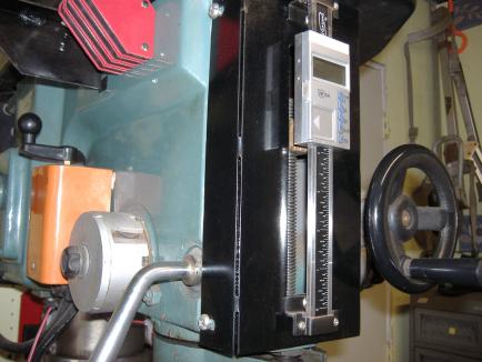

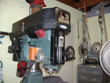

I hope I'm not hyjacking or belaboring the point, but I was trying to think of a pic of my trick for the plasma cutter and the only piece I have in the garage is the cover I made for the front of my mill/drill. I put a digital readout on the z axis and needed to replace the old plastic cover so I plasma cut this. I hope it will demonstrate what I was trying to describe. I first came up with this when I was having to make chain guards for belt drives in the packing houses I worked in. None of them had breaks either so this is how I got around it. It is that black cover and look close at the edge of the cover where the cut is, and the 1" "breaks" in the cut.

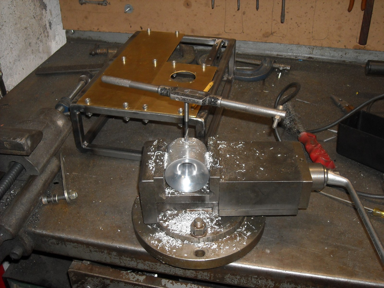

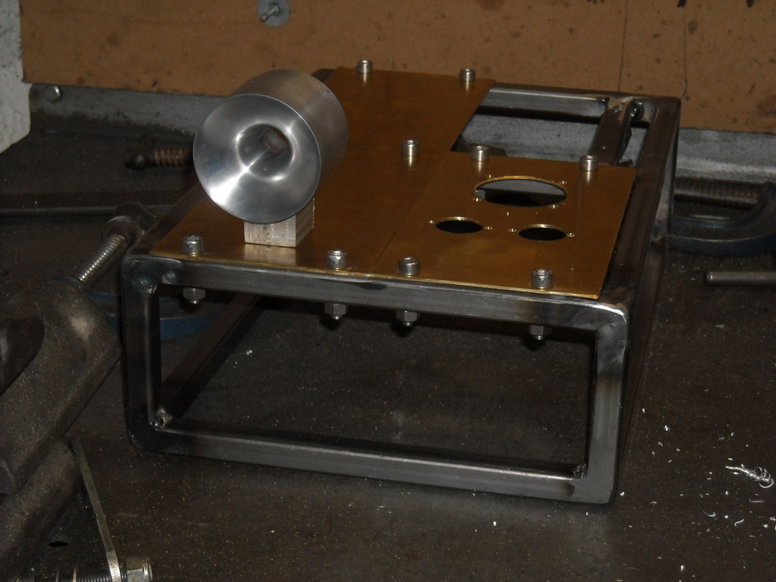

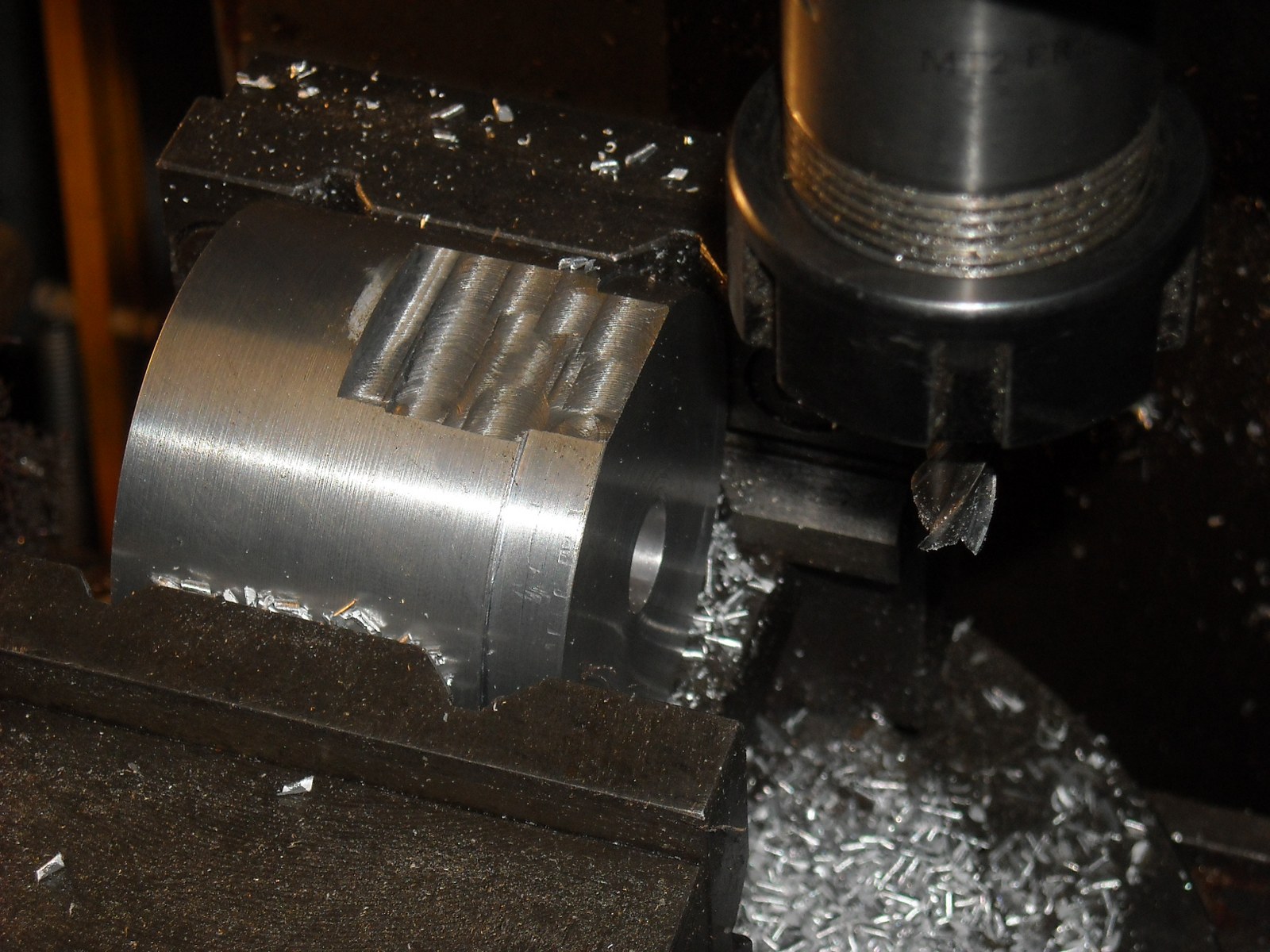

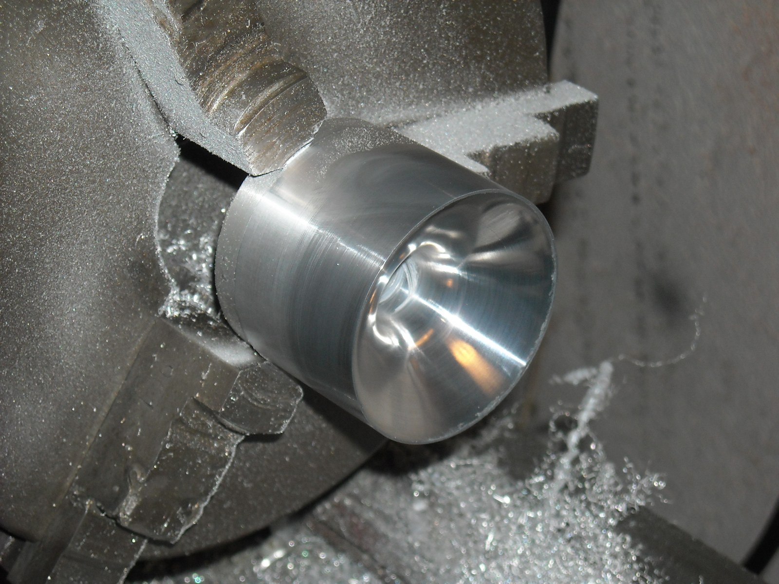

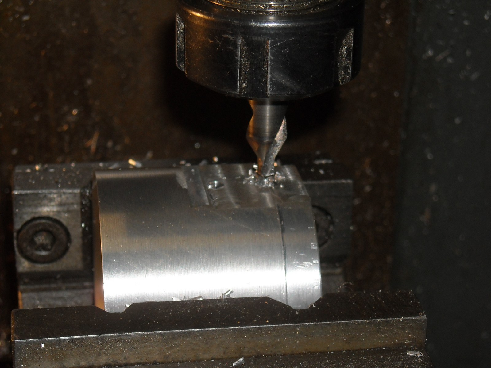

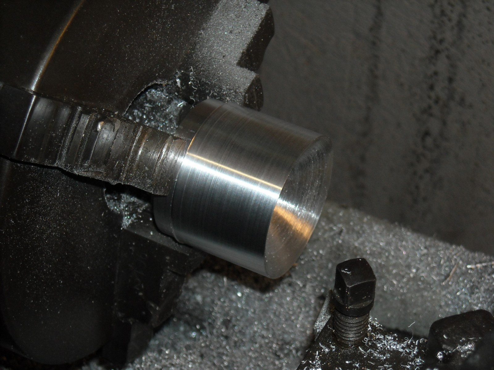

Update of today, i make some more drill, and the tiny horn for plasma! 58mm, ergal i suppose, it do flakes not chip, a bit more bright than the last aluminum. I try my best to polish, but with 10mm of throat is really hard to enter... same old problem :D
I pressed a cloth with force this time, polished enough i think!
Attachment 8386Attachment 8387Attachment 8388Attachment 8389Attachment 8390Attachment 8391
very nice done on milling! thanks for the pics, my eng isn't so good and of the last post i understood not every points. with this pics it's clear now that you cut this lines and leave short full metal parts for bending better!

Yes, sorry Stefano, I realized even English speakers probably didn't have any idea what I was talking about. Pix are better. :)

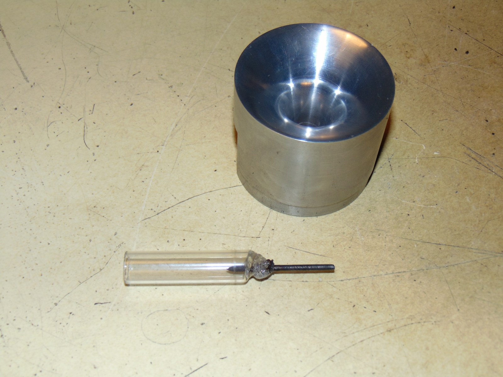

I hate this glass! If anyone knows how to model and to cut is welcome!

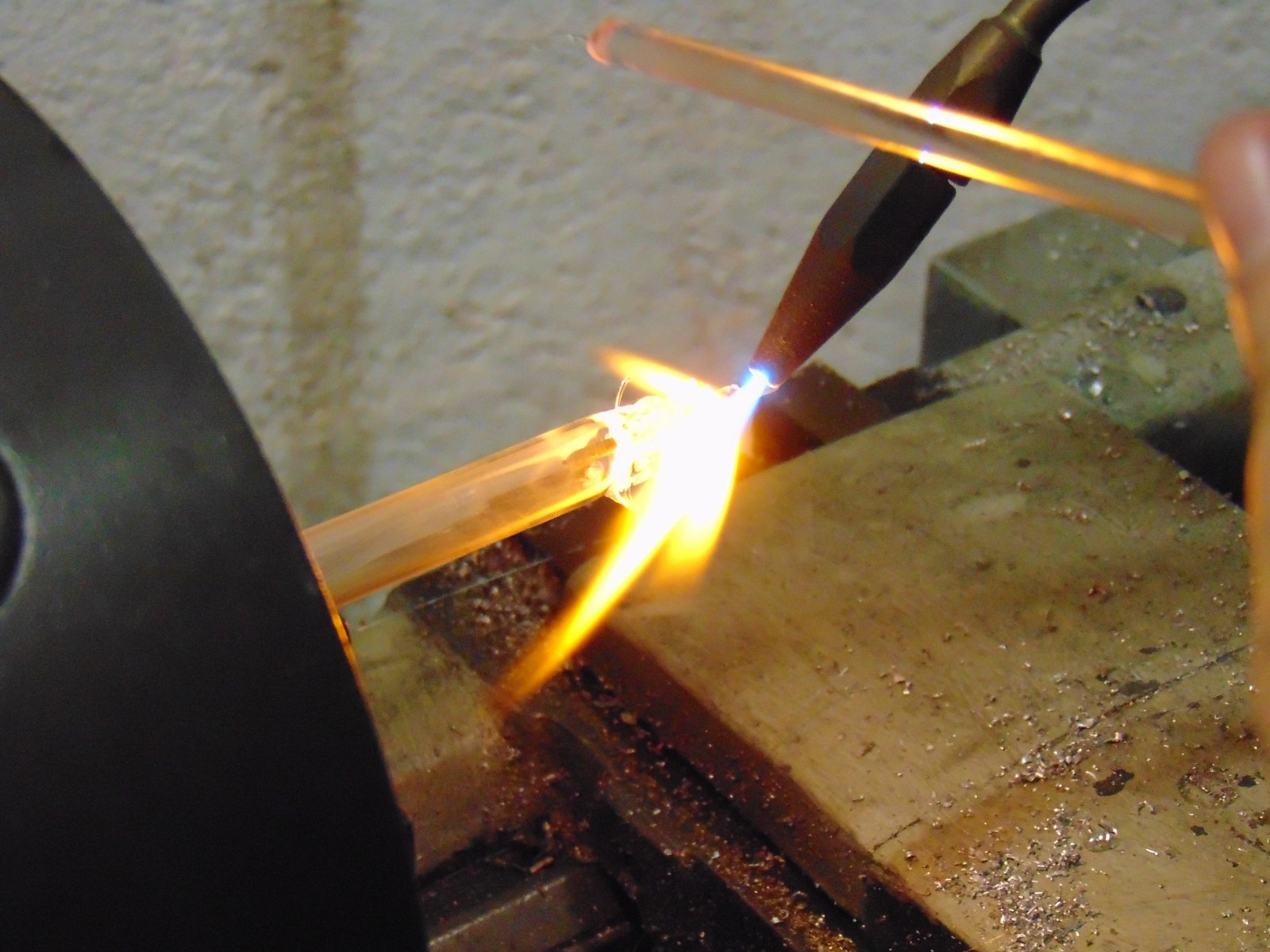

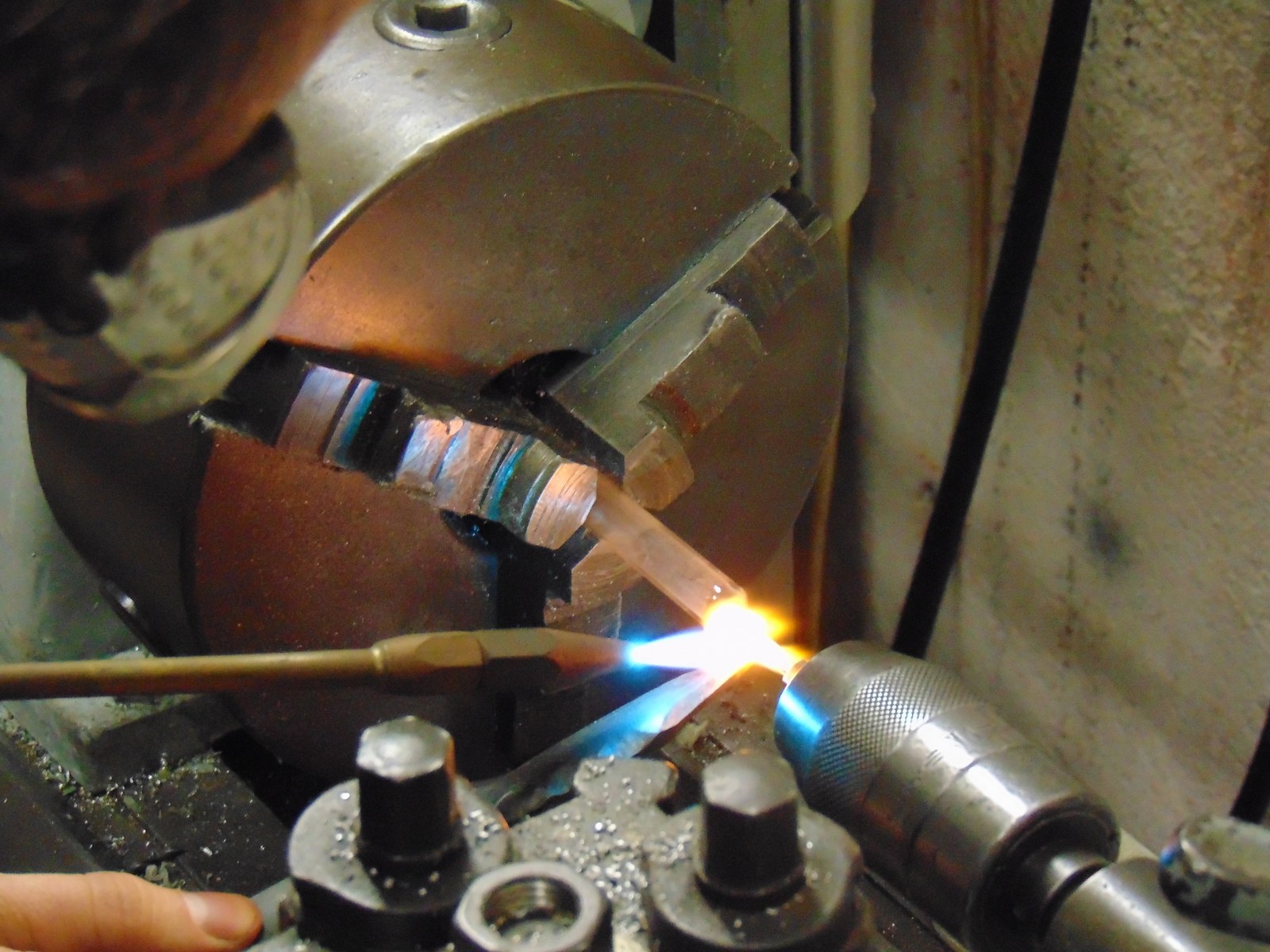

the "big" tube is a 12mm dia, 1mm thick, inside a small ugly 4mm with 0.8mm. For my actual knowledge it's impossibile to cut, when hot it melts,but not liquefy. I tried rich acetylene, normal and full oxidising flame, but no great results. I tried also to keep a 6mm rod as "filler metal" , it sticks, but the chambers broke in 2 :flame:
At ending I made a "chamber", ugly as hell, a bad work! i tried keep on lathe the 2 parts to weld, when i free the tailstock for rotating the chuck and levelling the filler, the glass melted and keep off axis the tungsten rod ...
Grinding machine makes flakes of glass and do disaster. sand paper give some better results , but nothing of good at all...
I have to think a better way to make a nice and replicable part. I have also doubts about the effectiveness of the thin glass chamber, can be good for ozone, but imho as horn chamber is completely unuseful...
I'm thinking if it possible to liquefy the glass into a mold, with aluminum or brass, or even iron can be easy to do a good shape... the problem is how to melt... this bastard pyrex glass melt at high temperature...

I havn't glass blower or furnace-forge, i had a small only propane tank with short blower for tar and tin, but without oxigen I think it's not possible to reach temperature of 1500°C, working temp should be 820°C.
I'm thinking to make an internal template on lathe, maybe in aluminum or brass (or iron) and then drip melted glass over the 2 joined tube to give greater thickness ...
the good new is that after the polishing of the tube smal panel, i can try to weld circuit!
I agree you need lots of different skills for these projects and maybe a reality show is in order! :lol: Another approach you might try with the pyrex is to use the setup you did but instead of trying to liquefy the glass, get it to yellow and crimp it to the tungsten electrode with maybe a modified pair of old pliers? You'll need a crimp diameter about a 1/2mm larger than the rod. It should seal to the tungsten and might not create a "leakage" issue??
As I remember cutting pyrex tube is done by scoring the glass with a diamond then tapping it to break it off. Looking forward to the next episode! Thanks, ~PJ
