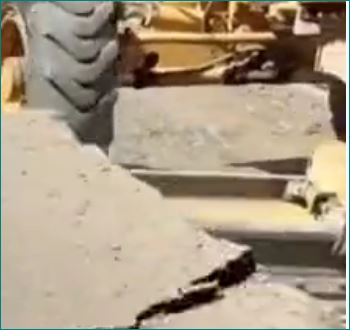

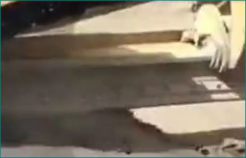

Attachment 44931 Attachment 44932

I believe that video shows Asphalt Concrete pavement being removed. This paving material, commonly called asphalt in the USA, is made from bitumen (the glue) and aggregate (gravel). It is a relatively flexible material especially in warm weather. If you watch closely when a heavy truck drives by, the road surface actually dips and rebounds as the tires roll over the surface. At intersections, where traffic stops, then accelerate away, many times the cross marking lines are "bent" where all of the tires slowly "push" the road surface backward each time one passes over the line.
In the video the surface of the road was black when it was first laid down. Over the years traffic wears away the black bitumen from the surface, exposing the lighter colored aggregate. Dirt and other debris also gets stuck to the black bitumen between the aggregate giving it a gray color. The cut surface looks more black because the cutting process leaves a clean surface with a higher percentage of black from the bitumen below the road surface. .
