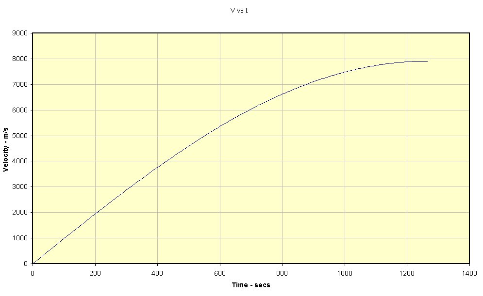

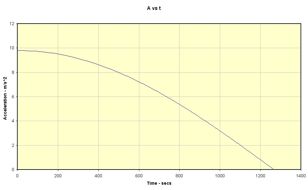

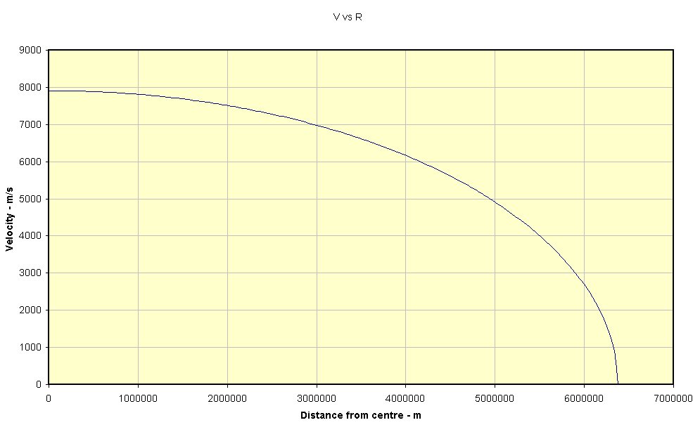

    Quote Originally Posted by volodar View Post
    A good Physics 11 question. I would also ask for time to hit bottom, and rock's velocity at that time.
    Direct integration of the acceleration, being proportional to the distance from the centre of the earth, from the surface to the centre yields time to centre 1266 secs. (Which agrees with Marv's numbers from the spring analogy calcs.) and the velocity as it passes the centre of close to 8000 m/s. For comparison the speed of sound in air at sea level is 332 m/s. Of course the time and velocity calculations assume an evacuated tunnel and so the speed of sound has no meaning there. it is just an indication that it is very fast, 24 times the speed of sound that we experience but only 0.000027 times the speed of light. Click on the pix. for full size versions of the plots of velocity and acceleration.

    This plot shows the variation in velocity with distance from the centre.

    This shows the variation in velocity with time.

    This shows the variation of acceleration with time.
