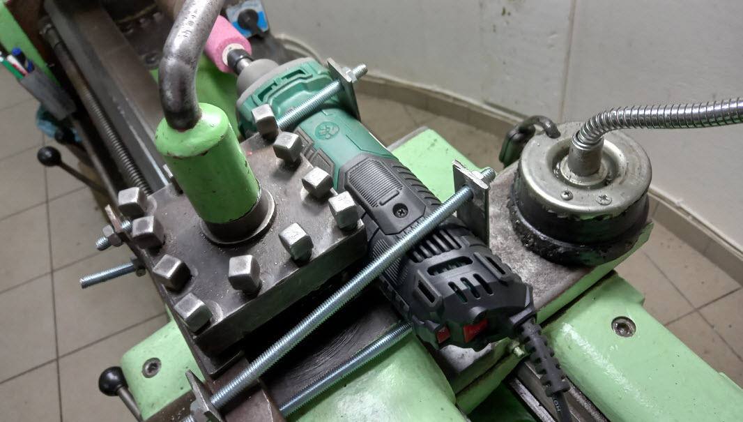

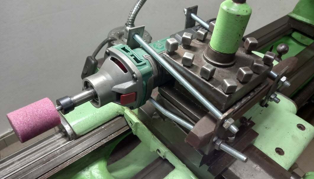

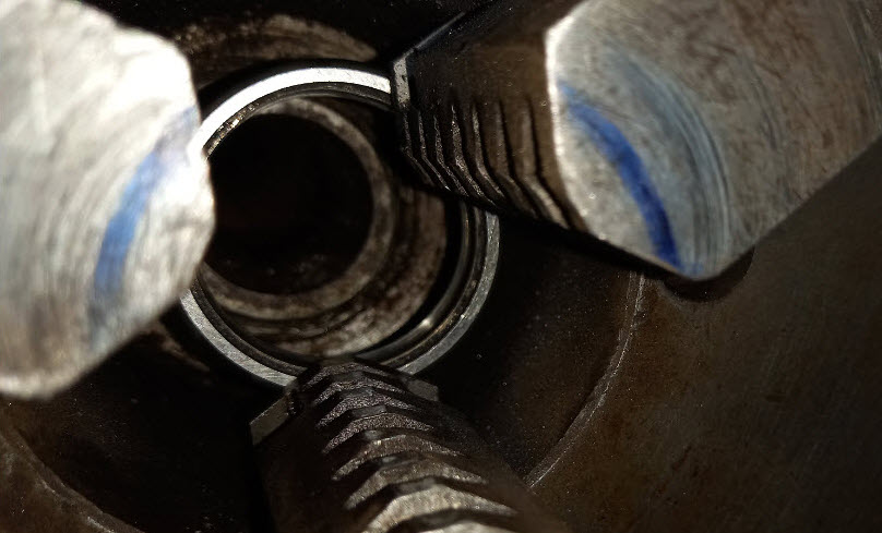

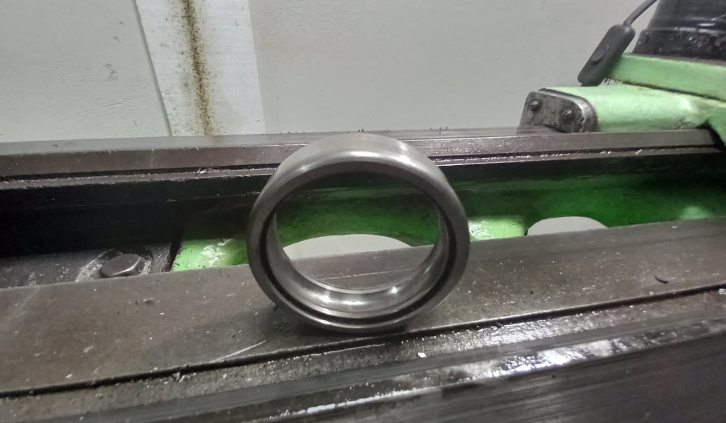

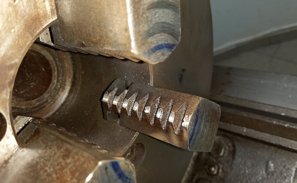

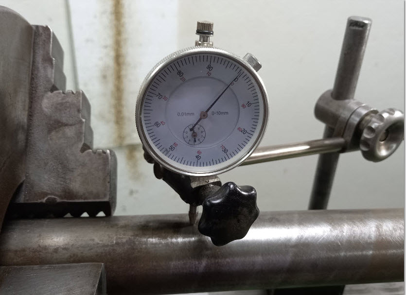

    GRINDING THE JAWS ON A LATHE CHUCK
    In this video i try to grind the jaws of an old chuck.
