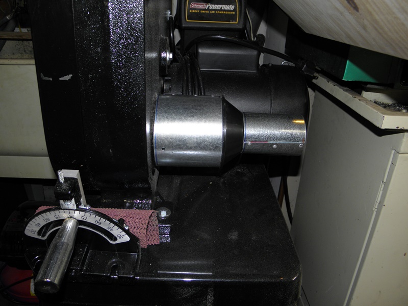

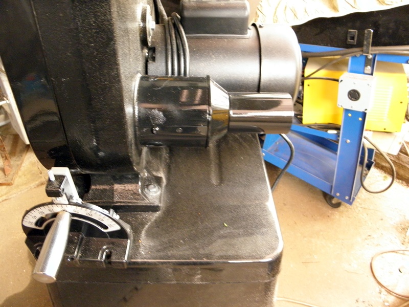

GRIZZLY BAND SAW MODIFICATION Vacuum Dust Reducer 4" to 2 1/4".

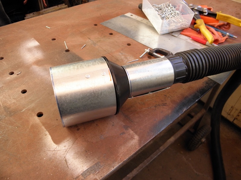

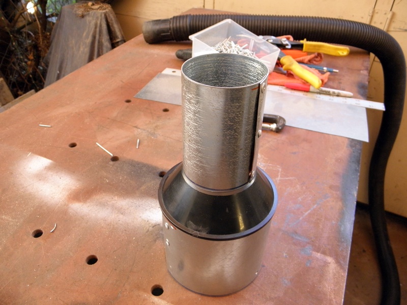

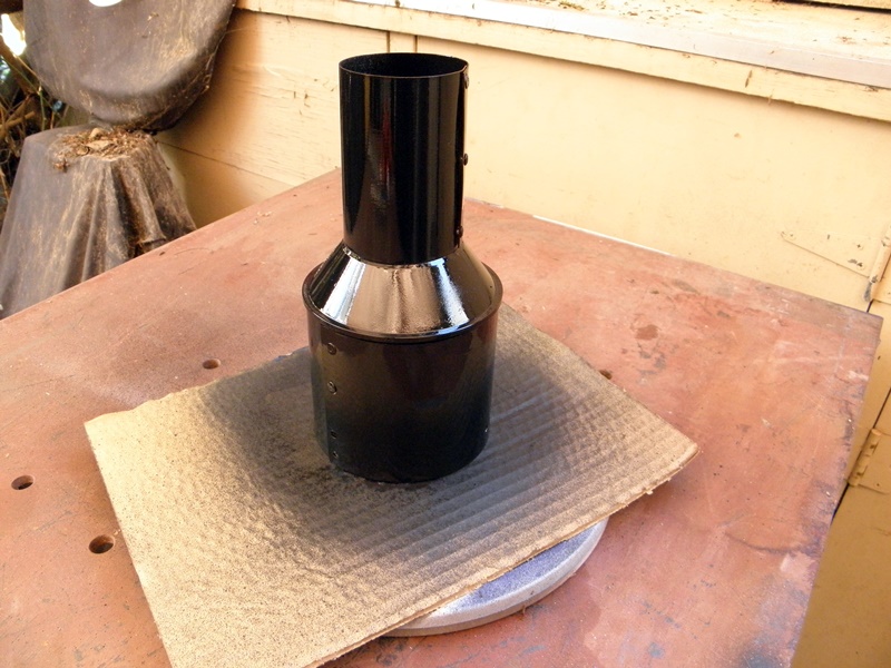

Made from sheet metal turned on slip roller unit and riveted-screwed together.

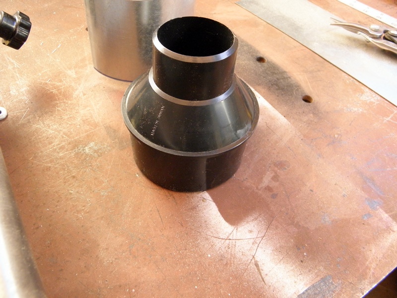

Note: I had to buy the undersized plastic reducer shown on 1 st. photo to start with on e-bay.
