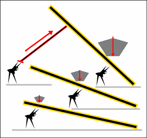

    They already had the wall to the 75% point
    Really. Are they fighting wind? Or who's pushing on the other side of that wall?
    On 2nd thought, though, on a wall that tall, their lever arm – and leverage – from the fulcrum at the base, decreases the higher the wall gets. I ran into the same problem, with a very tall – and heavy – extension ladder, myself once. ( )
    This will help explain it

    They didn't need to rent wall jacks. The simplest thing to do is cut a series or differing length boards to serve as stops as the wall was raised these boards would have been hinge bolted tot the wall frame while it was on the ground or blocked up a little so the boards would extend out from the frame as the frame was raised all of these would be dragged along the shortest would become vertical first becoming rest stops if needed as the wall could lay on them as the wall went up the successively longer boards would also drag to vertical eventually as the wall reached a certain angle of erection the longest boards would slide over stops or a fixed ladder laying on the ground anchored to the bottom of the wall once the wall was full vertical the long boards would be the bracing that held it upright boards on the opposite side could do the same thing in reverse instead of sliding up stops on the ground they would have a fixed pocket on the ground and slide to a prearranged stop on the outside of the wall.
    Even if they only got the wall 2/3rds of the way up on the first try it would rest there until they either had more guys or cought their breath for the final push.
