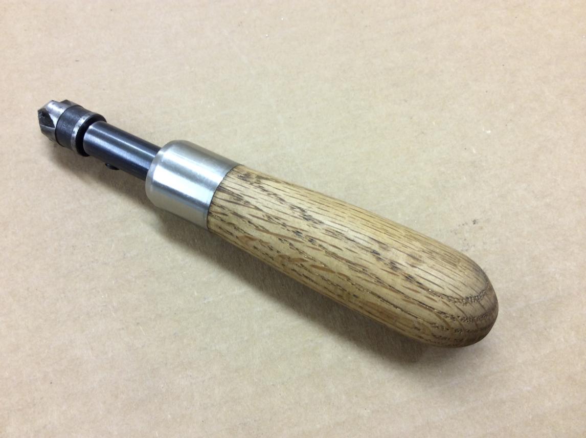

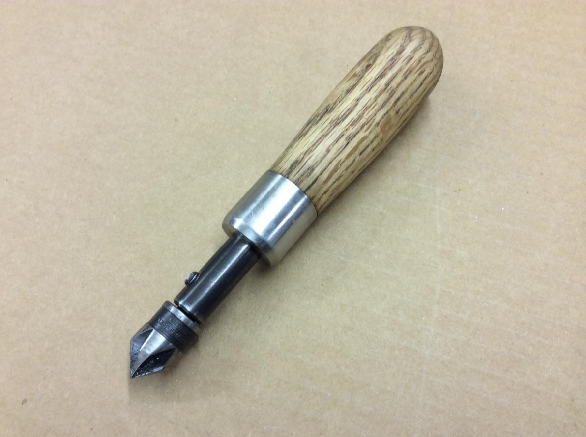

    Hand Deburr Tool
    I reused an old 4WD shifter handle I made a long time ago and the truck is long gone to razor blades. I made a short adapter from 1/2" stressproof steel (nice stuff to machine) threaded one end 1/2-20 on the OD, other end drilled 1/4" for the countersink. As sanded and refinished handle. You can see me make this on You Tube, "Hand Deburr Tool". "Randy Richard". Hand Deburr Tool-image.jpgHand Deburr Tool-image.jpg
