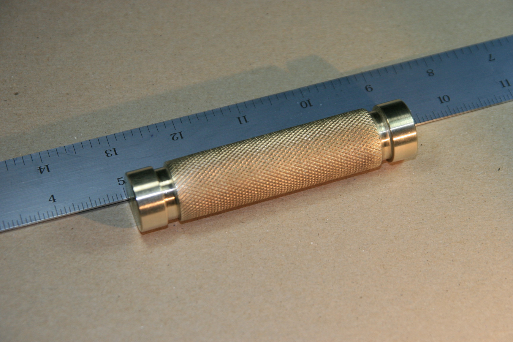

    Quote Originally Posted by jjr2001 View Post
    I think you could but like Marv posted in the "dead blow palm hammer" it needs to be long enough so you don't pinch your hand when using it.
    The other thing with using brass or nylon for the surface is protection of the item being hammered. Also for punches you reduce the chance of knocking off a little chip of steel and either sparking or having it fly to the eye!
    I like the idea of lead shot for the weight. I was wondering if solid lead poured into a brass head would work as well as shot?
    Cheers, JR
    A lot of the "deadness" comes from the numerous little bits of lead colliding with each other. A solid slug of lead would provide weight but would be less dead than shot.
    Lead shot, available from reloader supply places, has all sorts of uses around the shop. Beyond the obvious one of providing easily conformable weight to objects, a leather bag 3/4-filled with shot makes a great conformable gluing weight and a nice surface for doing repousse work.
