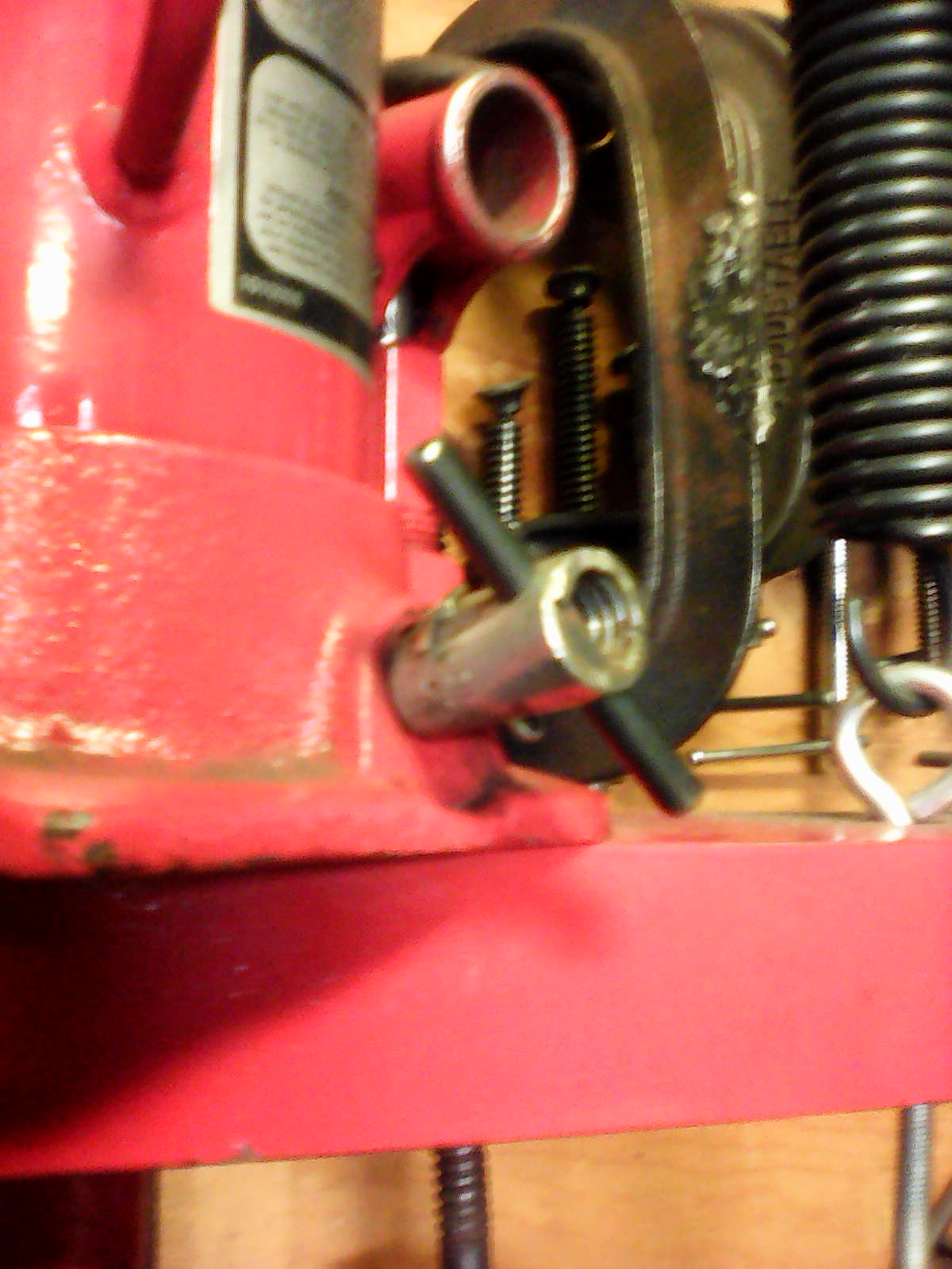

    Handle for hydraulic press jack
    Made this using a piece of an old drop in concrete anchor. Flattened one end a bit to fit over the stub sticking out of the jack, drilled a hole through both pieces for a cotter pin. Drilled a second hole for a roll pin "handle".
