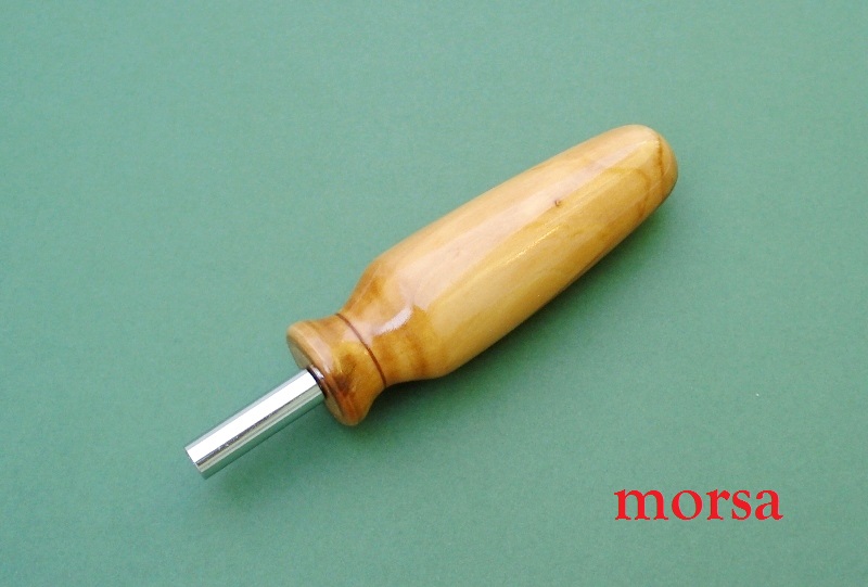

Handle for screwdriver bits
This tool was also made in january-2012, along with the http://www.homemadetools.net/forum/4...ewdriver-54610, and also in apple wood.

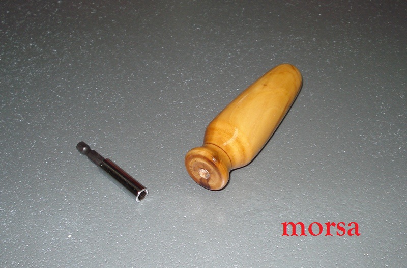

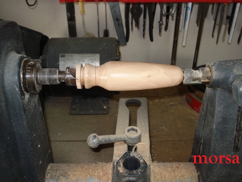

The handle was drilled with a 9/16" drill bit, and a magnetic bit holder was glued with epoxy glue.

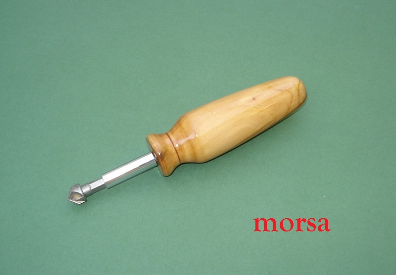

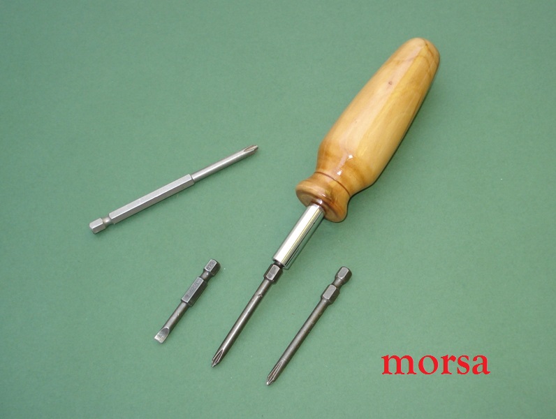

This way you can hold all the bits designed for screwdrivers; it is also possible to place a 1/4” in. hex shaft countersink bit, and with that we already have a hand countersink tool.
Attachment 15192
Attachment 15193
Attachment 15194
Attachment 15195
Attachment 15196
