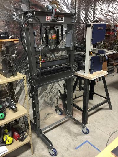

After reading a variety of posts by others who made improvements to their HR press, I made the following upgrades:
Added air over hydraulic jack
Added table winch
Pinned table plates to keep them from falling on my feet
Added needle bearing cam follower guides
Substituted individual grade 8 bolts for the through bolts
Mounted on casters
Added finger press brake
