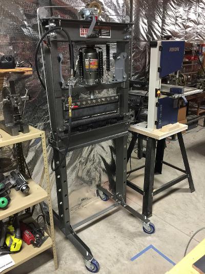

    After reading a variety of posts by others who made improvements to their HR press, I made the following upgrades:
    Added air over hydraulic jack
    Added table winch
    Pinned table plates to keep them from falling on my feet
    Added needle bearing cam follower guides
    Substituted individual grade 8 bolts for the through bolts
    Mounted on casters
    Added finger press brake
Name:	Harbor Freight Press.jpg
