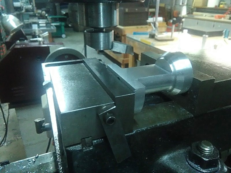

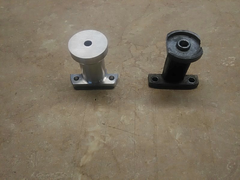

The other day I was using it and discovered a crack in the cross feed screw bearing housing, it was pot metal as well, so I had to make one of those, I made it from a piece of 2.750” round 6061 aluminum.

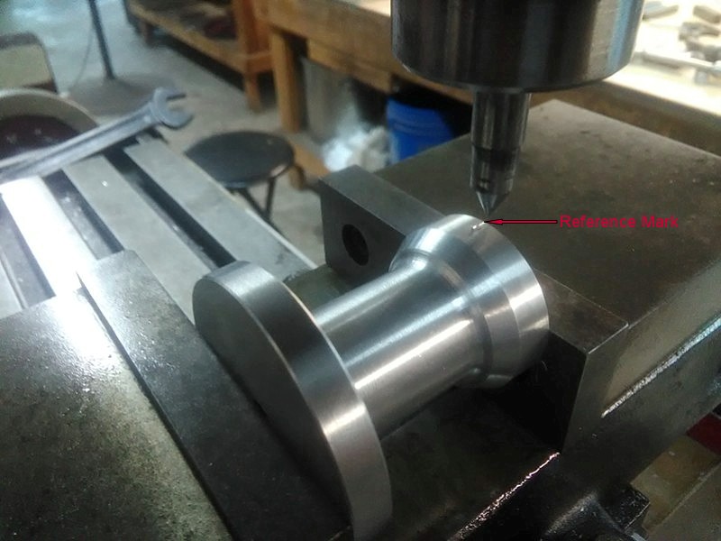

One tip on making this part, when you get ready to drill the two 17/64” mounting holes use a piece of 5/16” C.R.S. round about 5” long to locate the centers of the housings, clamp one side of the housings together and drill the opposite hole then visa versa. The reference mark on the housing was scratched on using a piece of 3/8” round HSS tool bit ground to a very sharp point held in a 3/8” collet in the milling machine, locate the center of your work piece with the tool bit, touch off and go down into the surface of the metal about .007” deep then cross feed ¼” long.

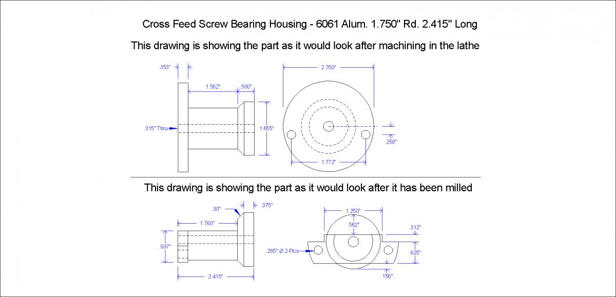

Below you’ll see some photos of the machining process and a cad drawing of the part, I hope anyone with one of these little machines will find this information useful.

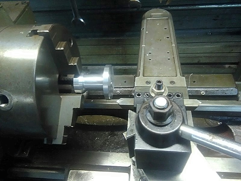

Attachment 15248
Turned and ready for parting off

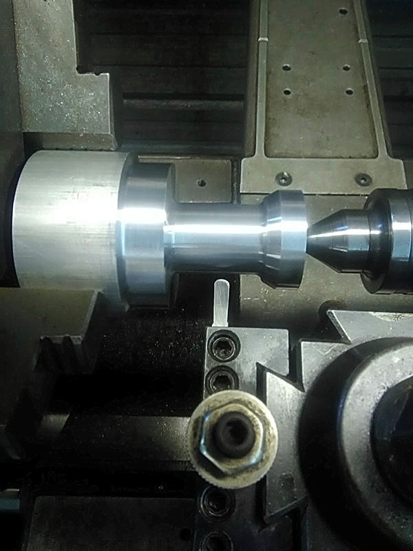

Attachment 15249
Facing off to required length
Attachment 15250
Scratching the reference mark
Attachment 15251
Milling the flat surfaces

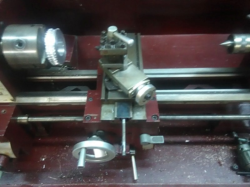

Attachment 15252
The lathe this part will fit to

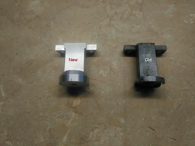

Attachment 15253
Showing the new part against the old part

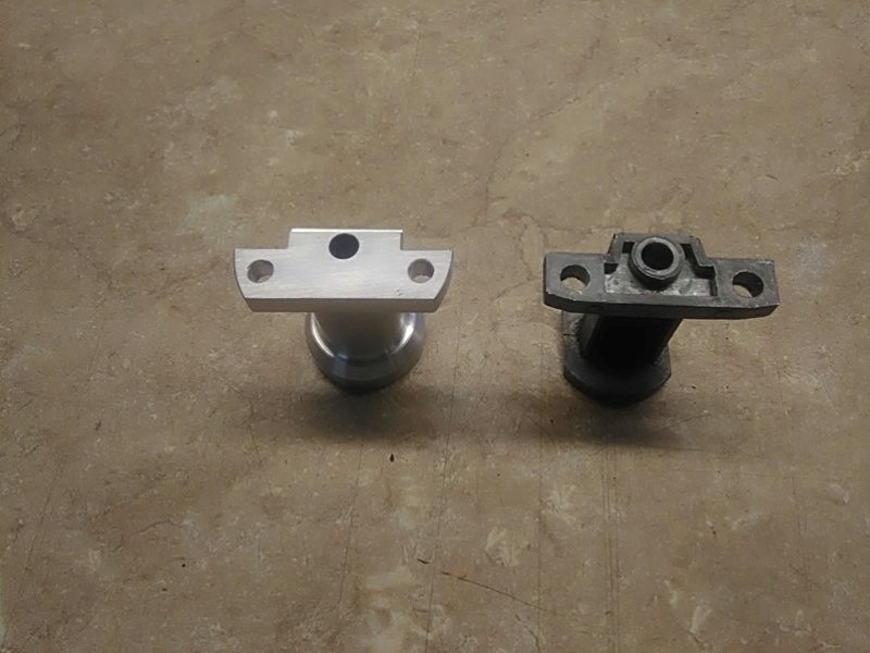

Attachment 15254
Rear view of part
Attachment 15255
Front view of part
Attachment 15256

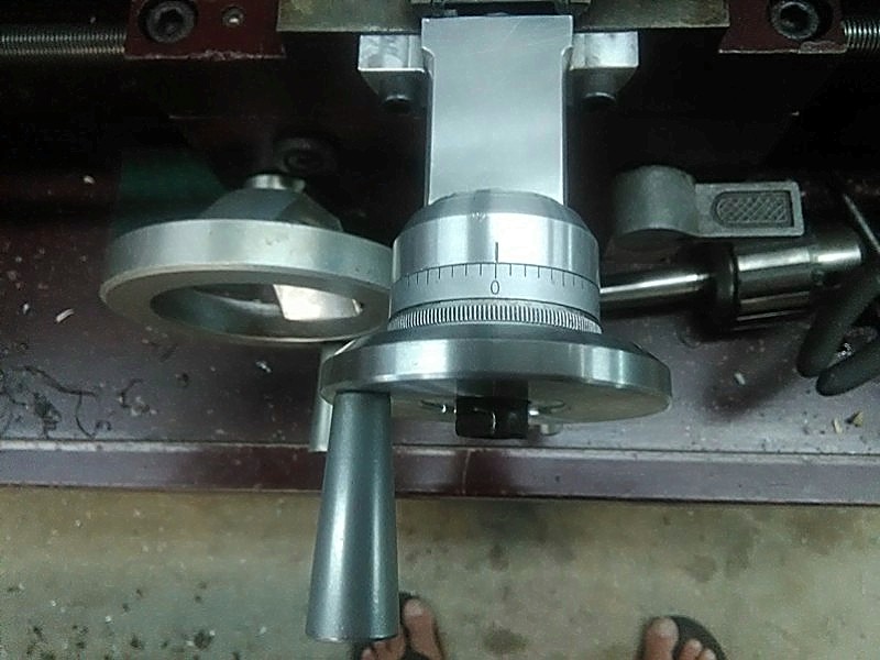

Installed and ready for work

Cad Drawing
