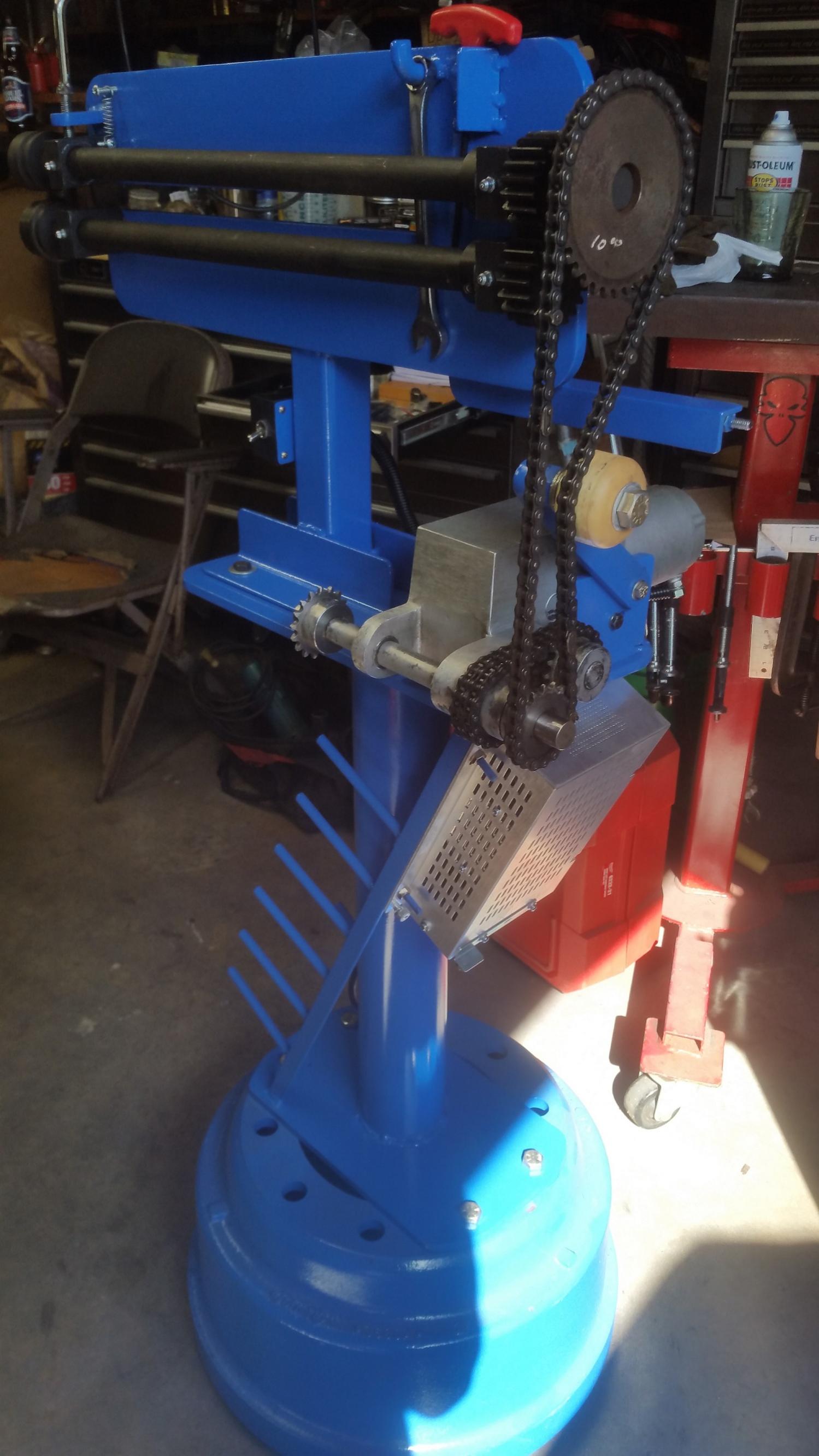

Then again, all you need is a couple good photos to fabricate one from scratch, scads right here on HMT.net Not all that different from a clothes wringer, two shafts rotate towards each other [ 1 CW, 1 CCW]. Diesets with male & female contours do the work, and beading is just the start.
Some shafting, frame material, bearings/ bushings, gears [or sprockets & chain] and a handcrank. Instead of buying and modifying, build per the mods others have uncovered! A little planning, could incorporate a motor down the road.
Troll Hunter posts, and I'll bet a large number of other HMT.net'ers lament "...don't have any metal working machines, lathe, miller, or such, so I'm limited to MIG welding and Mr. Grinder!".
So let's design around commercial components a bead roller that bolts and welds together! That's why we're here, right?
