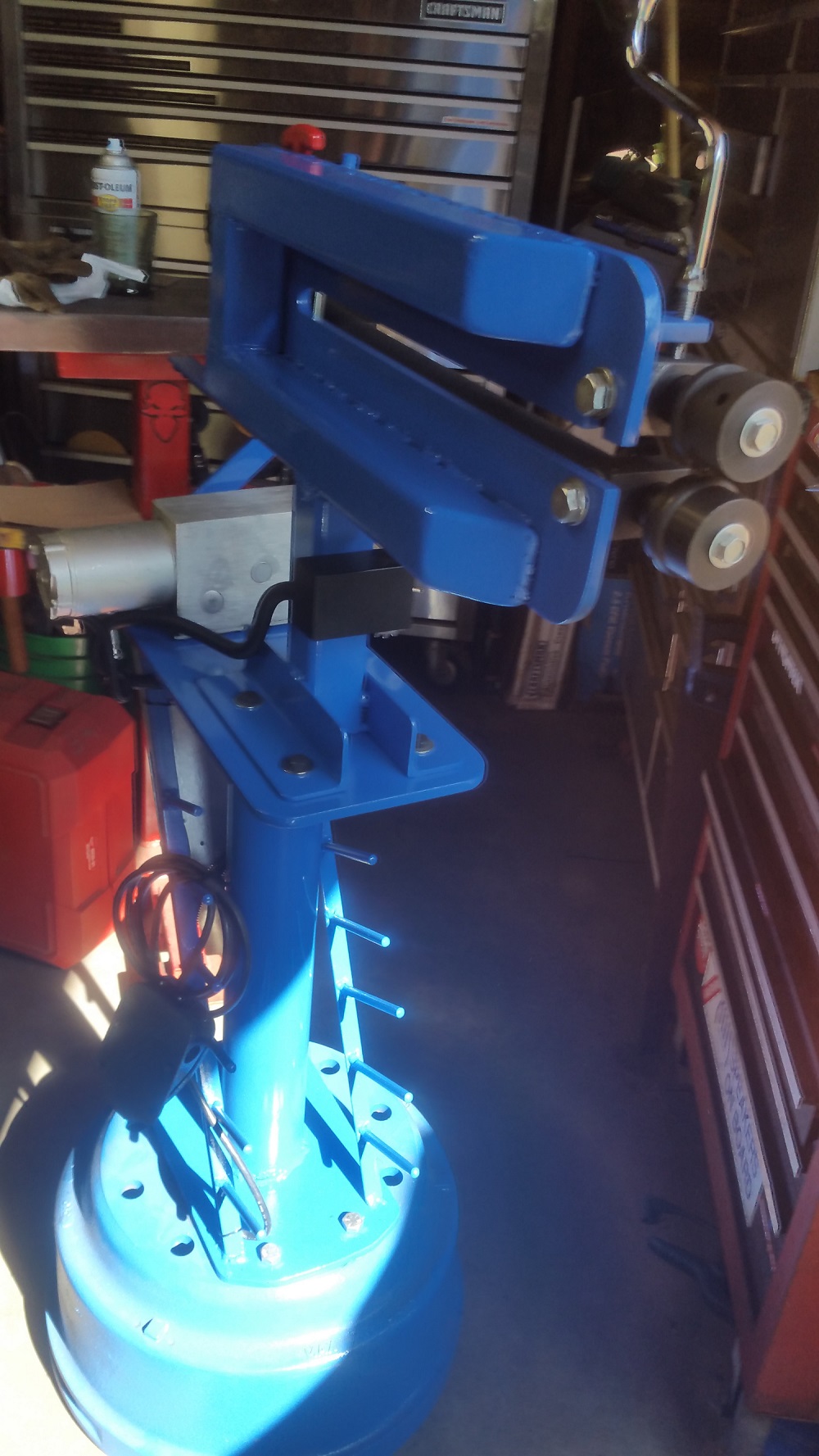

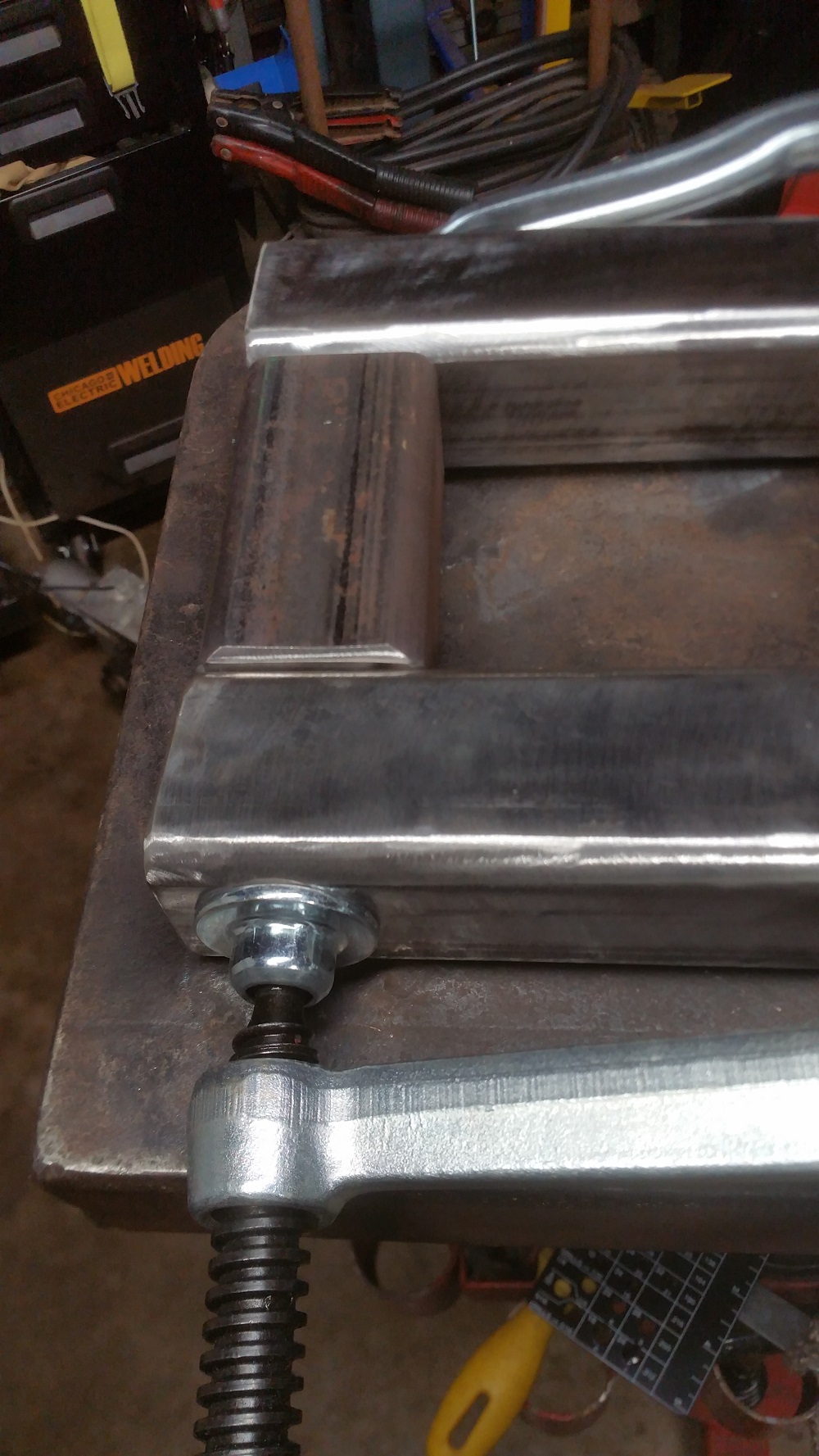

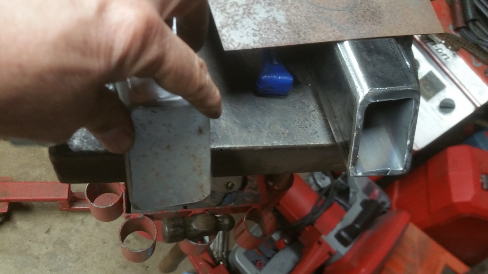

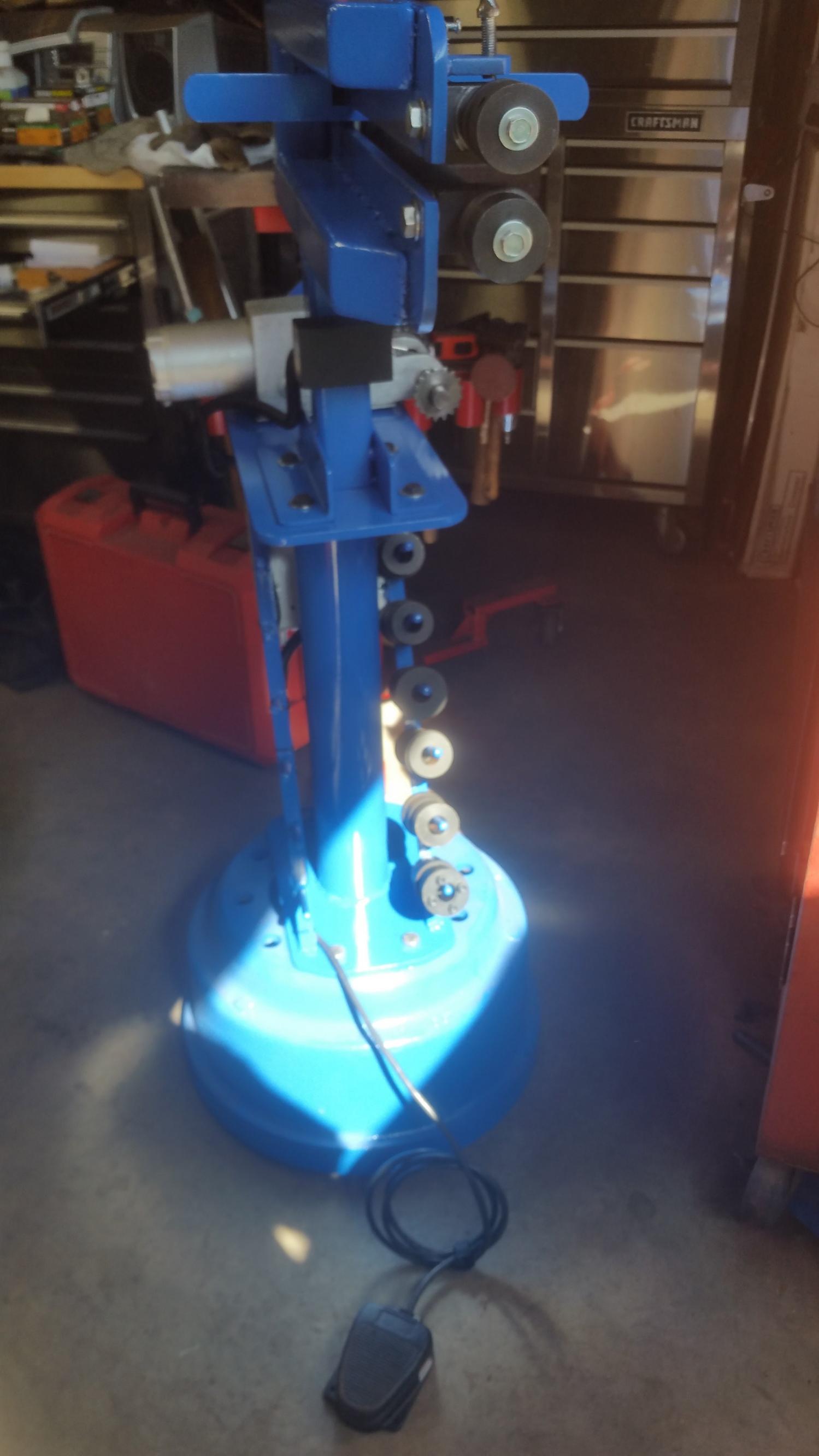

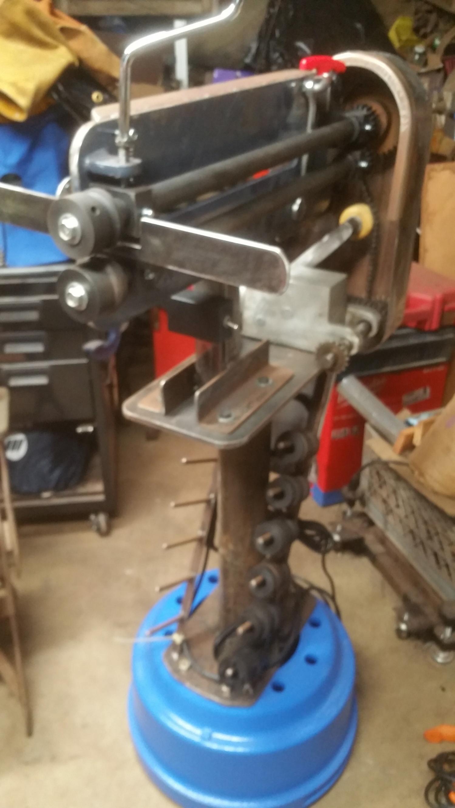

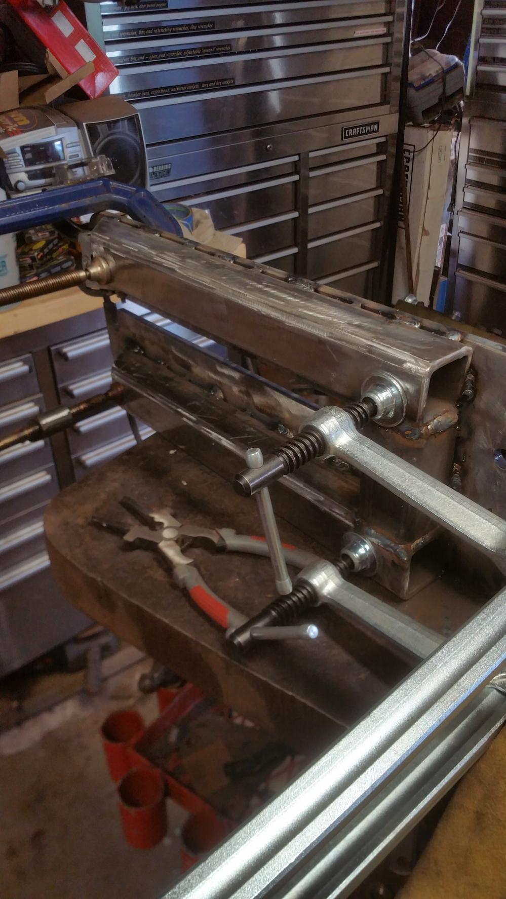

    Here's my nearly completed motorized bead roller from H.F. I used a motor from a motorized stair climbing hand truck(dolly) and a 5 volt/15 amp power supply also added a foot pedal and wired in a single pole double throw switch to reverse the polarities and motor direction. works pretty well, but may have to upgrade the toggle switch.

    any photos of the power drive ?

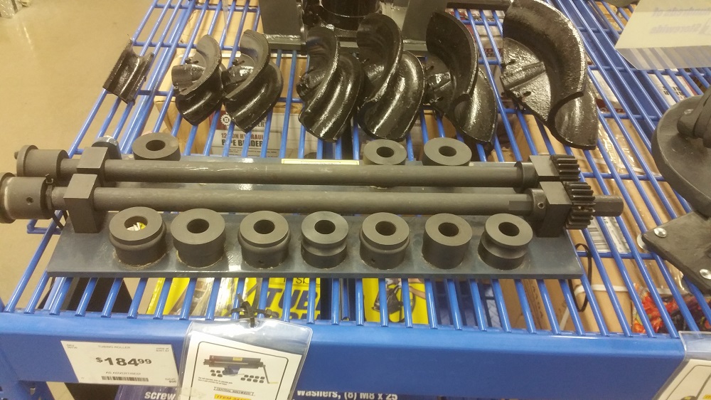

    Given that there are many different mods to the HF unit it appears their frame is lacking. I have a beautiful 70 year old cast iron bead roller that I cannot get rollers for and I do not have the tooling to make new ones. Are the HF rollers any good and if so what size shafts does HF use as that may solve my problems.

    Harbor freight dies have a ID of 22mm. They are a soft steel and not the best units around but work in a pinch if used with respect. Hoosier profiles will make dies with any size ID you need and their products are top notch. Do you have any pictures of your bead roller to see if it can be identified.

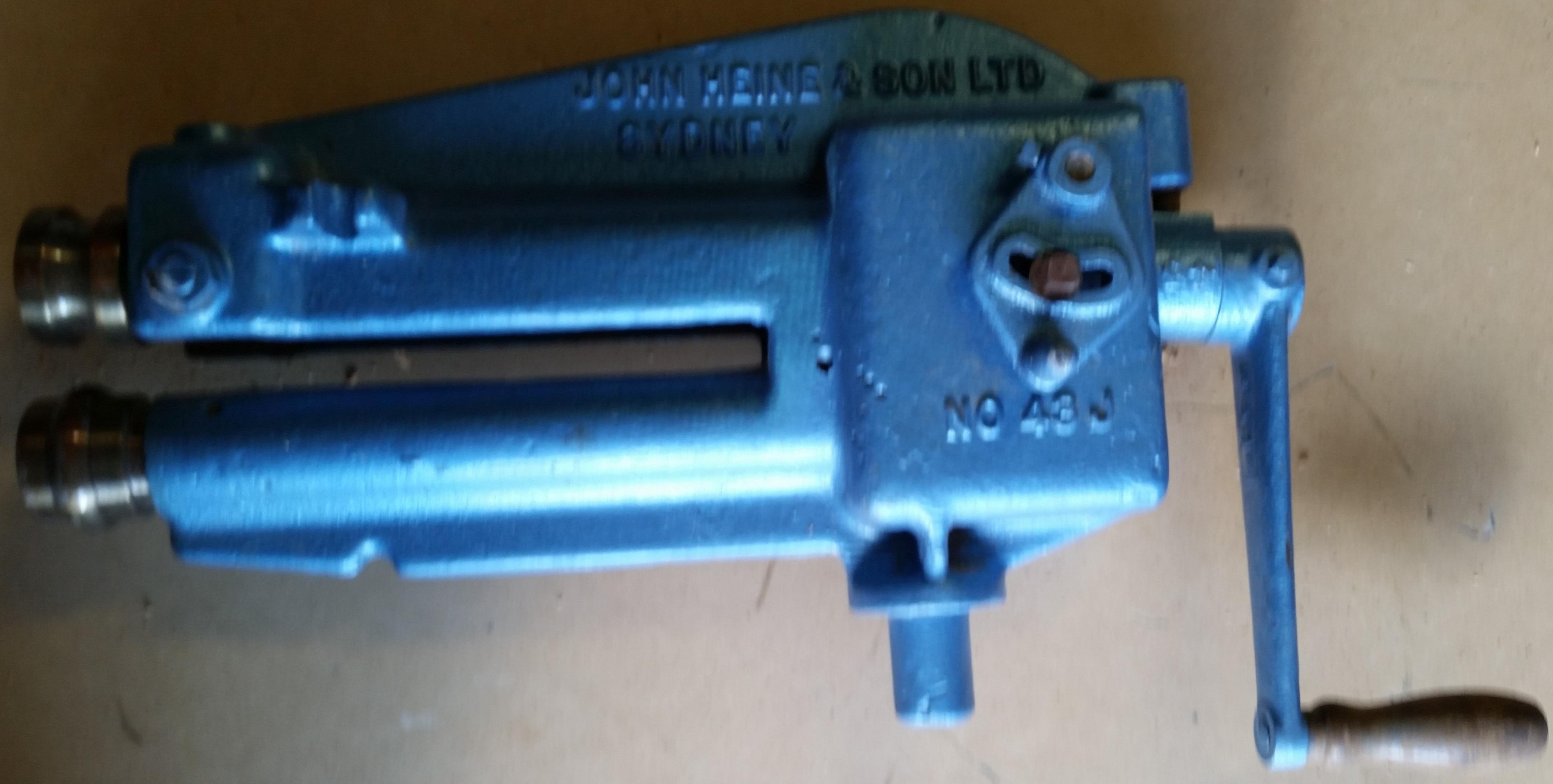

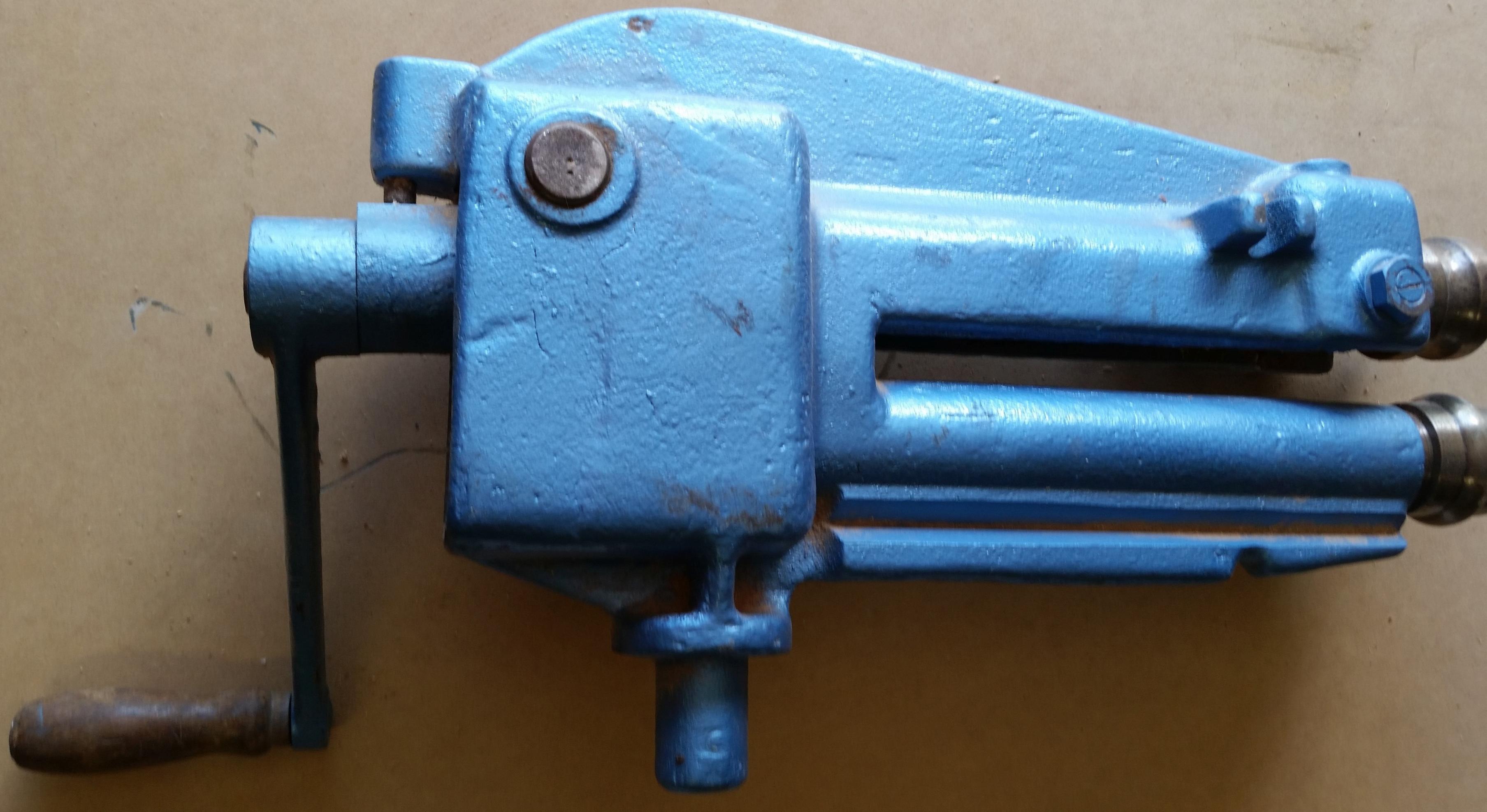

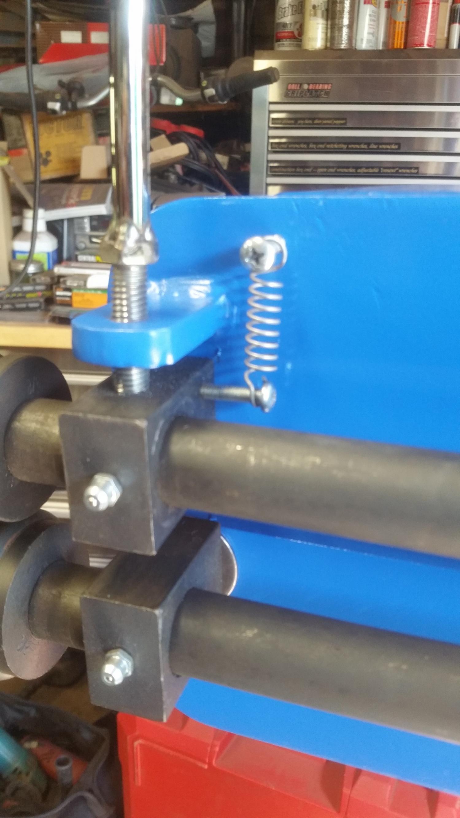

    What I have is a John Heine model 43J from ww2. My apologies for the photos - not my best and too late in the day to reshoot them.
    I will have to remove the wheels and check the dimensions but the shafts are about 25mm from memory. I works perfectly and all I have done is a strip, clean, repaint and lube.
