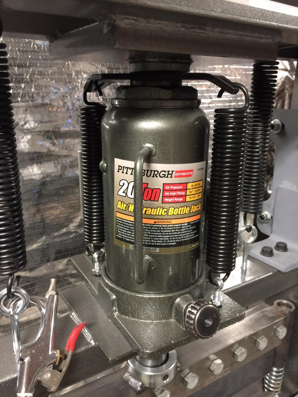

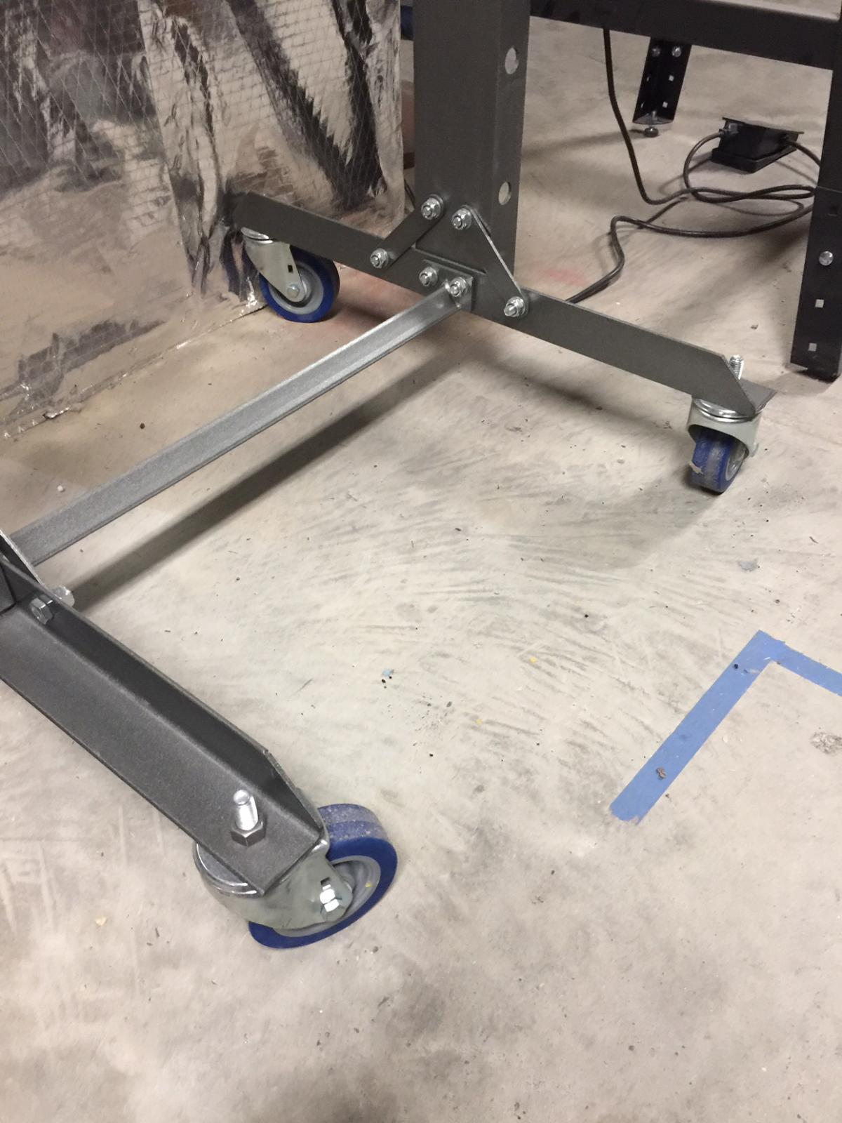

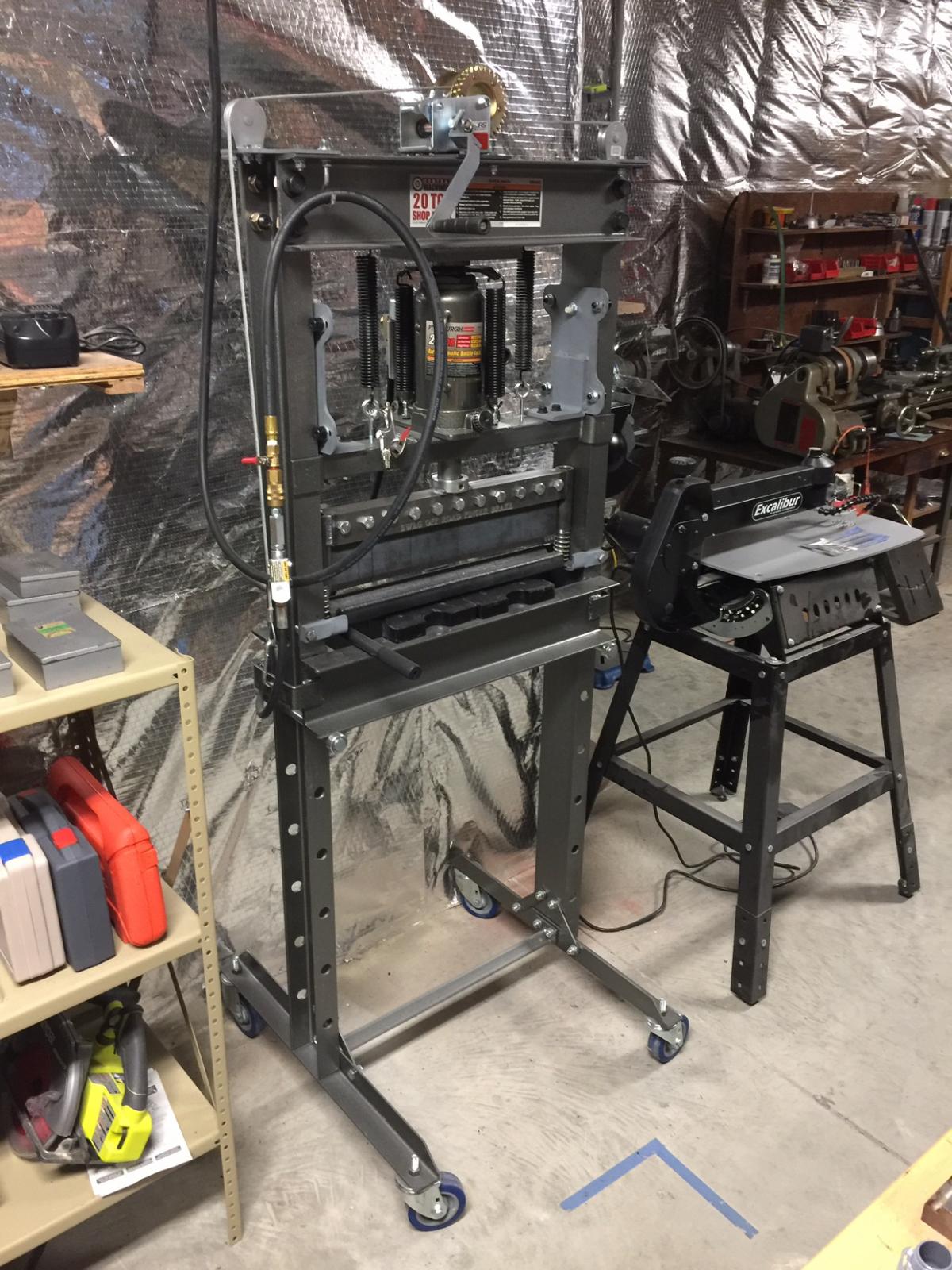

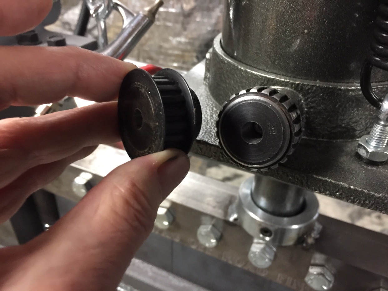

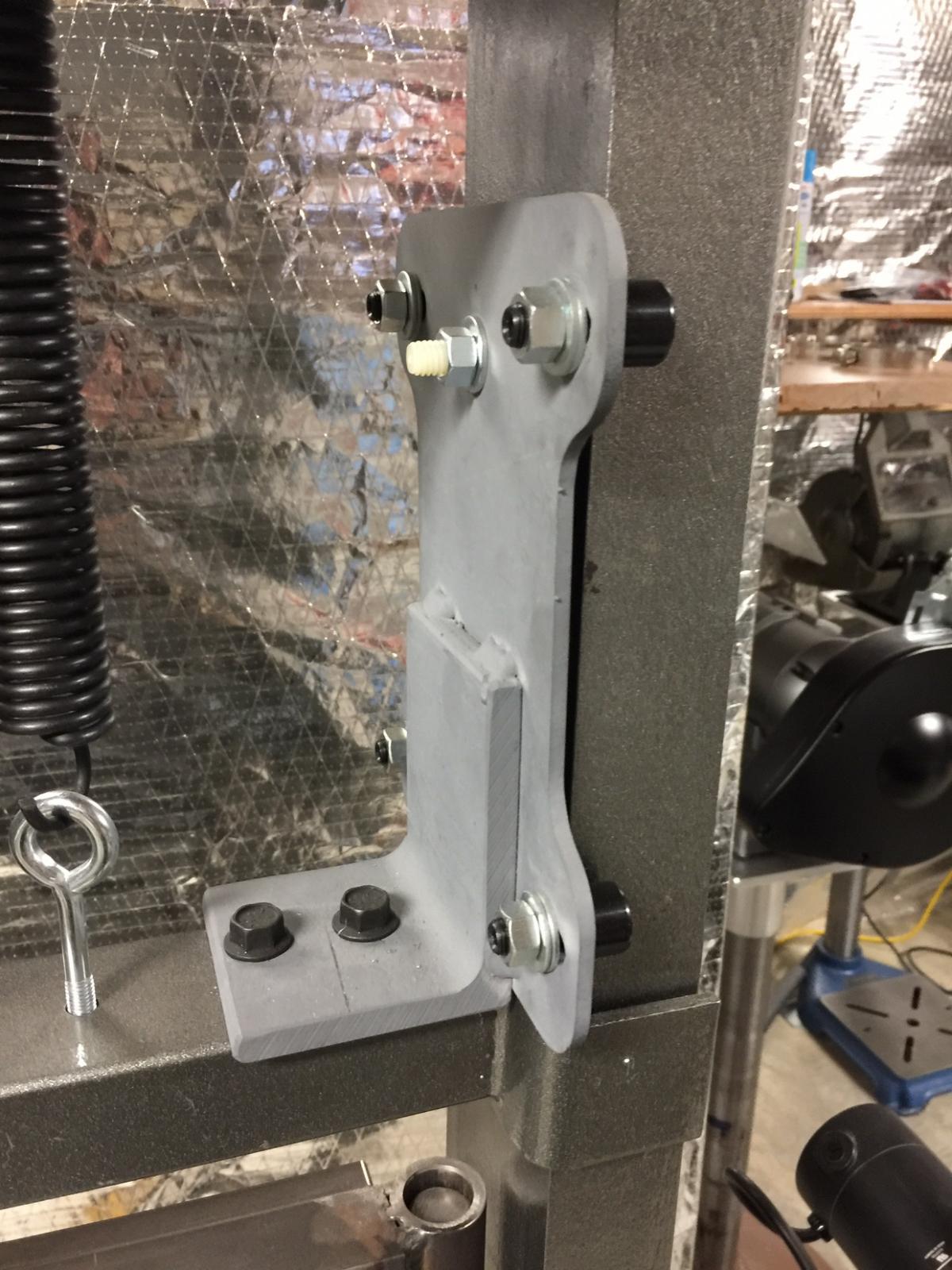

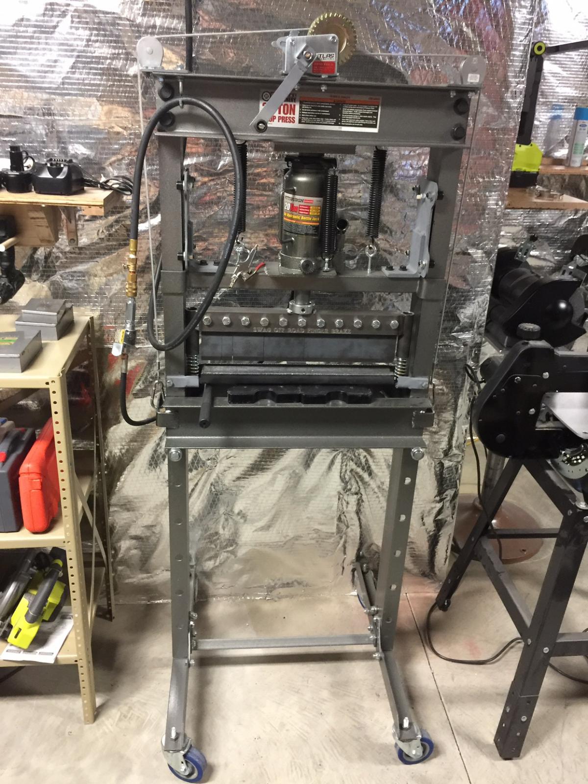

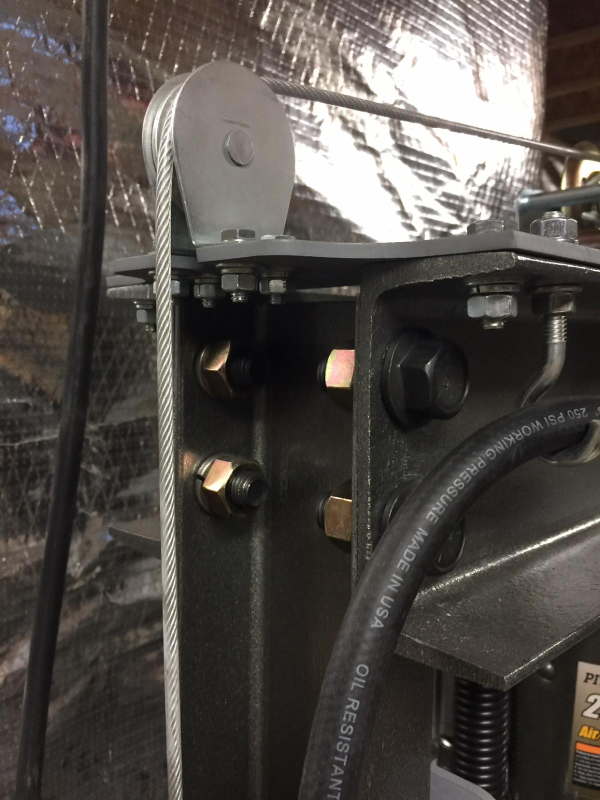

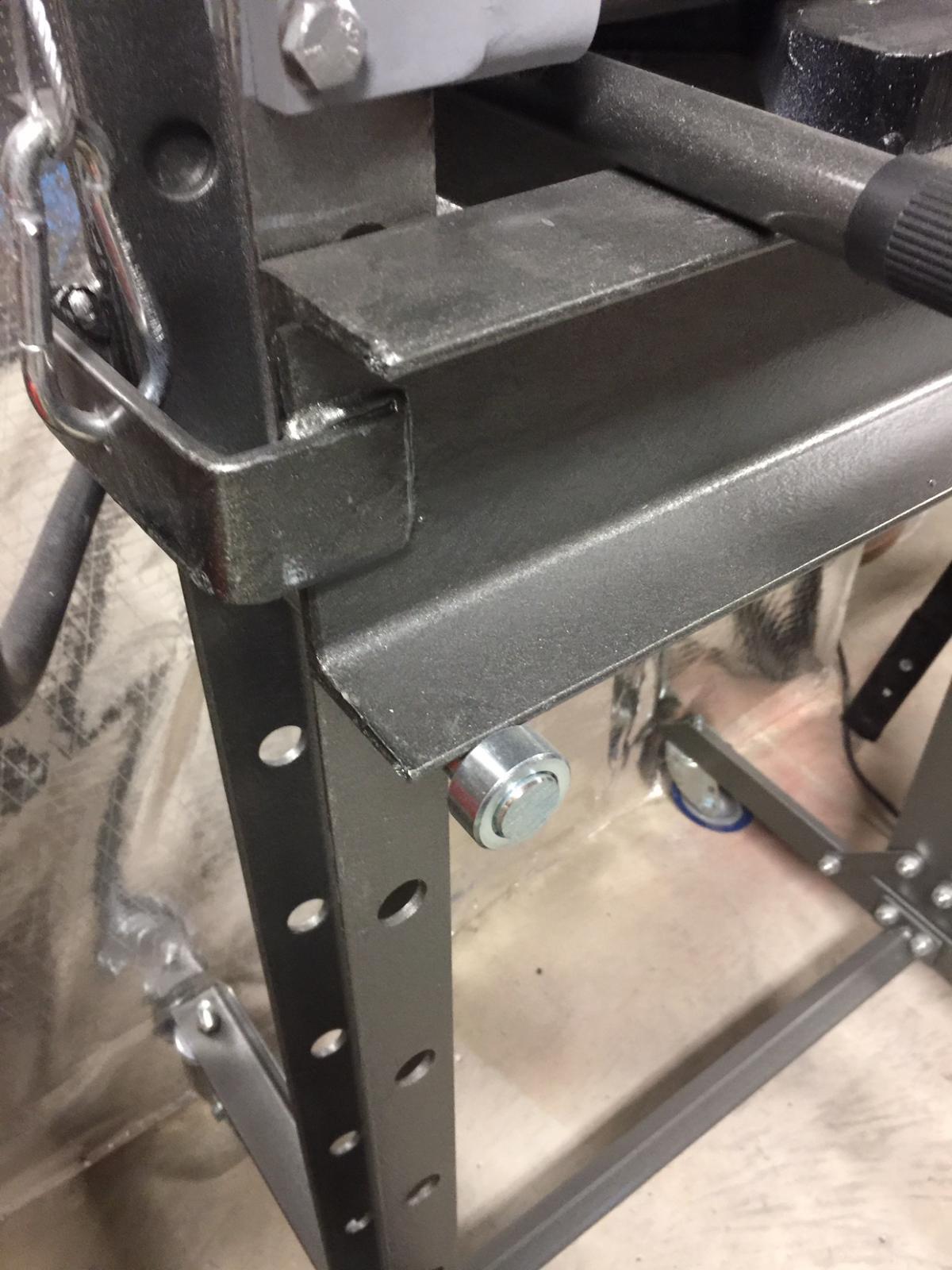

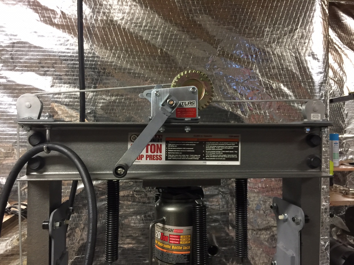

Like a number of other idiots, I bought a $180 Harbor Freight 20 ton press and then proceeded to pour over $500 into it. Oh well, here's the result.
Mods include:
Casters
Pinned the plates

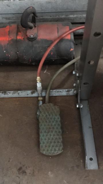

Air over hydraulic jack
Boat winch for table
Individual grade 8 bolts
Needle bearing guide rollers

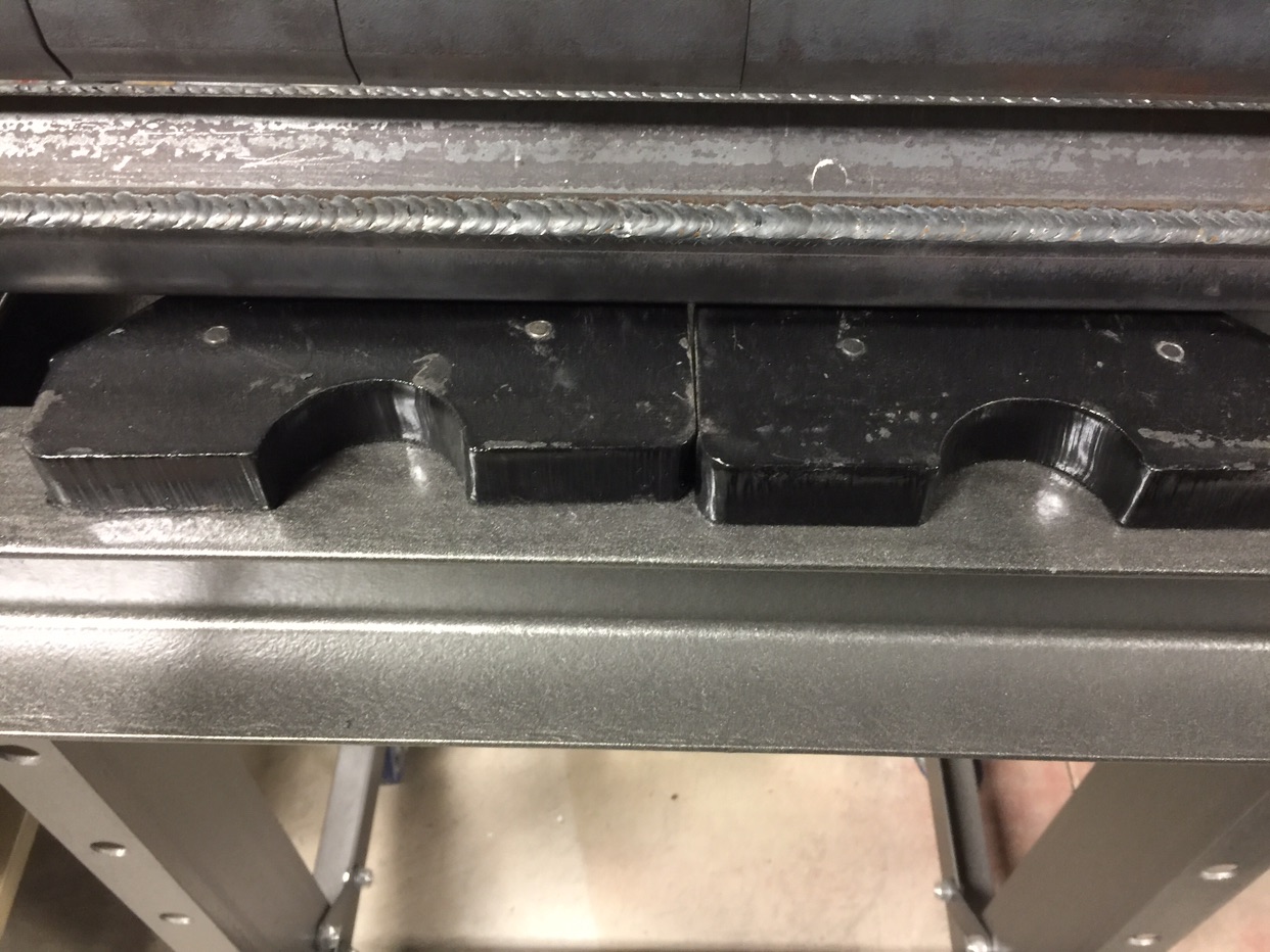

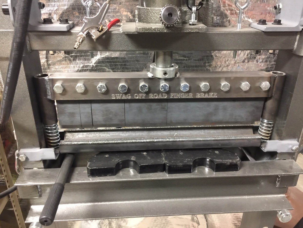

Swag finger brake
Knob made from turned down timing pulley
Shaft collars on ends of table pins
