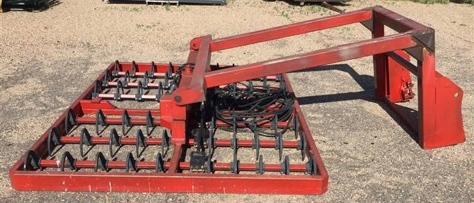

    These grouping machines are designed to be used with loaders which have a platform boom with grappel loaders, such as this:

    Feeding animals becomes a material handling problem once the number of animals grows over a certain size - depending on the animal. I had big animals.
    Had a big round baler (5'x5' string wrap) for many years and would put up hay (100+ bales) every year. Before that, I had purchased 4'x4'x8' bales. Before that, I did 2 tie bales (about 70# per bales) for a couple years. I couldn't do 3 tie bales - they kicked my butt (110+ # per bale) - couldn't buck them high enough to stack or to transport. After the round baler, I went back to purchasing large rectangular bales, 3'x4'x8' was the best.
    I looked at one of these grapple loaders and if I had stuck with 2 tie bales, it would have been the way to do those bales. Folks that use those usually don't have a bale stacker wagon. But, I looked at the material handling and peeling leaves off a big bale was far less work, so I paid attention to that...
