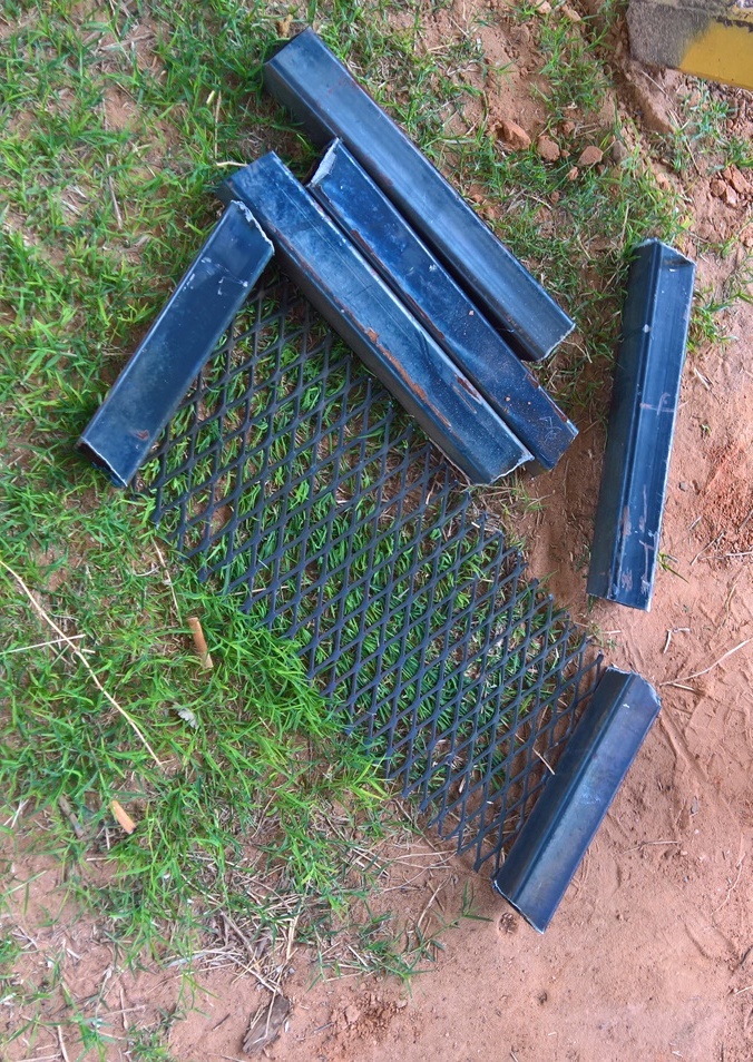

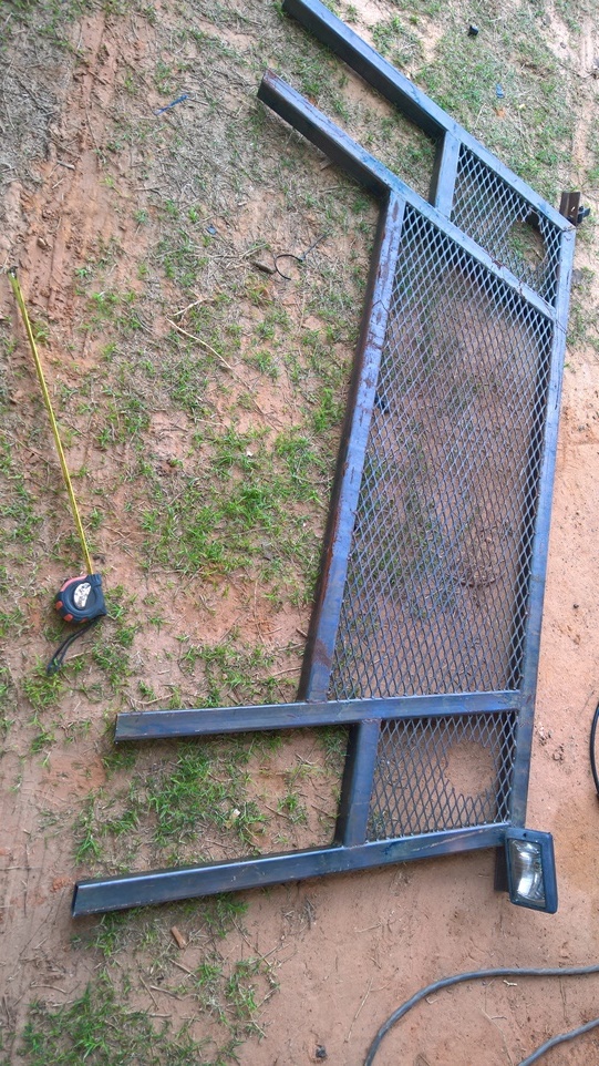

I have a couple of old flat beds off of whatever they came off of. So wanting to build a headache rack window protector but not wanting to use new materials or spend the time to make a complete rack I decided to cut one off of one of the flat beds.

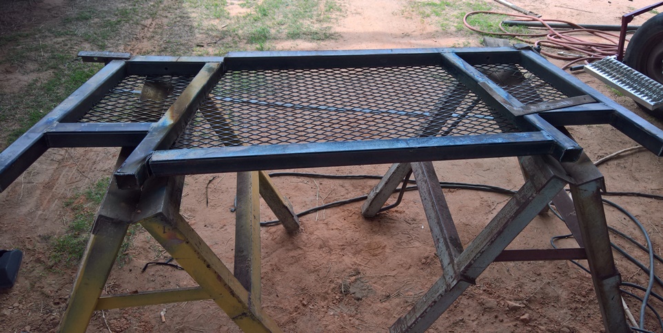

Ok this done now to reduce the height so it I can mount it to the top of a pickup bed sides . Problem #1 the rack is 10 inches too wide even after cutting it off to the height I wanted so now I have to section it and reduce the width.

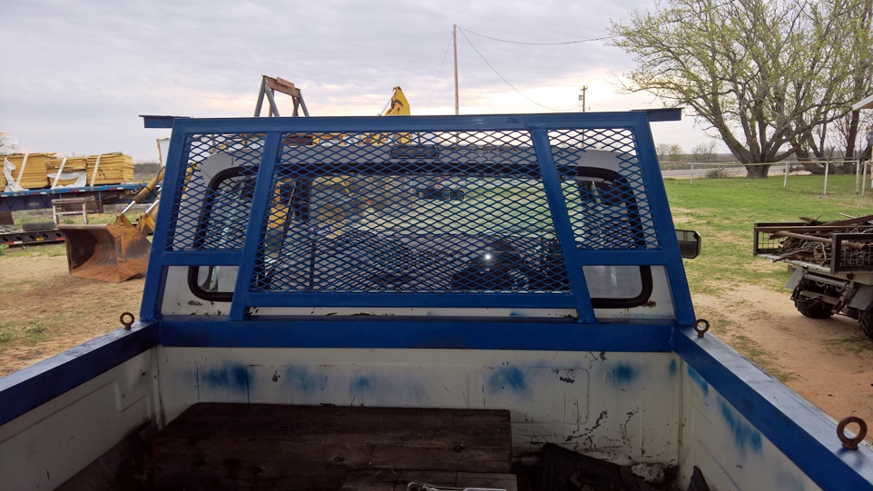

This was how it turned out
Attachment 34190
Attachment 34191
Attachment 34192

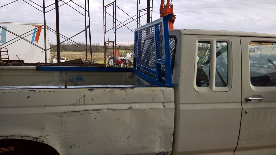

A little blue over spray wont ever hurt an old truck
Attachment 34193
Attachment 34194
