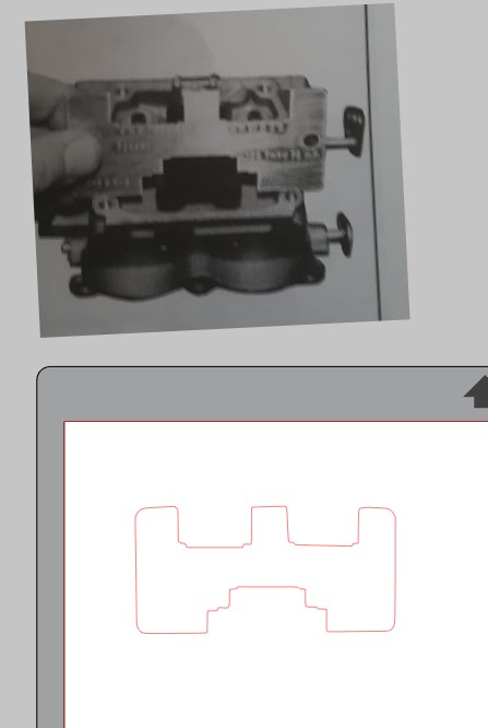

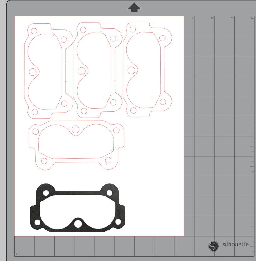

I use my Silhouette Cameo 4 for making gaskets. Overhauled the carbs on my Evinrude and the kits didn`t come with two gaskets I needed so I downloaded a pic of the gaskets and cleaned them up and made them out of manila folders.Attachment 42718 The kits also did not come with a float gauge so I made one of them, too.Attachment 42719
