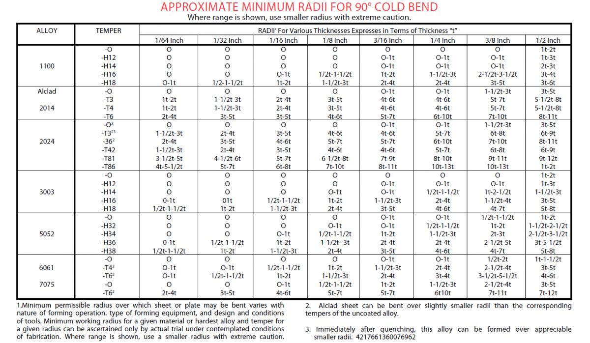

these charts will give you the recommended minimum bend radius
Minimum Recommended Bend Radius Chart from American Machine Tools Company
Attachment 13215
