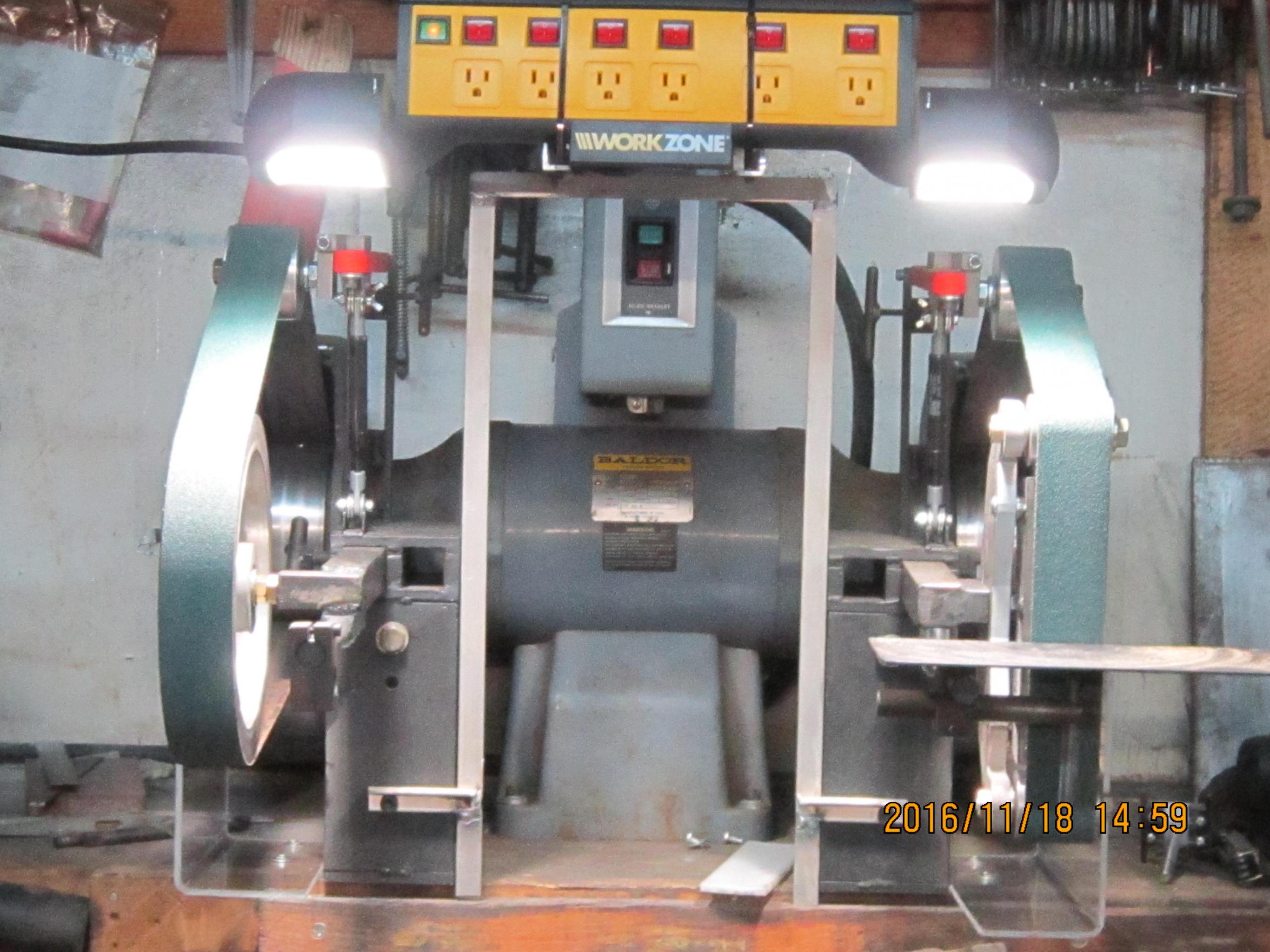

    I am wondering if an idler wheel or the axles that support it are worn and causing all the belt pressure to be on one side of your contact wheel. I would take it completely apart and measure everything with a micrometer. There is a group on Face book called : Home Built Belt Grinders that you could post your question on and see if any one has had this problem. Most guys on there are knifemakers or at least try very hard to be. Here is a picture of the grinder I built. It runs very good but I don't make knives. I did some 45 years ago but I couldn't make more than $1.00 an hour! LOLHello from Coastal Georgia-img_1088.jpgHello from Coastal Georgia-img_1087.jpg

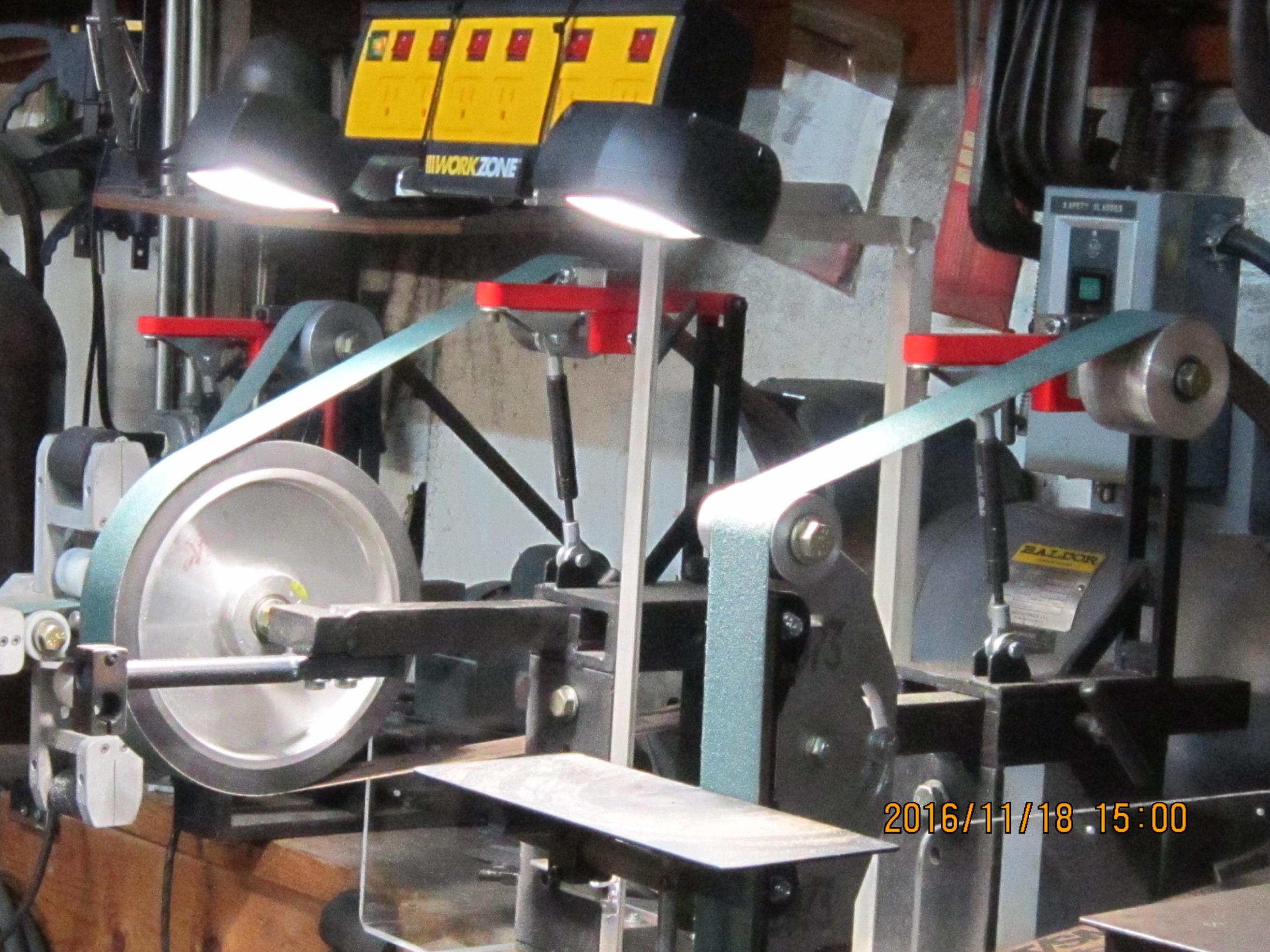

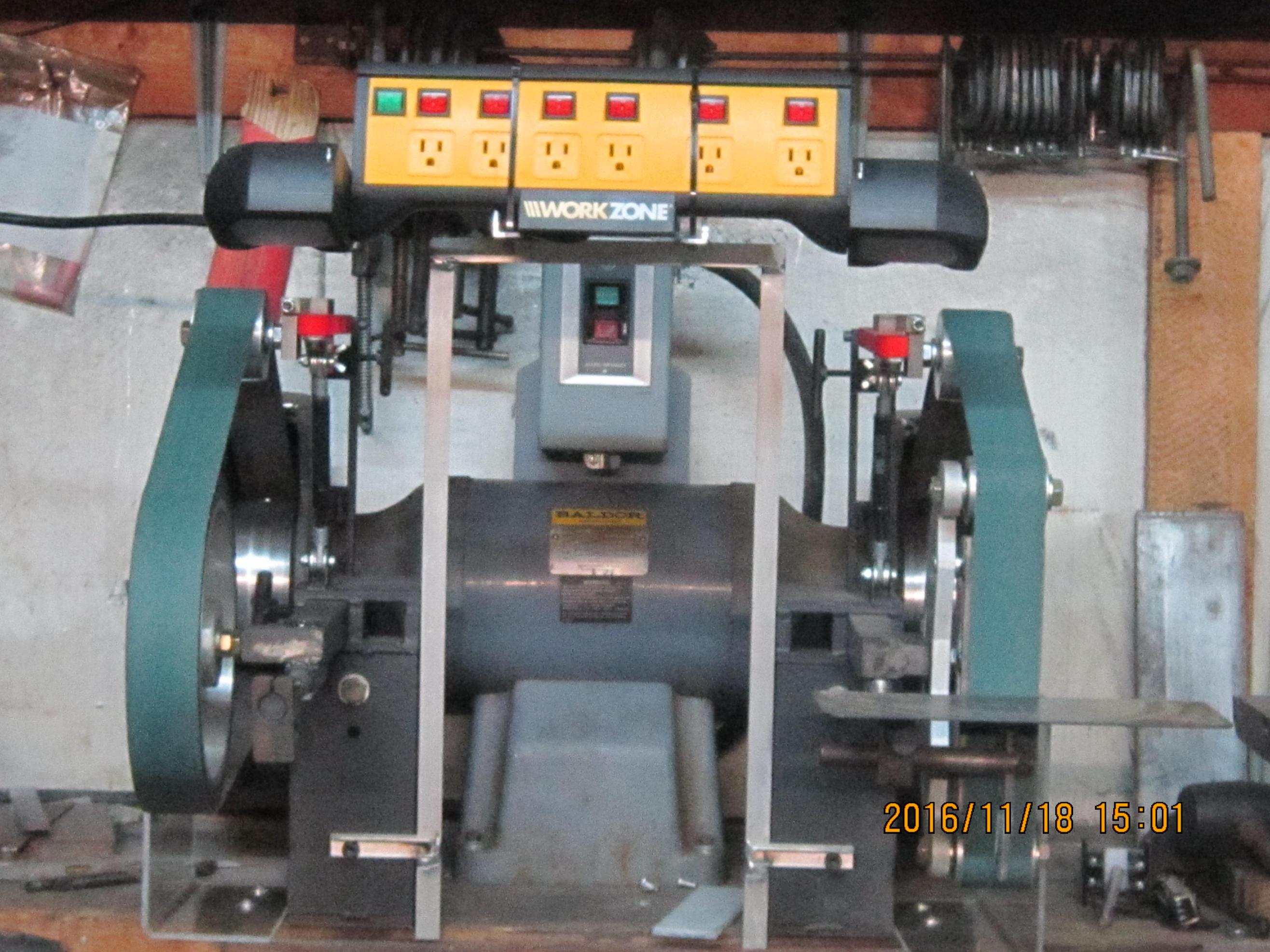

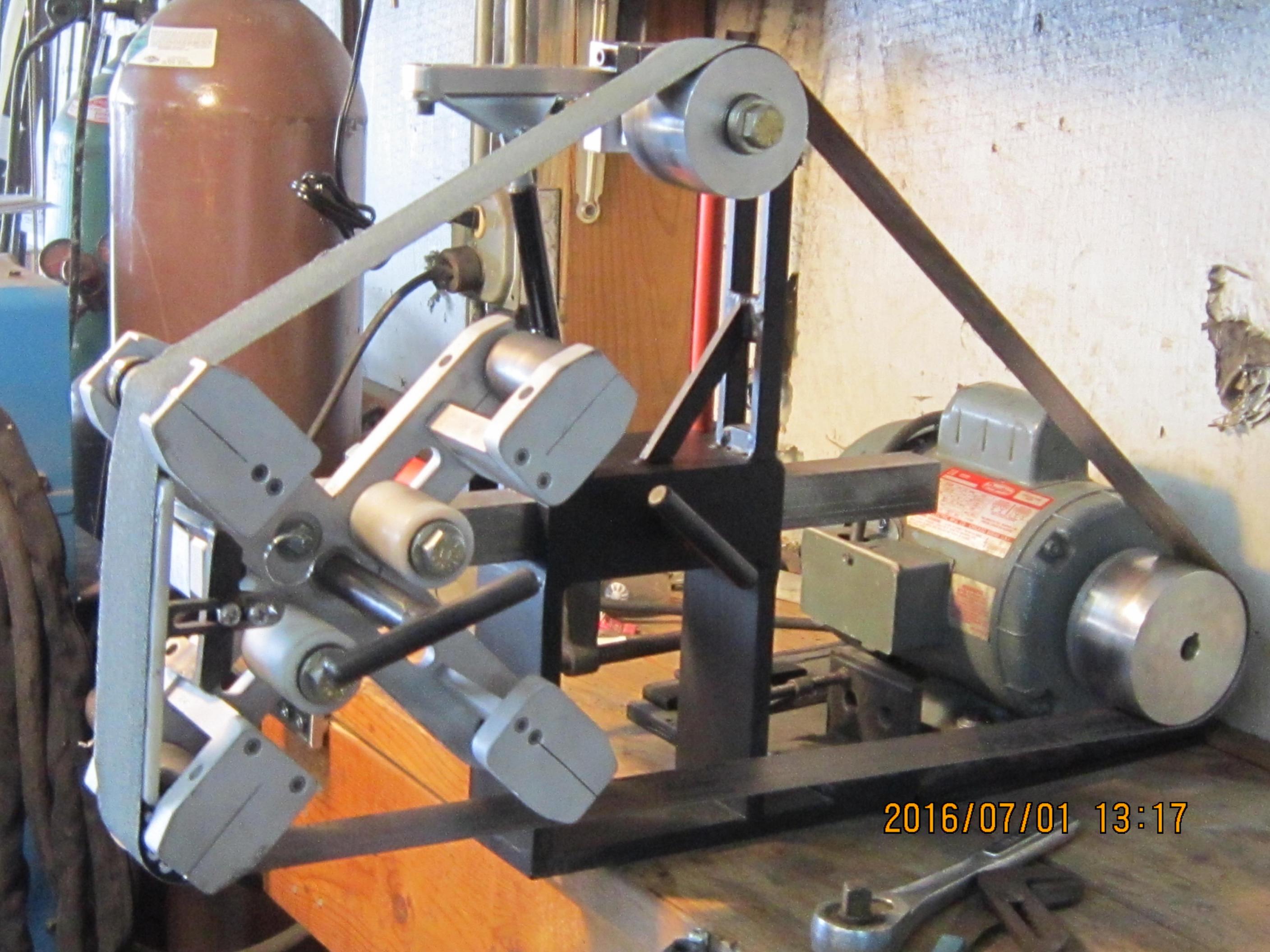

    I have several Belt grinders. I like them all equally as they each have their own purpose.Hello from Coastal Georgia-img_1089.jpgHello from Coastal Georgia-img_0834-1-.jpgHello from Coastal Georgia-img_1322.jpgHello from Coastal Georgia-img_1088.jpg
