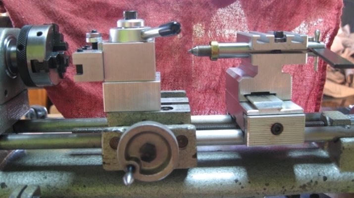

    Thanks for the welcome guys! My lathe is in working condition now. I installed a variable speed motor, a Harbor Freight chuck, a QCTP, and a Taig tailstock. It is quite versatile.
    I'm working on an indexer for the lathe. It will replace the nut on the drive pulley. It is made out of a platter from a hard drive and a Unimat face plate. I need to make another platter with a multiple of 6 holes, and tap the faceplate instead of using the nuts.
    The mill is also in running condition. I made a motor mount for it so I could use a sewing machine motor. The plan is to make a vertical feed for the thing using a Unimat feed screw.

    Ken,
    I too enjoy adding features and capabilities and features to my Unimat SL. I have published a few Unimat articles and photos on HomemadeTools but always looking for more on this subject from other members.
    How did you install the tailstock shown in the above photo? The sensitive drilling feed and adjustment for taper cutting is a great improvement. I am also interested in your milling head adaptation.

    wow....I loved your tool ... I feel inspired to build an equal ...

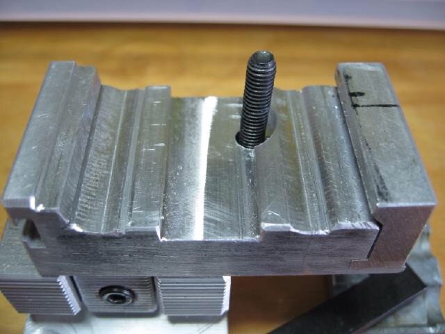

    Thanks guys! These little machines are my favorite toys.
    On the tailstock mounting, I used a Unimat lower plate and modified the bottom of the Taig tailstock to fit the Unimat ways.
    The motor for the milling head is mounted on a simple bracket made from a piece of rectangular tubing.
