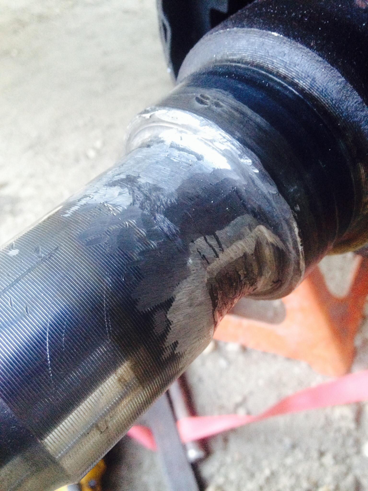

1 Attachment(s)
I'm trying to upload a photo.. But it's a bit tricky from this phone. Attachment 5632 this truck is an 08 dodge 1 ton dually.
So after seeing the picture and explanation provided by Chrishd - I can ask this question - why would you go to so much effort when there are literally hundreds of Dodge dually rear ends at your local Pick-n-Pull? You could spend your time and money replacing all the bearings and seals on an axle that has not been as badly damaged as yours and still be out the next weekend seeing if you can do it again.
I have a Chev with a dually 11,000 pound rear axle and every time I go there to find parts - the Dodge trucks out number the Chevys or Fords two to one. There should be plenty available in your area.
Basically because I'm cheap. Lol. And I can't afford to buy the housing. At least not right now. And so I'm on a time deadline. And this is an after work project for a friend and he is also cheap
OK thanks for the pic.looking at it Nixrox has a valid point. However you still have other possibly less expensive and time consuming options available to you that is"maybe". Because from what AI am seeing you also have seal area damage this could possibly be fixed with a micro sleeve though
One very easy thing to do would be to call around and ask for a damaged housing buy just a cut section from it as long as the cut was made on the tube far enough from where the spindle is welded on to allow you to chuck up the spindle and remove the tube keeping the 2inch long location boss of the spindle intact.
Next it would still be better to pull the whole diff out from under the truck just to make the repair that much more accessible and easier. With a good impact a couple of good jack stands a floor jack and an hour's time the rear end can be out from under the vehicle and on a pair of pipe stands ready for mutilation so to speak.
if you are good with a torch ad have a scarfing tip some call it a gouge or washing tip for your torch you can scarf off the weld and see the join line of the tube and spindle if you are careful you wont even damage the end of the tube. but if you do it is not the end of the world. After scarfing off the weld or removing it with a grinder if you want. you will need to remove the spindle from the tube. heat the tube all the way round enough that the spindle can be removed. a good 10 lb slide hammer is helpful here. clean up the weld area for both parts warm the tube again and tap the new spindle in place. getting it square is fairly easy with a few parallel bars and a couple of long straight edges and a vernier caliper.
weld it up as if your were going to try and pass a pipe weld test or cheat and roll it reassemble and job done.
another option would be same as above but build up the spindle and turn it back to size in a lathe.
In my opinion either of the solutions above would be faster than having to spend the time and expense to make the belt grinder apparatus I drew for you. Plus you would get a better job done doing it.
